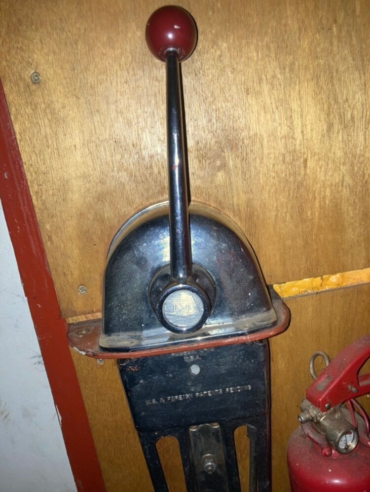

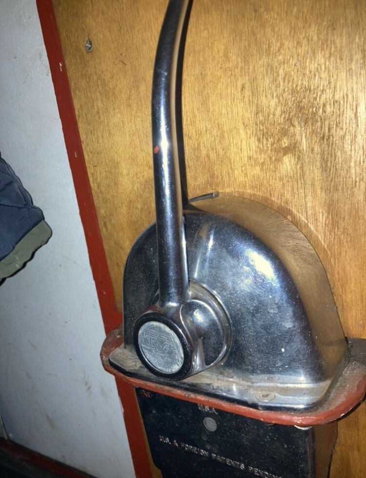

Here are some photos

Both of the batteries are fully encased so can’t get to them without taking them out of the box I think. yes that does sound a bit above my knowledge, I’ll have to rummage the internet to try and understand the system better! It sounds like I’ve also been undercharging severely if 3-4 hours is advised… with the rpm, that’s the rpm of my engine, I’m not sure how to change it without coming out of neutral, is that something I can do directly on the engine? thanks again for your help
