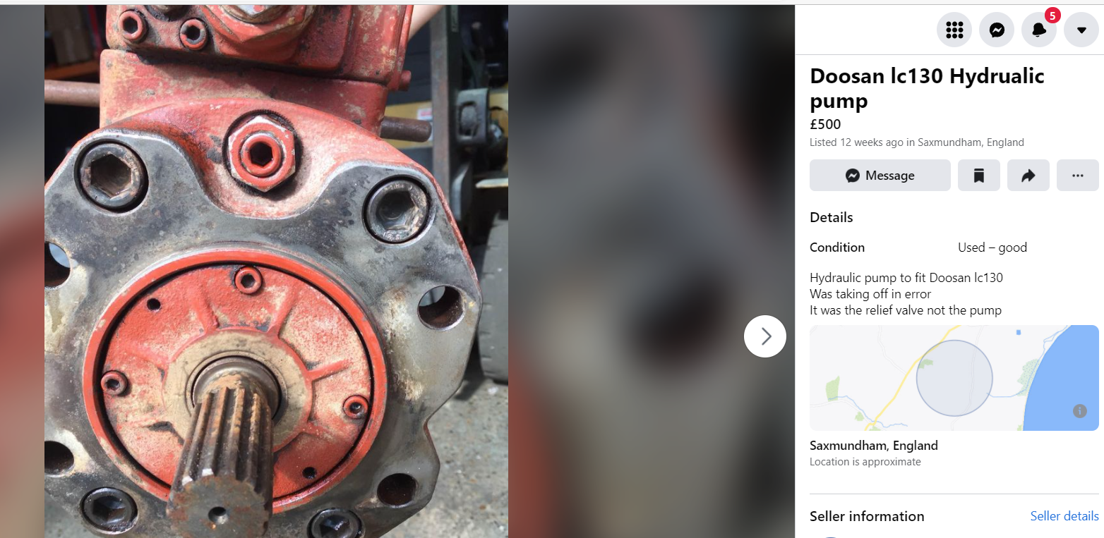

ditchcrawler Posted December 7, 2021 Report Posted December 7, 2021 1 hour ago, koukouvagia said: Just to add my RCR horror story. I am happy to do my own maintenance and running repairs, but I took out RCR when my son and daughter-in-law were using our motorised butty. They broke down at Braunston and the RCR engineer diagnosed a faulty injection pump because the engine would start and then cut out. To cut a very long story short, the RCR fitted an exchange pump but the problem persisted. In the end I said, "Forget it, we'll sort it out ourselves." Fortunately, we had the motor with us so we were able to tow the butty back to base. There a proper engineer, Ed Boden, correctly diagnosed and fixed, a blown cylinder head gasket. How about this for fault finding and repairs 1

koukouvagia Posted December 7, 2021 Report Posted December 7, 2021 55 minutes ago, ditchcrawler said: How about this for fault finding and repairs One of the disadvantages of having an hydraulic drive is that you really need specialists to deal with any problem. I've had excellent service from ARS diesels who were able to recommend a first class hydraulic engineer. He came with full diagnostic equipment and checked and serviced our set up when we needed help.
