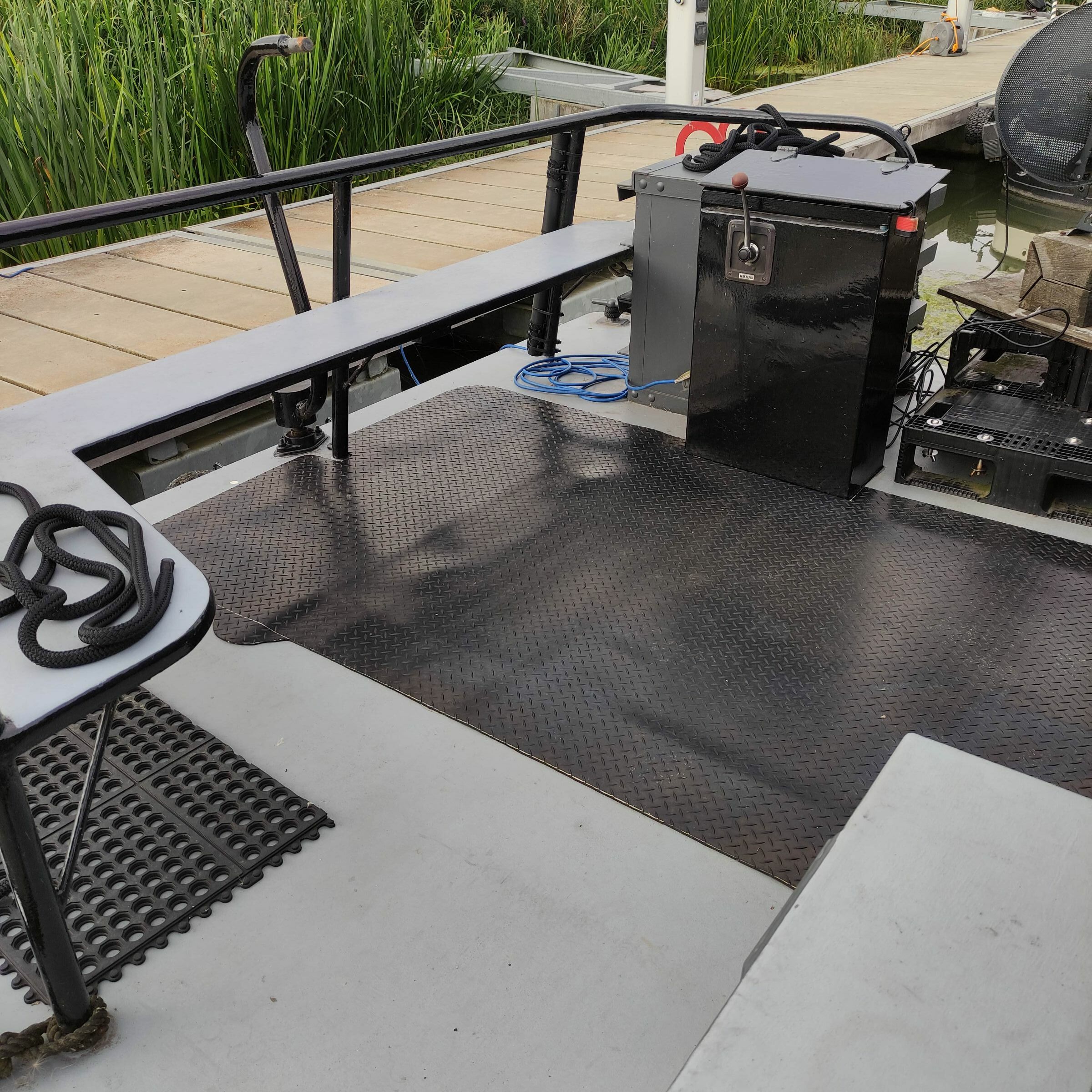

I have the same problem as the gutters on mine are undersized. They cope with most rain but not a downpour. I've just made a cover for my cruiser stern deckboards using 5mm thick checker plate pattern rubber sheet from Amazon. Seems to be working so far. I just roll it up and put it on the roof if I'm taking the boat out. I've oversized the matt by about 5" on 3 sides around the deckboards.
