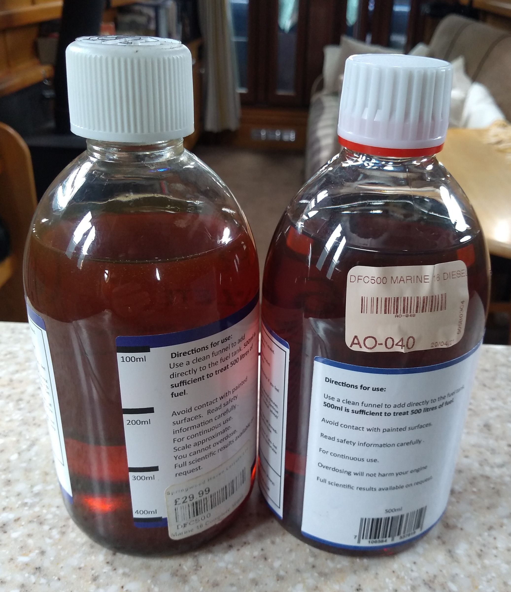

I agree that their labelling is a tad confusing. It would also be helpful if their containers had some form of scale on them. However it seems to work (I use Complete) Last week I sucked a good 5 litres out of the bottom of my tank with my Pela. Allowed to settle it was perfectly clear. I do this at least twice a year without fail. After having to change four filters in 24 hours in rough seas in the middle of the Bay of Biscay I'm paranoid where bug is concerned.
I buy the 500 ml bottles which treats 500 litres. Some bottles have a scale along the side, some don't.
To measure  that expensive treatment more accurately a small plastic  measuring fuel is very handy and very cheap.
However I more  often use a small plastic travel  shampoo bottle which holds 100mm  and have it  ready with the appropriate dose  to be tipped into the filler prior to the fresh fuel.
I'd forgotten how expensive it is. Still compared with a full tank of fuel it's not so bad and compared with a blocked fuel system it's positively a bargain.?
