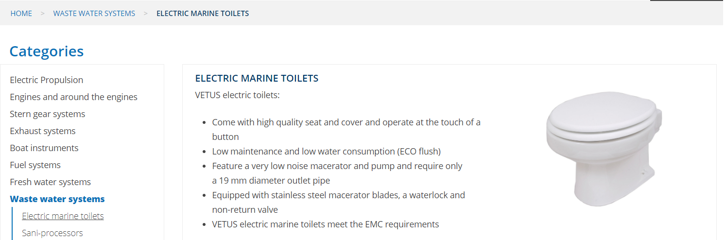

Hi thanks for answers, it’s a vetus vacu flush to remote tank with a macerator, I did ring a man who advised me not to poke things down the bowl in case I ruptured something, advised filling the bowl with water and leave for a few hours, which I have done, and tried a plunger but with no luck. So I will empty water out of bowl tomorrow, and poke a wooden stick down there tomorrow,maybe with some hot water first, if that’s the advice.

It would be very useful if the OP posts exactly what type of toilet he has, and if it is a vacuum system (which I doubt) to tell us if the vacuum pump is pumping when flushing.

Just to finish this subject off, the blockage was on the other side of the macerator, it was blocked in the elbow joint into the tank. It was calcified up,and had got blocked there.
 The joint from the hose ,from the macerator into holding tank is made at almost half the diameter of the hose from toilet.The calcification, decreased this further, and it was a problem waiting to happen.
Forward advice is to increase the diameter into the tank and accompanying elbow joint  pipe work.
I was amazed it was such a small bore into holding tank when the rest of system piping is twice the size.
But boat is 12 years old, I have had it for  5 years and not a problem before.
Thanks for previous answers, it was just a macerator, not a vacu flush.
