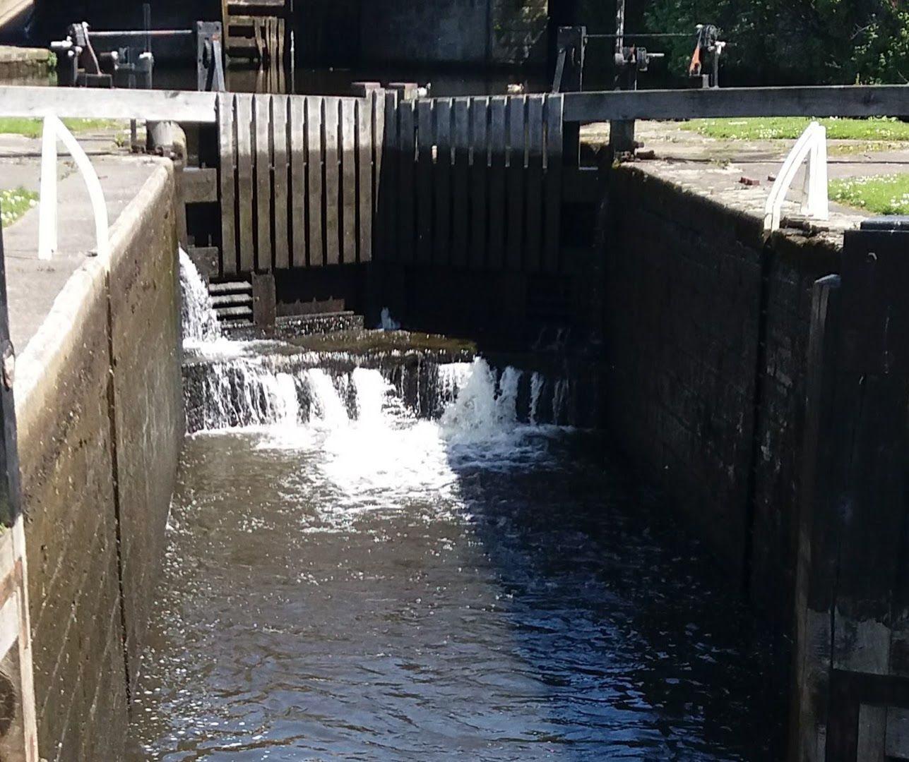

Our team have identified an issue with the cill lining at Lock 2, Hack Green, teams will be on site Wednesday 7 October to investigate a resolution.

When I came through on Thursday (and started this thread), CRT were obviously aware as they had a man there with a tirfor operating the top gate. I don't know how long they had been doing this. I guess they were hoping they could carry on like this until the stoppage season, although the man there told me it was getting worse by the day.

I took photos of the cill shortly before it blew as it was obvious it was going to and included them with the report.
Bang on, and to add to that the offside gate was not meeting the cill bar at the bottom due to the gates being misaligned and the mitres not meeting square on.

That's why I told them the cill had blown on the 15th September, and why 3 days later they were using a Tirfor to force the off side gate.

Assessed, ordering materials, now they are working out how to fix it. Timed passages continue as long as it holds out.
