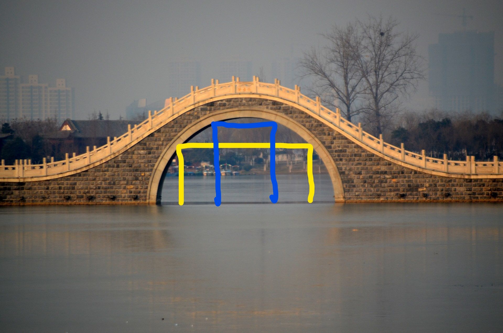

Before you go ahead, (assuming you will be dong some cruising) just check the available air-draft in your planned cruising grounds.
Adding a wheelhouse, the width and height of a 'fat-boat' can seriously affect your ability to get thru arched bridges.
(Arched bridges narrow with height)
A much higher Narrowboat can go thru a bridge than a widebeam.
Hopefully the picture is self-explanatory.

I completely agree but having had some experience you know what is possible, whilst someone new to the waterways may not give consideration to the width / height equation
Start with a 14' wide boat and adding another 4 or 5 feet to its air draft can have consequences.

Isn't that bridge in China? Is that likely to be in the OP's cruising range?
No, its on the Oxford - Look thru the arch - you can see all the widebeams and a solitary NB on the RH side
