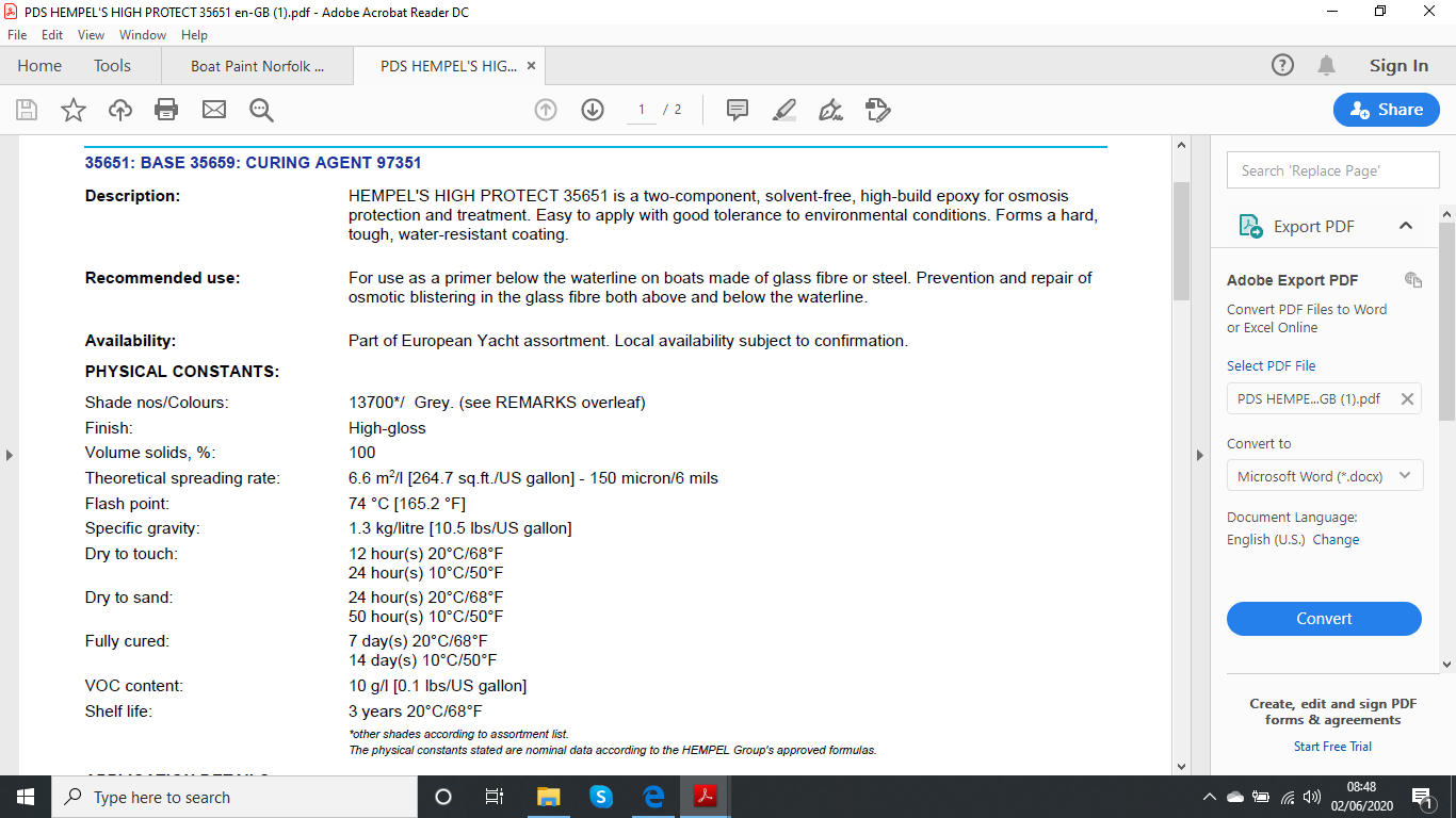

DHutch Posted June 2, 2020 Report Posted June 2, 2020 We use a two part-paint system on Emily Anne, from what was Leighs paints, now owned by Sherwin Williams, epoxy ali primer, and a acrylic urethane under and topcoat. The boat was shot blasted from new and treated with a two part blast primer within hours of the prep, because it was a new boat and one way to remove the mill scale. Some boats are made with pickled and oiled steel, but a lot are still not, in which case the scale needs to be removed, mechanically or by allowing it to rust off. While bright steel is a good starting surface for the right paint, unlike the suggestions above it it not the only way to start a two-part paint system, you can allow the steel to develop a light rust, which is otherwise clean is a great key, but it can also be applied over most existing paint systems as long as the surface is stable. One of the exceptions being a bitumen blacking type coating, which might be where the confusion has come from as often two-pack on narrowboats is used below the waterline where bitumen is another common product. There is more faff to applying a two pack, we put ours on with a decent grade 4 inch foam roller, cut in at the edges with a brush, and get a very nice uniform coating, if not polished enamel type finish. You can do it on your own, but at very lease for the finishing coat if painting outside in summer its good have someone mixing it 1 litre at a time and supplying it fairly continuously so you can maintain a good wet-edge. You struggle to apply it in this currently unseasonal heat too, but that would go for almost any paint system. I used Dulux Trade 'Metalshield' on the boom and dipper of my digger five years ago based on success with there trade 'Weathershield' woodwork paint on window frames etc and sadly would not use it again. The zinc phosphate primer was a total pig to put on, and the gloss topcoat (red) has chalked very quickly and some areas of rust have come through again as well. I got a better finish and durability with Blackfriars QD90 which was cheaper and easier to apply. I then did the rest of the outside of the machine top coat with a cheap brandless 'quick dry enamel' from the local agricultural supplies place because QD90 wasn't the right share of red. Despite designed being design for spraying went on fine with a brush and looks better than the Dulux. Daniel
frances doherty Posted June 2, 2020 Author Report Posted June 2, 2020 Thank you Daniel... Thats exactly what I was looking for... And a good tip about the metalshield. I think I will probably go for another recommended primer to use with the dulux under/top coat. Maybe I'll try the two part next time if I get a chance to grit blast then... I can't do it this time as I'm in a boat yard without those facilities. I know the dulux Weathershield will be OK as many boaters seem to be really pleased with it... But you're the first person who has experience with the metalshield.
