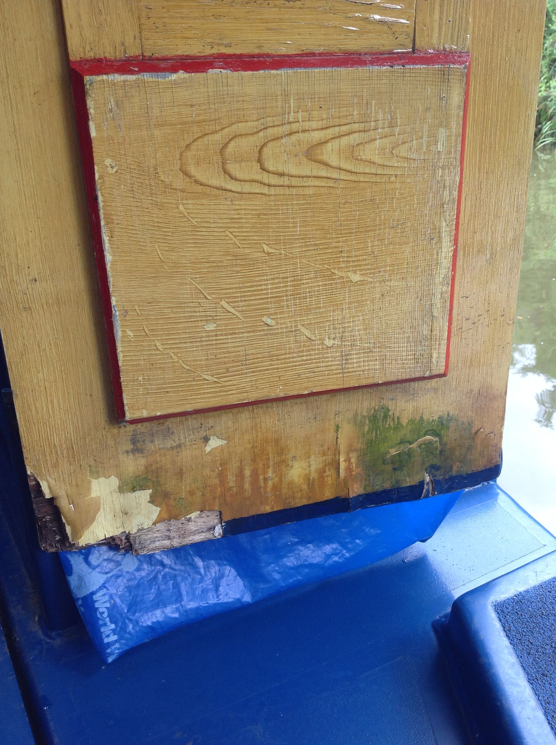

Leemc Posted August 5, 2020 Report Posted August 5, 2020 Hi all, sorry to tag on to this thread but same has happened to ours. can you get complete inserts made up and how much would this kind of job cost? cheers

Leemc Posted August 5, 2020 Report Posted August 5, 2020 Thanks. Will have a close look and see if able to remove old insert
WotEver Posted August 5, 2020 Report Posted August 5, 2020 13 hours ago, Leemc said: Thanks. Will have a close look and see if able to remove old insert Look for tiny screws covered in paint along the edges of the doors.

Leemc Posted August 6, 2020 Report Posted August 6, 2020 1 hour ago, WotEver said: I quickly made new rear door inserts from MDF (not MRMDF) on WotEver because it was all I had to hand. They rotted within a year because of the moisture trapped above the bottom return. I then remade them out of Ash when I had a bit more time. Just had a look and they're not actually inserts, rather a stuck on piece(ash maybe). The rest of the doors appear to be in good(ish) condition. Is cutting off the rot at the bottom an option?
Leemc Posted August 6, 2020 Report Posted August 6, 2020 Its not a massive issue, but obviously going to get worse. I quite like the doors as a whole and have been well made and would expensive to replicate if I could find anyone to do it.
WotEver Posted August 6, 2020 Report Posted August 6, 2020 7 hours ago, Leemc said: Is cutting off the rot at the bottom an option? Sure. Anything is possible A multitool would be good to chop it off. It looks like ply to me from those photos, so the rot may well have migrated upwards.
