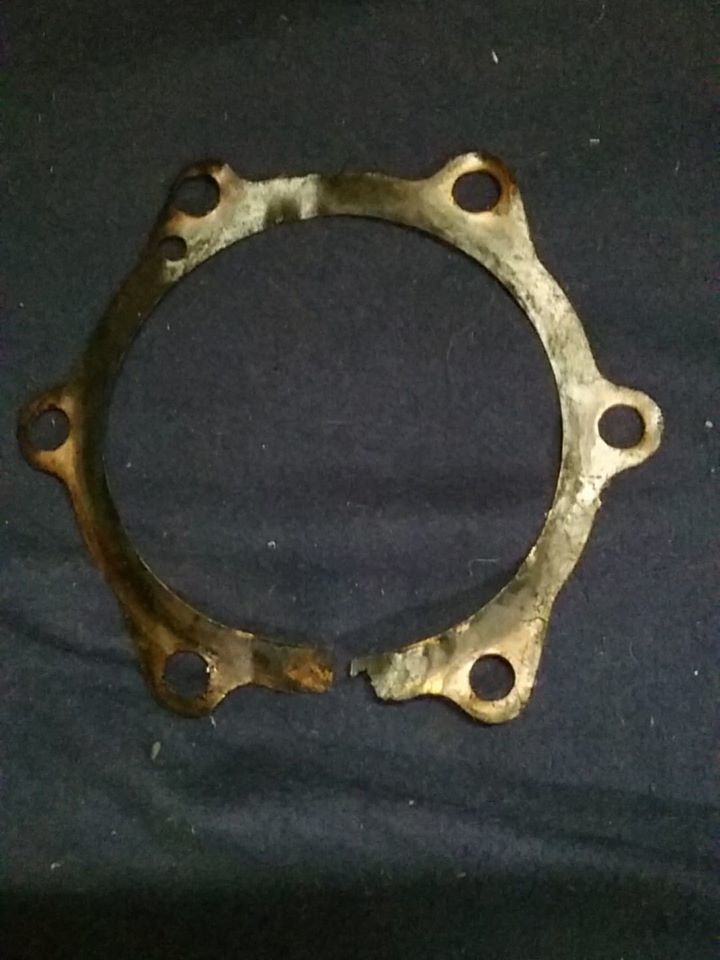

alan_fincher Posted February 6, 2020 Report Share Posted February 6, 2020 From a picture posted elsewhere I'm guessing that at least ne of the AS2s mentioned above may need a little TLC at the moment... Link to comment Share on other sites More sharing options...
paddy r Posted February 6, 2020 Report Share Posted February 6, 2020 1 hour ago, alan_fincher said: From a picture posted elsewhere I'm guessing that at least ne of the AS2s mentioned above may need a little TLC at the moment... all fixed now. Link to comment Share on other sites More sharing options...
alan_fincher Posted February 6, 2020 Report Share Posted February 6, 2020 37 minutes ago, paddy r said: all fixed now. Excellent and well done! Link to comment Share on other sites More sharing options...

Hyperion 53 Posted February 7, 2020 Report Share Posted February 7, 2020 It was Jack Taylor (of the new ACCCo) that nicknamed the AS2's "tata roasters" from when he had the 'Hyperion'. Him and Elsie reckoned they used to wrap potatoes in foil and cook them on the manifold when loaded. There's nothing wrong with an Armstrong with the correct blade. On the Shroppie with a loaded boat: after coming round Cut End and through the stop, the exhaust manifold should be glowing red by the time you get to Chillington - else your hanging about! Jack was a great chap and told a good story whilst propping the bar up in the Dashers at Knighton or eating an ice cream here at Norbury... He told me many times that he used to drain the oil out the sump in cold weather, boil it up on the range, pour it back in and then Elsie used to be pressing the button and he swung on the handle to get the old girl going on a cold morning. An easier trick is to put a parrafin greenhouse heater under the sump during the night and a well set up engine will start the first time in the morning. Mind you, I don't think the BSS examiner would approve! Link to comment Share on other sites More sharing options...
Hyperion 53 Posted February 7, 2020 Report Share Posted February 7, 2020 On 06/02/2020 at 17:39, paddy r said: all fixed now. I had some copper "rings" made for my engine in Hyperion, thinner than the manual says and to Tim Leech's specification. Increased compression and made starting a whole lot easier and instantly solved the smoke issue. I have some spares hanging up in the workshop somewhere! Link to comment Share on other sites More sharing options...
paddy r Posted February 9, 2020 Report Share Posted February 9, 2020 On 07/02/2020 at 22:42, Hyperion 53 said: I had some copper "rings" made for my engine in Hyperion, thinner than the manual says and to Tim Leech's specification. Increased compression and made starting a whole lot easier and instantly solved the smoke issue. I have some spares hanging up in the workshop somewhere! i had some copper rings that i found in the engine room, probably left over from Ivor, they had a small recess for the dowel in the barrel top, I've used these and it's running well. Link to comment Share on other sites More sharing options...
