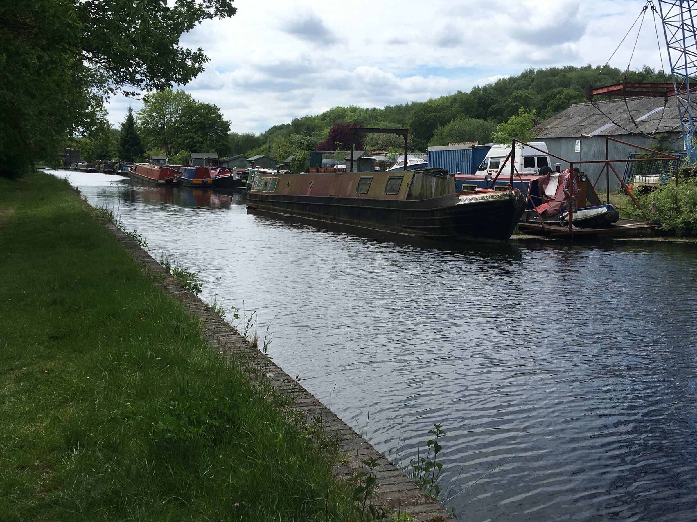

Photo from earlier this year (from this post)
  • Sad 1
In case anyone was wondering: yes, the steel gunnels were welded directly on the old angle (which the wooden ones are normally bolted through), but the deck beam was fabricated at the original height of the wood - carried out at short notice by Braunston Boats in the spring of 1984 - hence the rather abrupt upsweep starting just forward of the conversion cabin. They originally had a 2" upstand at 45° on the inside edge which the battens holding the sidecloths were bolted through, the topcloths were roped to steel rings welded to bits of channel trapped under the sidecloth battens.
