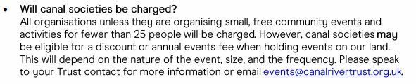

Just been having a read of the info on CaRT, From the rate card :- Fee per head is calculated on the maximum event capacity not the attendance. There is a 50% discount if the Trust's land is not where most of the event will take place. From the FAQs:- Rate card https://canalrivertrust.org.uk/refresh/media/original/47755-rate-card.pdf FAQs https://canalrivertrust.org.uk/refresh/media/original/47756-tpe-faqs.pdf springy

My Reading of this :- Everyone - any organised canalside gathering of more than 25 people, so all of the boat gatherings big (at more cost) or small, all of the societies gatherings, just about anyone they can get money from. Thinking locally - bumble hole, stourbridge, tipton, brownhills, titford, gatherings. Maybe even "organised cruises" such as BCNS Explorer or even the Challenge. Edited to add Cropredy, and that would definitely class as large scale and commercial ! springy
