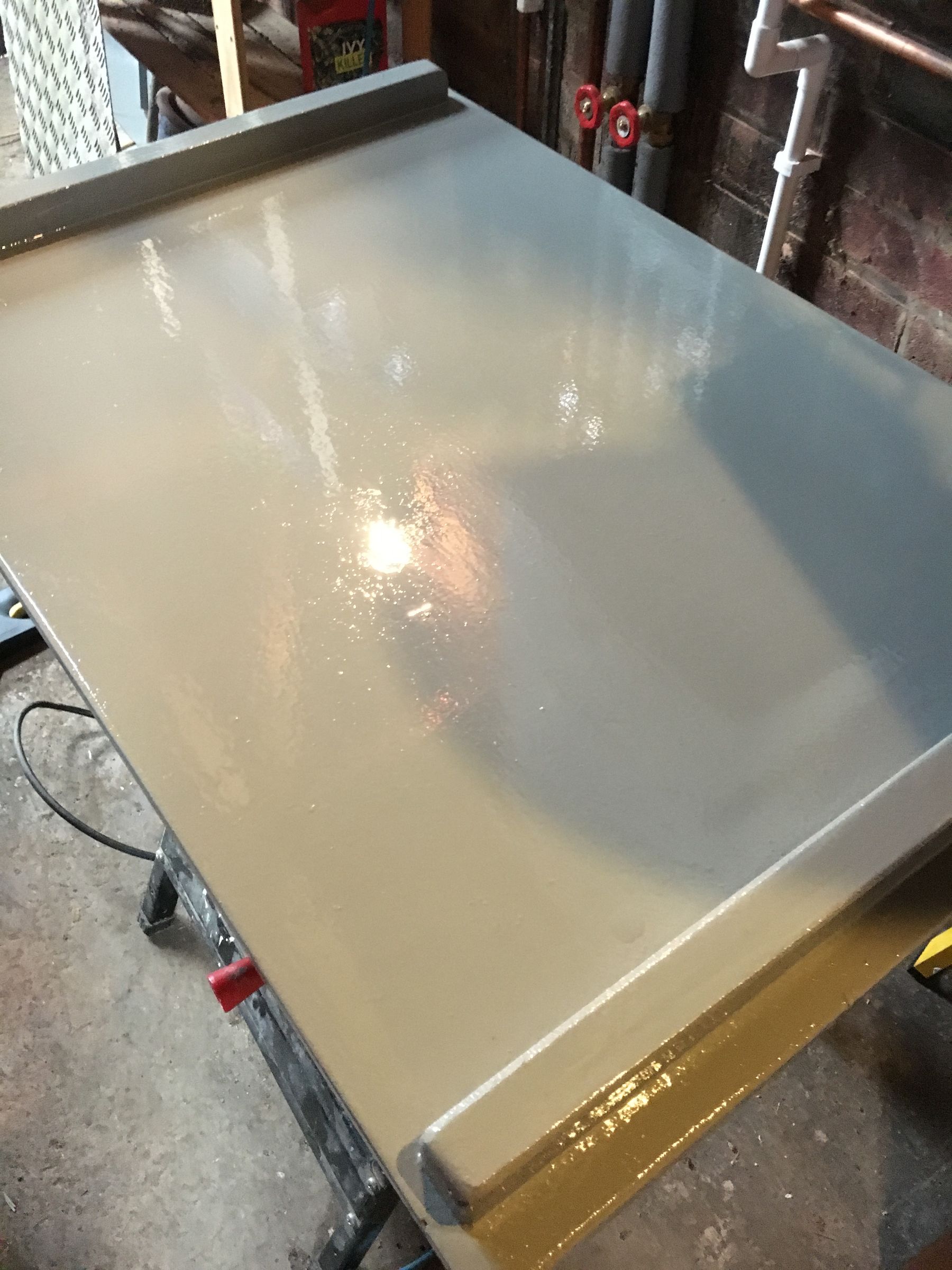

I've just been through the joy of replacing deck boards. I'd thought the deck boards were getting spongy. While I was stripping the alu plate off the top, I put my hand straight through it! Could have been nasty if I'd ended up in the engine hole while cruising along... New boards - I invested in proper marine ply ( about £90 a sheet). Then went for the west system giving them 2 coats of epoxy, followed by 2 coats of danboline bilge paint. If these rot I shall be fairly fed up!

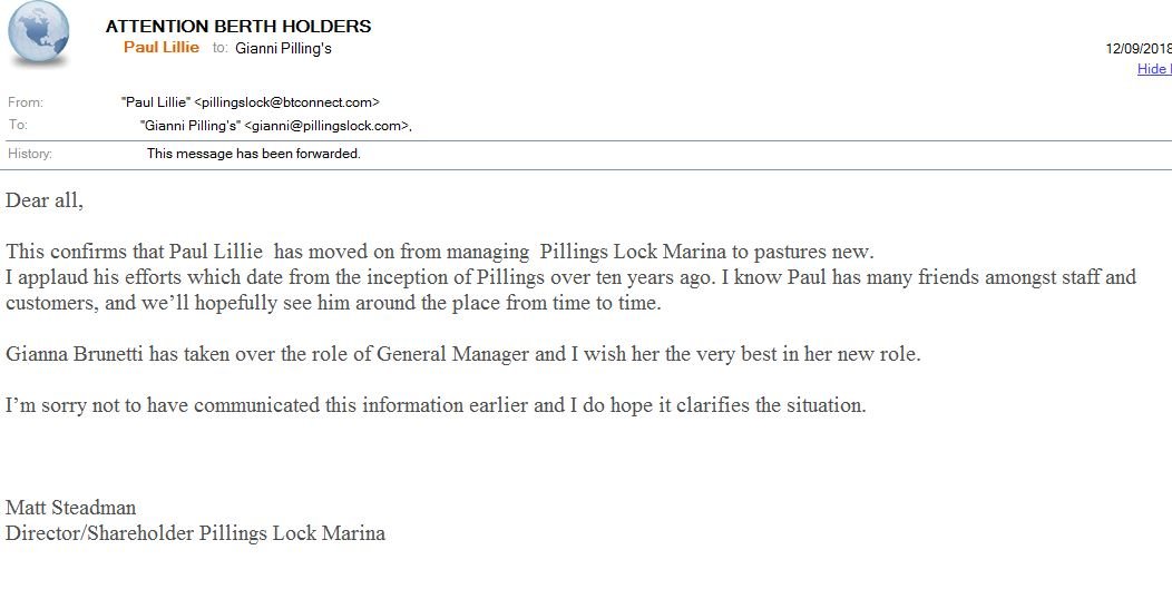

Emailing system has always been very mysterious there. Sending an email to Gianna, sends it out to all moorers for example. Never had any idea who was sending the mails out in reality as all seemed to have access to each others accounts. Gianna was running the café - been there a while, but big step up to running the whole place.
