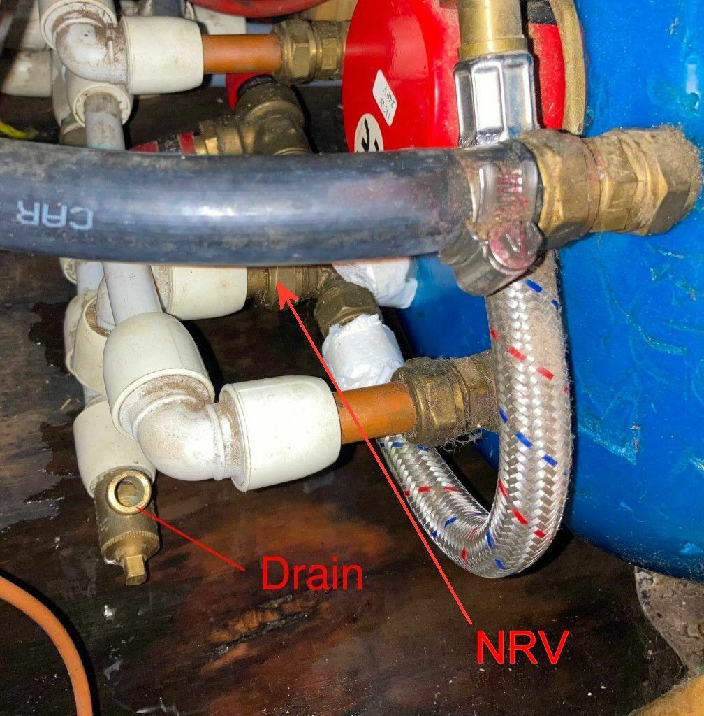

As said above, the pump is starved. Most pumps will pump air, so 1. Turn the pump off. 2. Turn off the water feed from the holding tank at the stop cock. 3. Open all the taps, hot and cold. 4. Undo the pipe somewhere between the stop cock and the pump. Have a rag ready as a little water will leak. 5. Turn the pump on, it should now suck in air and blow this through the pipes. The problem can be emptying the calorifier as the hot water outlet is at the top. On my horizontal one, when the pump is running on air as per step 5, 6. Close all the taps and the calorifier pressures up. 7. Release the pressure relief valve (PRV) by turning the red knob, the air pressure in the top of the calorifier will blow the water out of the bottom. 8. Close the PRV and repeat step 7 until air blows out. 9. Turn off the pump, reconnect the water feed pipe and open the taps. 10. Disconnect the heating water coils and 230V immersion cable as required.
This looks like a Surecal calorifier, just be aware that the often have a built in non return valve (NRV) in the brass manifold fitting as shown below which stops them draining out, although the who installed yours may have removed it given a drain has been added. I added a drain like that on my previous boat and had to remove the NRV, adding an in line one in the cold supply pipe the other side of the drain.

As that looks like a Surecal calorifier, the non return valve is integral in the manifold arrangement so Surecal recommend putting the expansion vessel on the warm outlet pipe. This prevents the dripping of the PRV but is not the ideal location.
