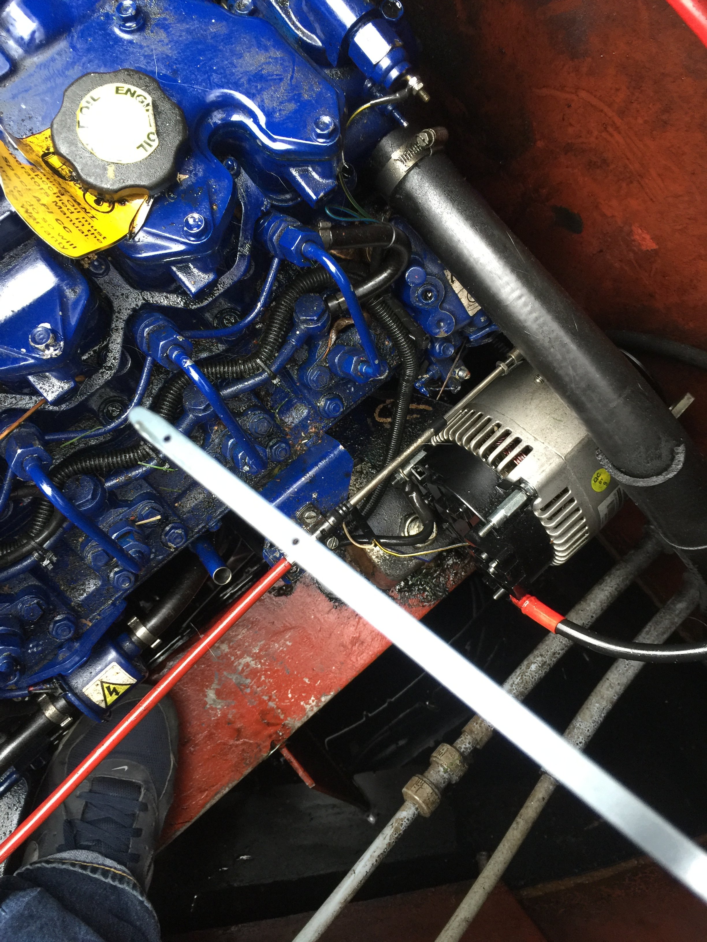

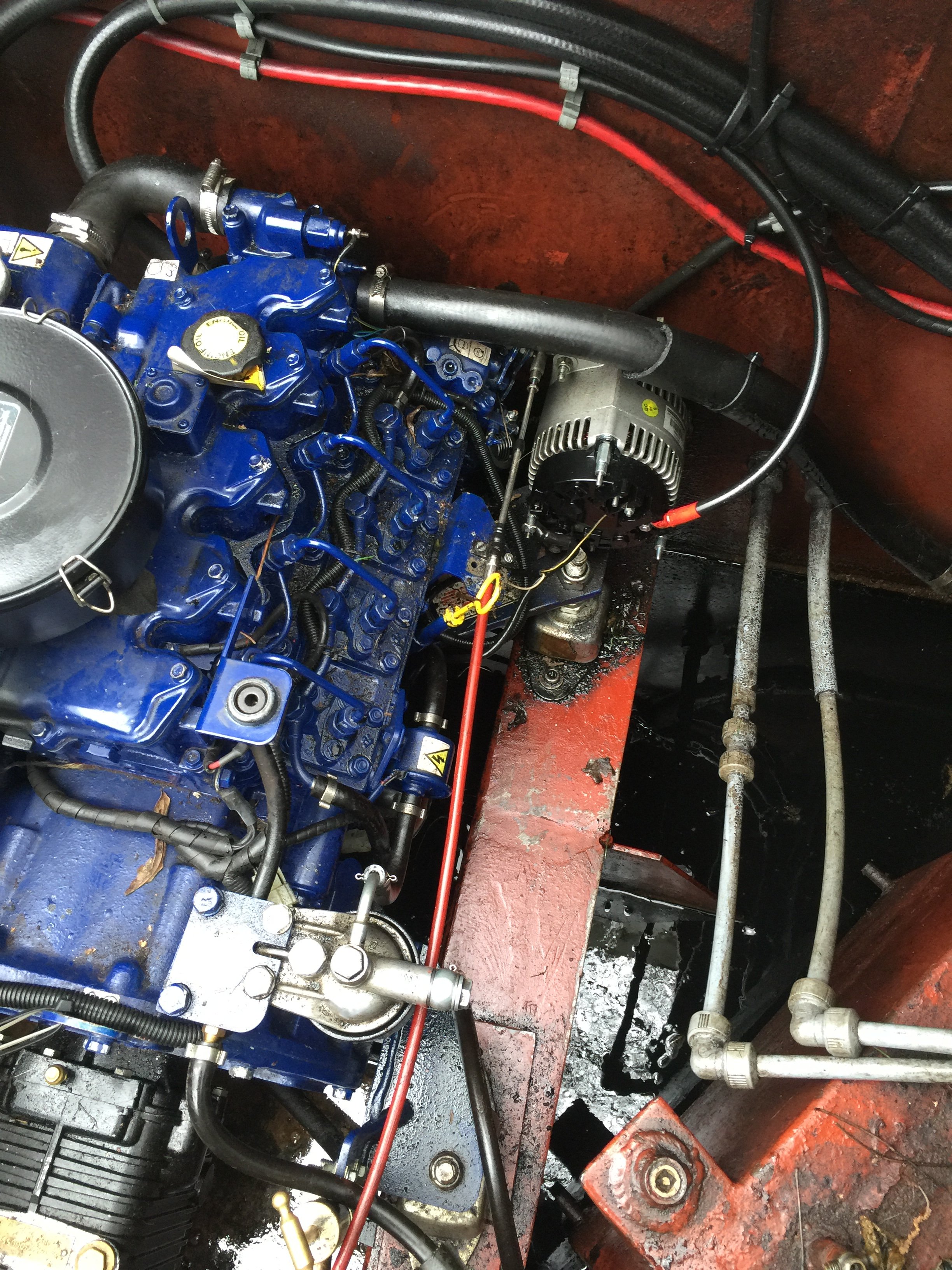

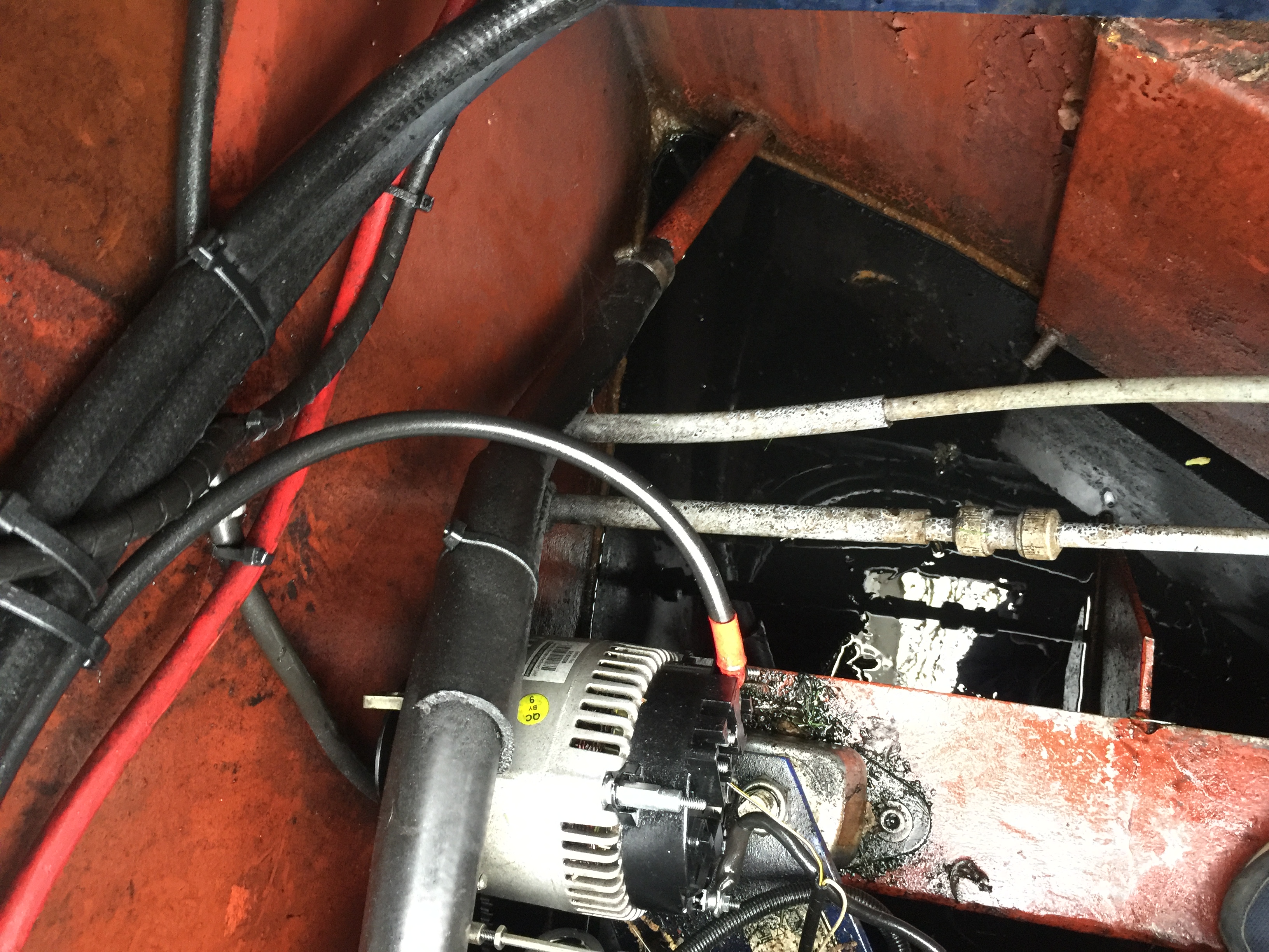

Good morning. Last night I came home and my wife was running the engine, she told me there's a funny sound. It wasn't funny it was terrible. She didn't turn the engine off and kept running it ( big mistake I know).  This morning I've lifted the boards to find a long pin had come out and oil from the engine is spiller out all over the place.
I have put the screw back in tight. And checked the oil dip stick and its bone dri
please see pics below

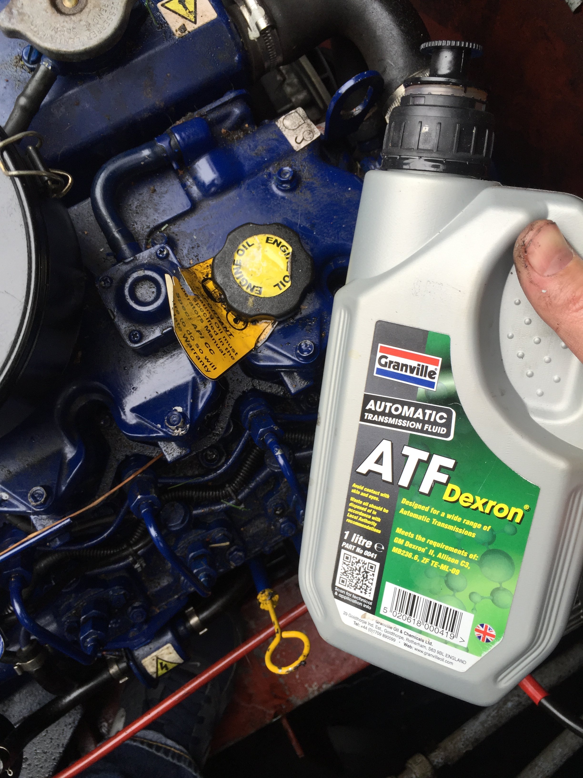

1) is this the correct fluid to put in where the oil engine cap is

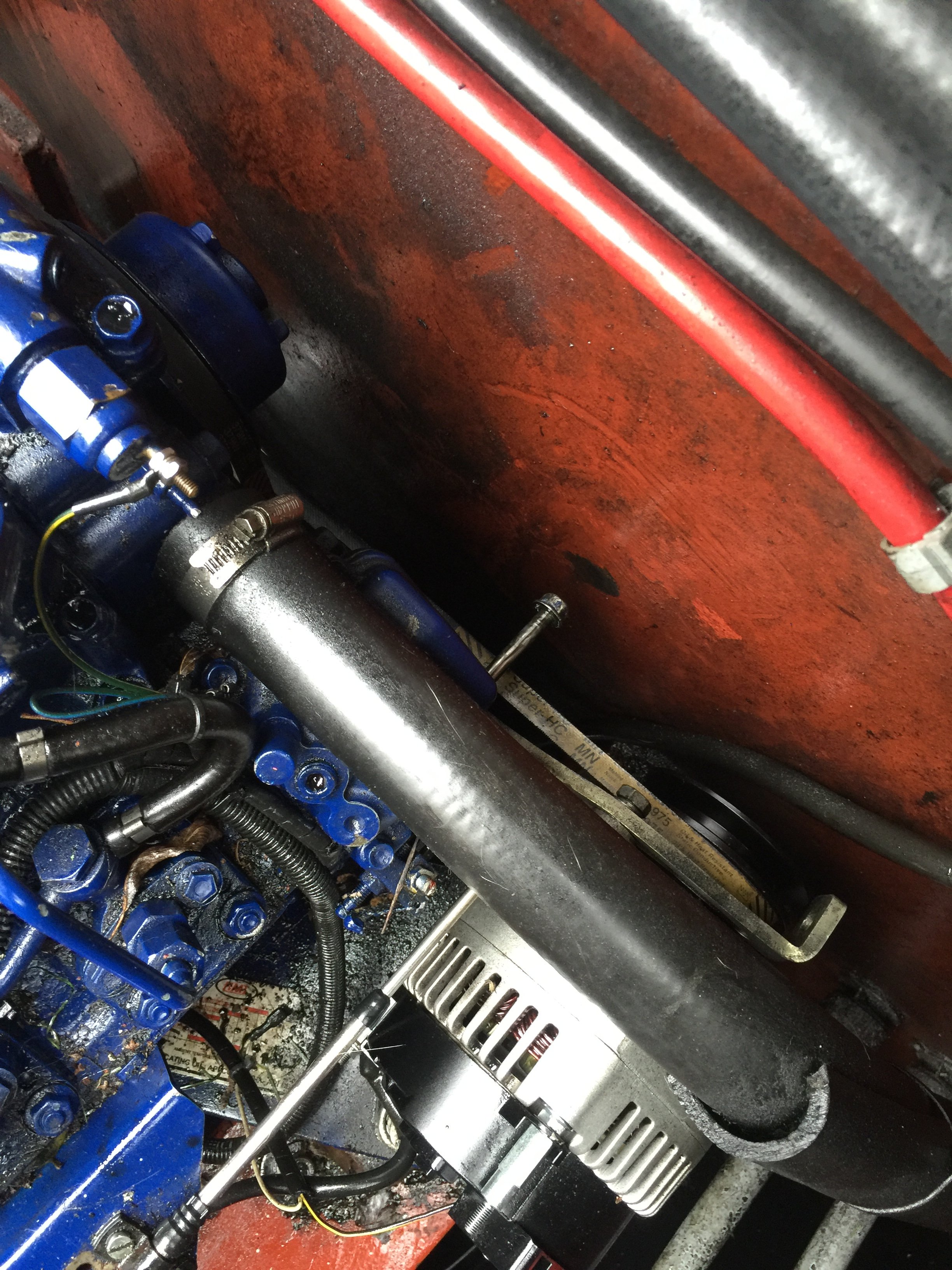

you can see in pic 2 the pin that was loose making the terrible sound
It will more than likely be 15/40 as it looks like a modern beta or somett. I cant see the pole thing you mean that you tightened up? You may have got away without terminal damage as often even when no oil on dipstick there is sufficient in the engine for it to survive but that will depend on the source of " The noise "

Forget the gearbox for now!! Get engine oil and DONT overfill it. If thats a modern usual set up you may well find the gearbox oil is the same as the engine oil but GET SOMEONE to have a look or you will have just spent thousands :o
The 'pin' is a bolt that (probably) holds part of the timing case on and it was rattling against the alternator - so it needs tightening up.
It's possible that the engine is damaged - but as other have said while I type get some engine oil  '15/40' is the most popular type and you'll need at least 5 litres and possibly more.

It will be 15/40 mineral oil.

Might be worth working out how the oil came out before you put more in.
