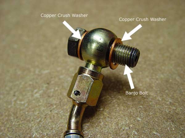

Scholar Gypsy Posted May 22, 2017 Report Posted May 22, 2017 Very good. On my diesel engine course the instructor said that fuel filters would leak if they were overtightened or undertightened. In response to the obvious question the answer is "experience". The advantage of an electric fuel pump (which I have) is that you don't need to fill the filters with diesel before assembling them. I just run the pump for about 30 seconds and it fills the pre-filter and the engine filter, pushing air out through the top of the latter. I sometimes need to crack the banjo joint on the high pressure pump for a second or two, once the engine has started and is threatening to conk out, but it sounds you were lucky!
Johny London Posted May 23, 2017 Author Report Posted May 23, 2017 No idea what a banjo thing is. Anyway - upon inspection today, there seems to be a small weep from the hex nut bung plug under the engine filter (I wiped dry and will check again later). Will try nipping up the nut but my feeling is that I will need to undo it and replace whatever the seal is - pity the filters don't come with the necessary. Not sure if the nut thing and seal can be purchased as an assembly, or if I just need another seal, or what any of it is called. I don't know the size/shape of the seal, so it's a bit of a pain really but at least I have a procedure now.

mross Posted May 23, 2017 Report Posted May 23, 2017 (edited) 2 hours ago, Johny London said: No idea what a banjo thing is. So-called because of the shape. Often used on fuel pipe connections. Edited May 23, 2017 by mross
