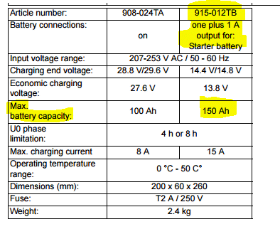

I have a WAECO PerfectCharge IU1512, I believe it to be Model No 915-012TB I have been running three 110amp leisure batteries from it for years - one of those used as the starter battery.
I am going to replace the batteries and will be fitting 130amp or 140amp x three. I'm trying to ascertain if this model is powerful enough to do the job.
I emailed an agent for WAECO as can't contact them directly. They replied with this. So I'm guessing their answer is it won't do the job. If that's the case, it's strange how I've ran three 110amp batts off this for years, granted, one was the starter battery. So I'm guessing I'll need a more powerful battery charger??
At 15a charging current it is a 'bit small', but as long as you take less than 15a 'out' then it will eventually fully charge the battery bank (it may take several weeks)
You could probably do 'better' if you sold it and got a 60-70A charger, it all depends on how much cruising you do, how much time on 'landline' and how much electricity you use.
We used to keep our 2x 110a batteries charged with a 4a charger - no problems and it kept the batteries in a better condition than trying to 'ram 100s of amps' into them.
Currently have a 60a charger keeping 'on top' of 6x 230Ah batteries - again - no problems.
Yes not enough charge current to offer sensible re-charge times.
Would suggest a 50 amp multi-stage charger for your proposed configuration. Remember also you will likely need a little extra in reserve to cover drain on your DC system whilst batteries are being charged.

Alan, thank you. It served very well feeding the three 110amps, but feel it may struggle on the higher amps. Most time spent in the marine, but next summer want to spend as much time as poss out of it. Also will add 600w of solar at some point.
Yes not enough charge current to offer sensible re-charge times. Would suggest a 50 amp multi-stage charger for your proposed configuration.

From your first post table, you will notice that they are using the 'ten percent' rule guide, that is that the charger should be 10% of the battery bank capacity.
Now await the incoming laugh.png , there is also a guide that 15% is OK
So for a bank of 140 amp.hrs a charger of 42 amp or 63 amps would be OK.
Personally I run a 390 amp.hr bank and have 80 amp.alternator and a 50 amp charger (three stage)
Never seen 80 amps from the alternator, cannot run it fast enough and the charger only hits 50 amps for a fairly short time, depending on SOC of the bank.
There is also a guide that says that 5% is ok too. It'll just take longer, treat your batteries more gently, and give a longer battery life.
