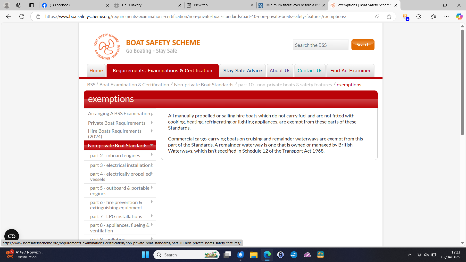

2 minutes ago, ditchcrawler said:
In that state of fit out it could be exempt from a BSS altogether
