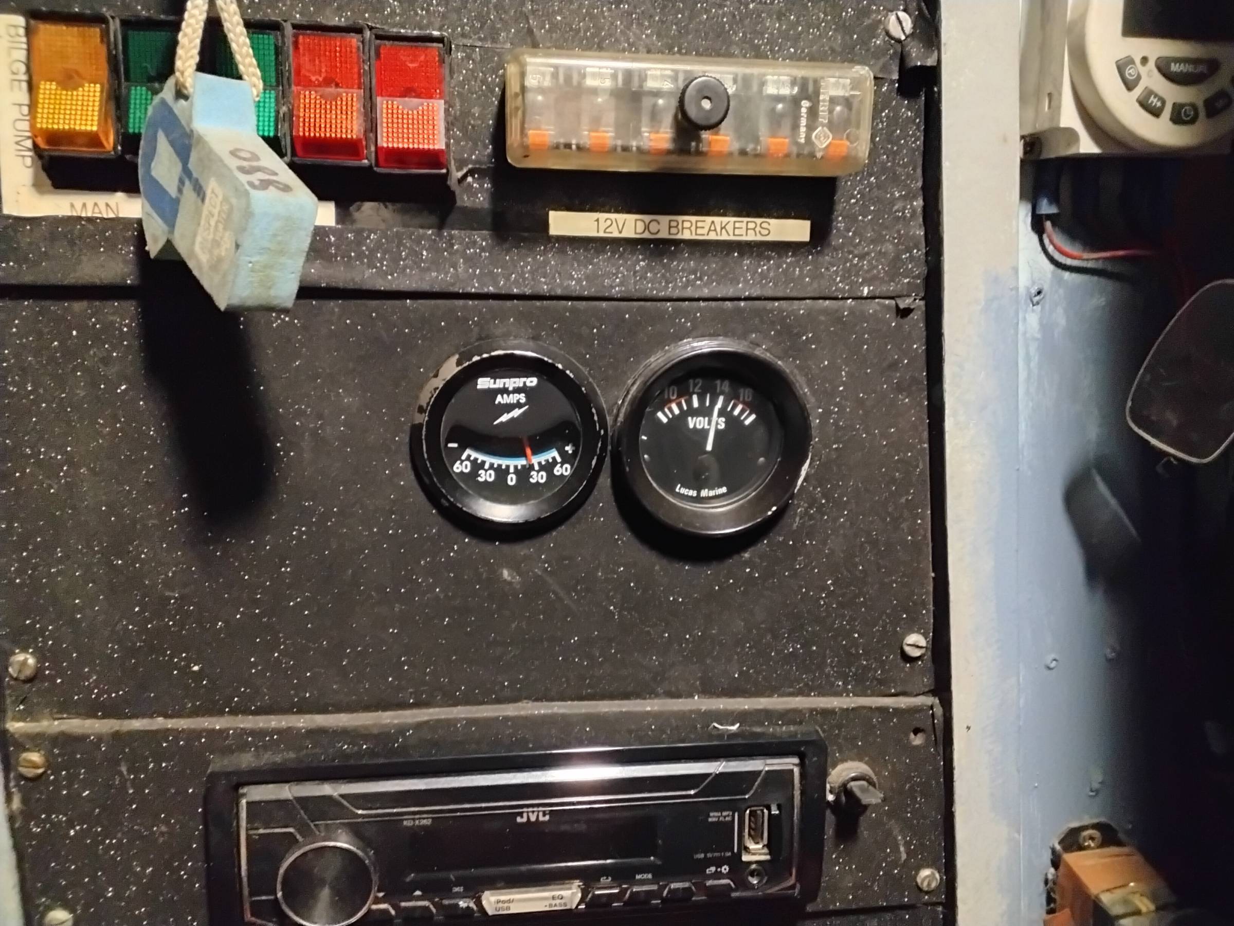

Yes, I am currently running the engine an hour per day, i upped this to four hours when it dipped, but not four hours every day.
There is an ammeter at the stern which  starts at minus 30 amps, (the arm swings to the right) which could well be what I use every day, ive rarely seen this at minus 50, obviously kept the engine running till i got back to normal. I am being a minimalist at the moment.
It takes about an hour to move to minus 5 amps, I could let it run for another three hours and I think it will come down to about minus 2.5.
This is ananalogue ammeter.
There are probably five batteries on board, one will be the starter, so probably not monitored.
I will be visiting a boatyard for diesel, and will ask if I can charge overnight, at least that would get me back on track.
The LED meter at the bow usually shows 12.2 or even 12.4 first thing in the morning, it is currently 12.5, (18.00hours), next to no solar today.

Maybe post a photo of this ammeter because minus 30 amps seems a weird reading to me unless you were using a fair amount of electricity from the batteries. It sounds weird, if it is a simple ammeter, then it should jump from negative to positive as soon as you start and run the engine. I would expect it to jump to 50 amps plus for a short while.  wonder of it is an Amp Hour counter, that could act as you describe.

Oops, its a Sunpro amps and when I thought it was negative, it's actually the positive side, there is also a voltmeter,  which is showing 13.65 apprxx, engine is now running.
As long as the engine was revving at around 1200 rpm then 13.65 volts suggests a very high charging current, but 30 amps is not that high, so I am wondering about the alternator or the wiring.

Im trying to get my head round the amp meter, but at least the voltage on that voltmeter seems OK.
Everything seems to be working.
I expect that ammeter is a very simple moving iron meter where the whole current is flowing through it. They are often supplied with undersized cable for marine domestic alternators, that does nothing to help charging. Exactly what it is telling you depends upon where and how it is connected, so can't help with what it should say and what it is telling you.
FWIW, as far as I am concerned your whole battery setup is mad, but I have told you that before, when you had the previous battery problems.
After many hours of engine charging at about 1000 to 1200 rpm the voltmeter should read between about 14.2 and 14.4V, and the ammeter should inly show a very few amps and that reading should have stopepd dropping over half an hour or so. Then the batteries will be as fully charged as they can be.

I think your ammeter is connected to show alternator --> Bow thruster battery current (except its wired backwards, so negative values are current going in). Since this is only one "half" of what is going into and coming out of the batteries (and might be less than that - where is the solar connected) its somewhat meaningless in itself.

Err, well, the 13.65, is at the rear, where the alternator is charging, its a 70 amp? Charger, so sized for the 33hp engine, I suppose. But it's been like that for 25 years, so I think it's OK
The voltage on the analogue meter is creeping up towards 14, so charging is taking place, that's probably an extra 40mins today, and I think it needs the same tomorrow.
I'm not sure what you mean 13.65 is the charging voltage, I am reading the rear analogue voltmeter, and I assume this is telling me the batteries are  at 13.65, Now after 40 mins , probably 13.85. I kinda thought that batteries should be charged to that sort of level, or more, say 14.2?
I am only reading the voltage at the rear voltmeter, there is an LED meter at the bow.
I know they are running a 12v system, but that's on the output side.?
I will need to charge longer tomorrow, till I get better data.
I had an idea that my agm batteries would be happy at a lower voltage than lead acid, , but now I'm beginning to doubt that idea.

50 minutes ago, Wanderer Vagabond said:
Do you let your batteries go down to 50% SoC? Generally I don't let mine go below about 83% and that only happens when travelling and (obviously) running the engine whilst the washing machine is heating up. My SoC meter isn't that reliable however, I assume that the batteries are fully charged when the ammeter gives a charging rate of 9 amps or below. Like I said I'm no battery expert but this strategy did mean that my last bank of AGM batteries lasted for 7 years.
I think I'm kind of with Tony on this one, having two domestic battery banks does sound a bit weird. The original front battery bank were obviously to power the now removed bow thruster and would have only had very intermittent use so would have stayed fully charged most of the time (despite the 57' charging cable). To now be running half of the boat electrics on them seems, to me, a bit
There's not much I can do about the basic wiring,  if I have to replace the bow batteries, so be it, easier than re wiring the whole boat !
You would not have to rewire the whole boat, providing the present charging cables are large enough to feed the main current user at the front, the fridge plus a little extra. Bypass any charge splitter for the bow batteries. Change the bow batteries for a couple of bus bars and add the new batteries to the bank at the stern. All cables should already be suitably fused, but can't be sure.
I agree that changing the batteries to LPF is not so simple.
Very unlikely I'll go down that route, the last guy I had on board  said it would take him an hour to identify what was happening at the moment, me, I just turn off each isolator  (plenty to choose from) in turn to find out what's happening. There is a diagram somewhere but I've never been asked about that.
The first so called electrician was charged with replacing all the batteries but got it wrong  I later identified yet another one still connected, by the smell , it was obviously still connected!
Wiring from the stern direct to the fridge means running a cable down one side and halfway back the other, and return!
None of the cables are easy to access, ive painted the panels, the walls and the deckhead, several coats .
I just can't take on any project likely to fail!
