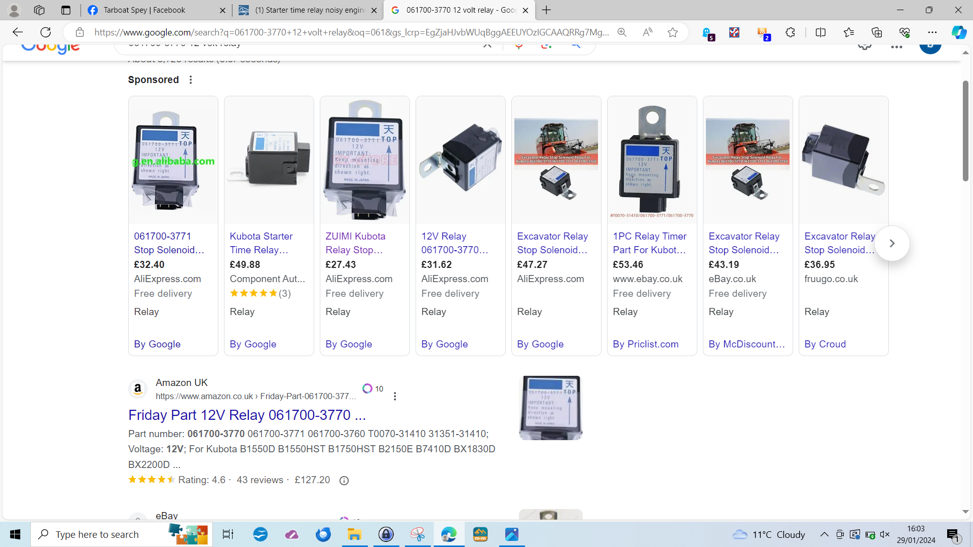

ditchcrawler Posted January 29, 2024 Report Posted January 29, 2024 31 minutes ago, Tony Brooks said: But what reading did you get, both before cranking and during cranking? Long experience suggests new members too often make such statements that turn out to be untrue. I don't understand why it needs a starter relay behind the instrument panel - close to the engine, I can understand, but not remote from it. I looked it up Tony and its a "Stop Relay" so could tie in with the other thread running on here with the failed stop solenoid
Tony Brooks Posted January 29, 2024 Report Posted January 29, 2024 The original post gives me the impression that the OP is just hearing the normal "ignition on" buzzer/sounder, unless that relay has one inside it to warn you to turn the stop system off once the engine has stopped (from Brian's ID of said item). This might be yet another main harness multi-plug problem, so worth taking t apart and refitting to see if anything alters. Until I know more about the relay and as the OP wants one quickly, I think that I would run and a wire (say 28/0.30) between the start terminal on the ignition switch and the single small terminal on the starter solenoid, or even try bridging between the main battery connection on the solenoid and that small terminal. The only difficulty is that the solenoid is often hard to get to. That should tell the OP if it is the relay at fault or something different.
