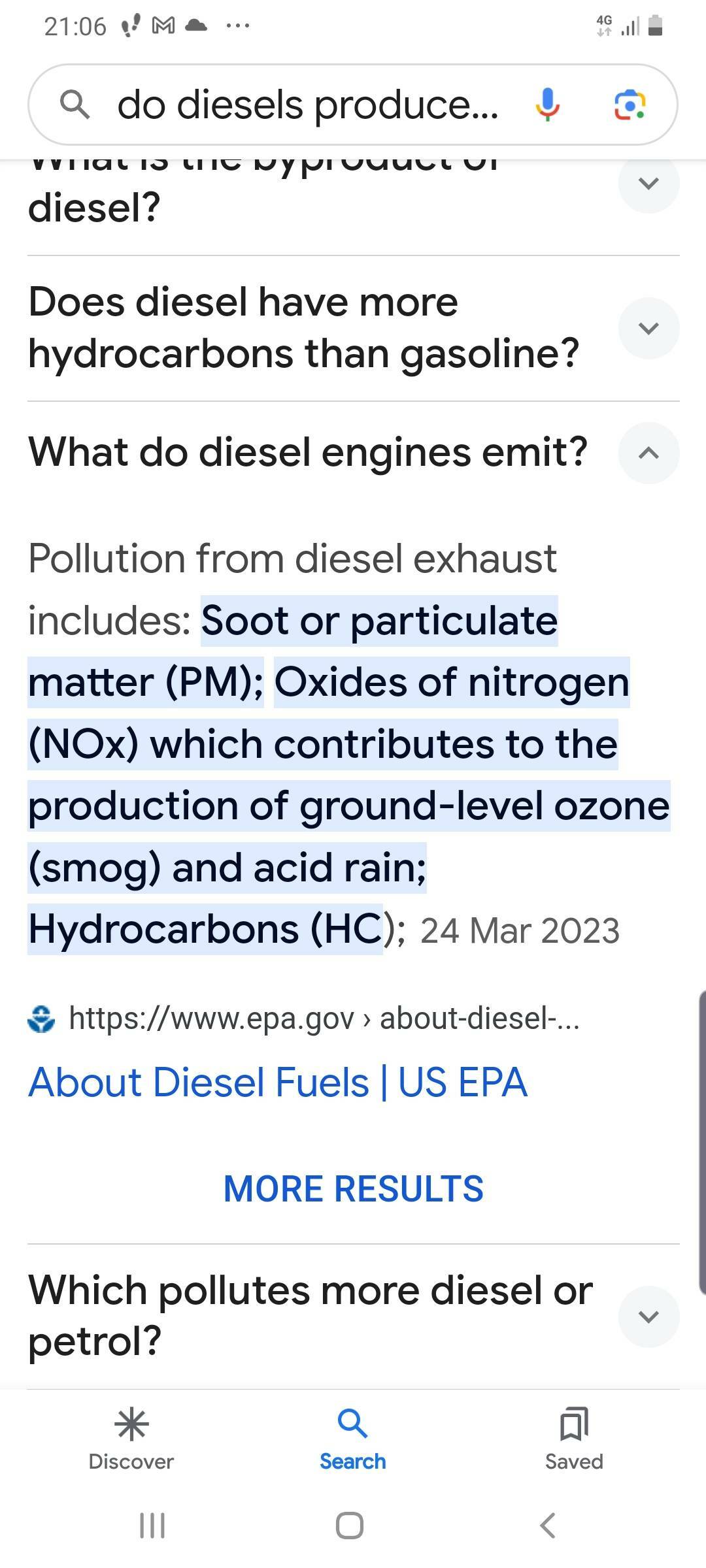

Yes. Certainly at idle I would have thought a diesel produced virtually no CO. Although 100% more is only twice as much, I would have thought it was much more.
If you keep away from black smoke (overtorque)  situations, diesels produce very little CO across the speed range.  That is because there is, even at designed full load,  always excess air in order to achieve compression ignition  temperatures.  Plenty of air meens all the injected fuel is properly burned.  The excess air also keeps combustion  things fairly  cool, so there is little NOx.
No hydrocarbons, no NOx, No CO.  All very green.  Pity about the PM 10's.

Lots of NOx from diesels which is why they have EGRs
