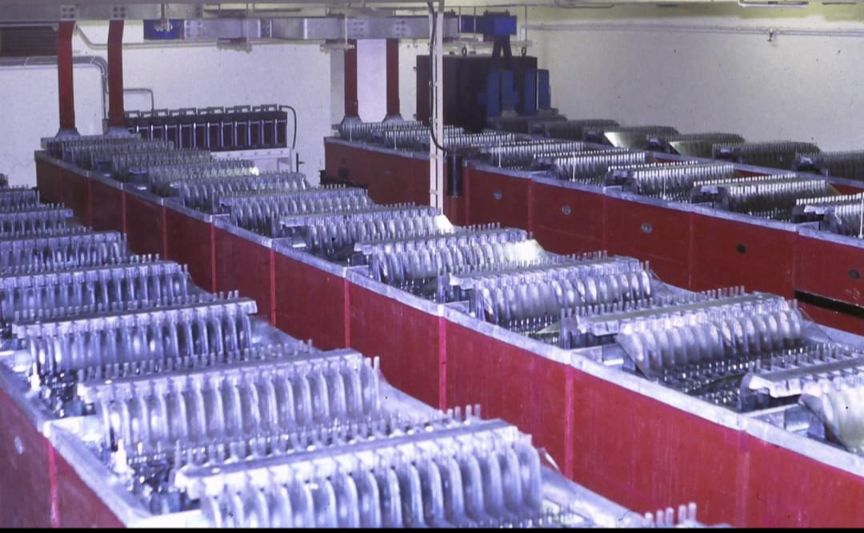

cuthound Posted February 23, 2024 Report Posted February 23, 2024 2 hours ago, Bee said: Batteries are horrible things. If only they had a lid so you could open the top and have a look to see if they were full or empty. What most of us don't realise is just how long it takes to charge a couple or three batteries. On Bee we have 2 x 110 AH batteries - or that is what they were 4 years ago, it takes 4 or 5 hours to charge them from the engine and no doubt you could squeeze a bit more in from a decent charger. We look after them and don't flatten them or they will play tricks like saying they are charged when in fact they are scrap. We now have a bit of solar (not much, just one panel of 30 watts????) and I think it is brilliant, it saves batteries from death and although it cannot power the boat it works all the daylight hours. This summer I will add another one. The ones I used to work on didn't have tops...
