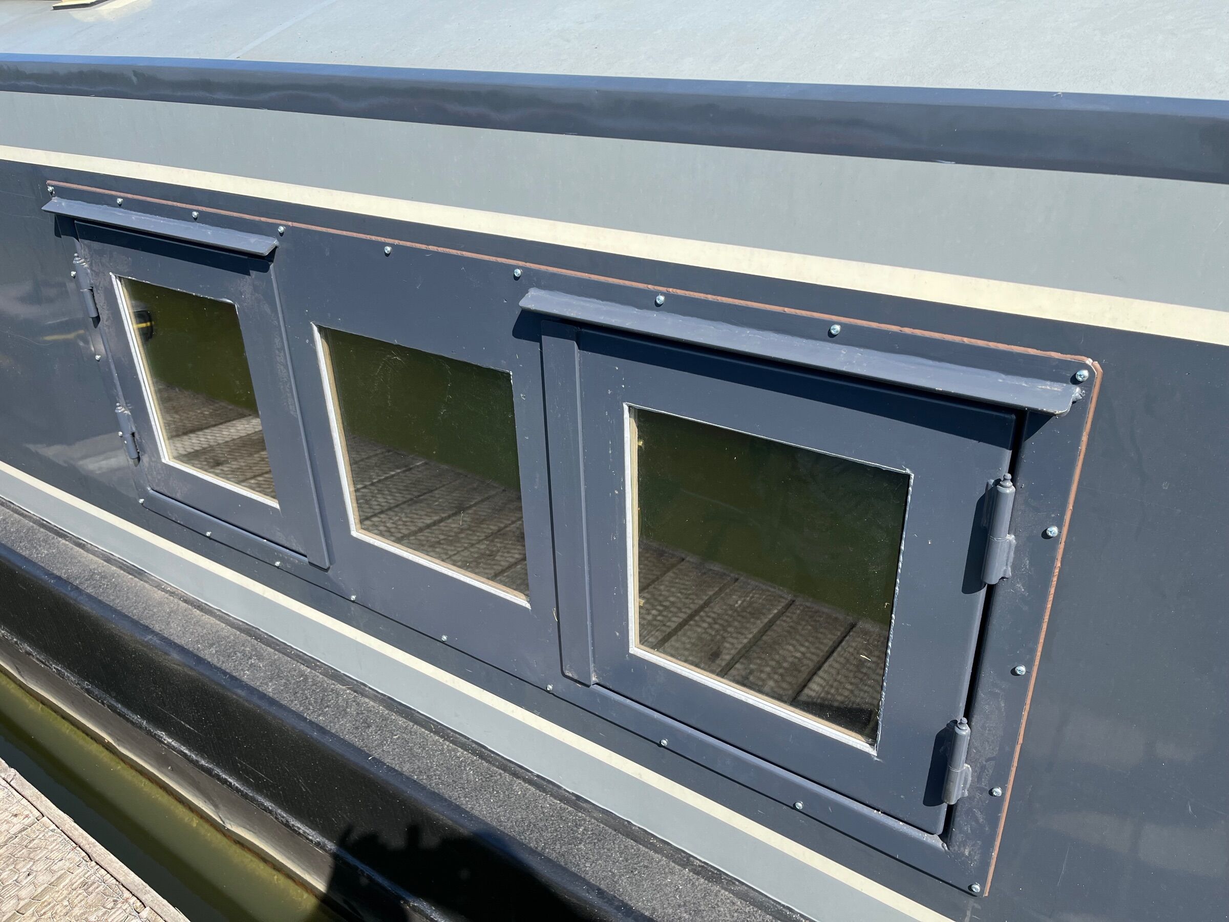

25 minutes ago, IanM said:
I think I'd want it welded in and not just pop-riveted.
I suspect that a seamed weld round that window frame will do terrible things to the visual aspect of the tumblehome steel. Ripples, etc. Also maybe would necessitate the removal of the interior lining too?
But that means removing much more lining and insulation to avoid the fire risk and will inevitably damage the paint around the area. Martin's solutions are designed to be retrofitted to existing boats with minimal disturbance. And for that the screw on solution is ideal.
The impact of the screw heads could be reduced by drilling and tapping the new frame, bolting through from the inside, then grinding the bolt ends flush. Would just require local touching up of the frame paintwork after installation.
Correct
That would work but.be a lot more cost never met anyone wanting this option

Interesting - I wonder if anyone has given any thought as to why boat windows open inwards.
Outward opening windows are frowned upon for obvious reasons.
But I guess that you do what the customer wants !

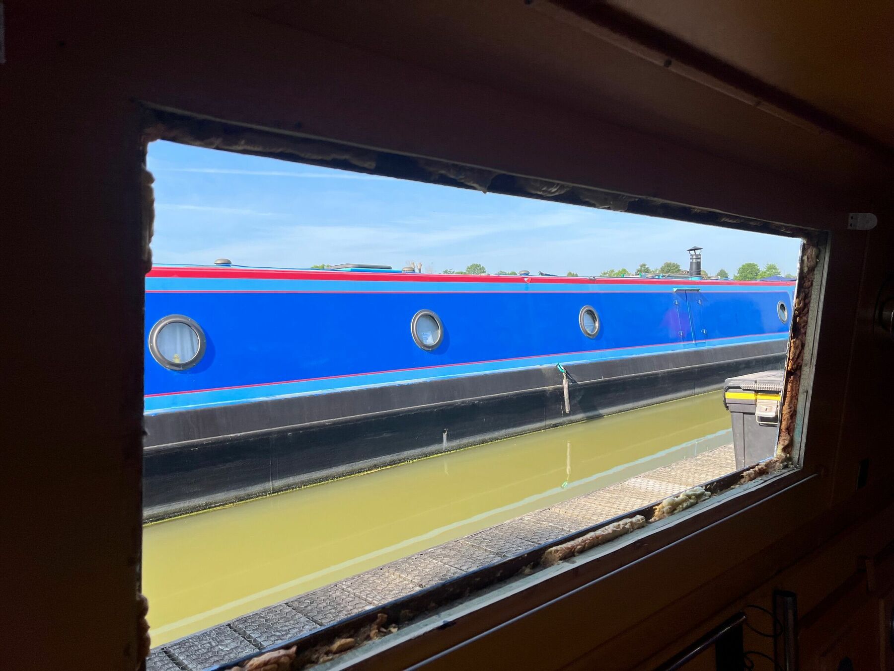

So what exactly was done here, and what was the point?
I'm assuming a window cutout has been enlarged?
The point? Apart from wanting an ugly boat, was I assume so you could pass a cup of tea outside? Very expensive cuppa. Or is it to pass 2 cuppas outside at once, hence the 2 windows? Still an expensive cuppa.
If they wanted a decent opening, why not replace the window with a sliding version? You get just as large an opening, as I really don't see the need in having 2 very separate opening windows as in this case.

The customer requested it

You think you'd find a sliding boat window that big? Even if you could, surely the opening wouldn't be as large as you could only have half of it open?
Plus since you're talking about what's ugly, those sliding windows take the first prize in my opinion.

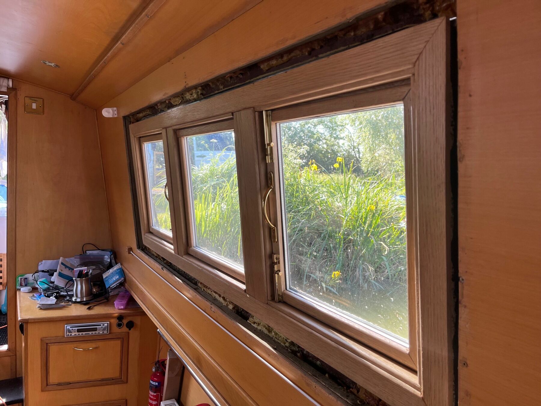

This is true I admit this is not everybody’s cup of tea however I enjoyed the challenge and it was a replacement for an old bus window single glazed so cold and damp. These are double glazed and thus help with the heat loss and are opening in the summer  lots of ideas and views on things as always. I did think it might just offer another option
