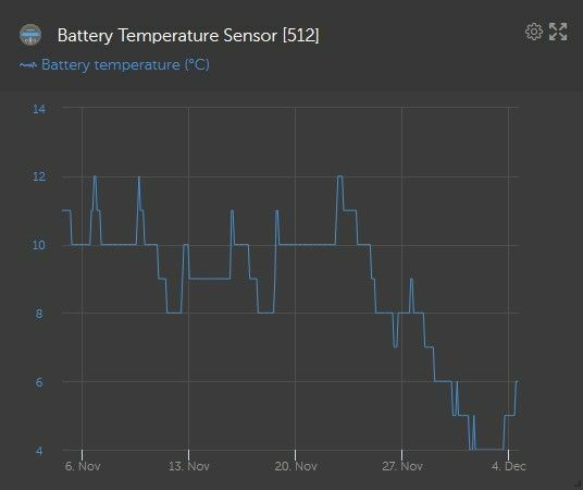

If the batteries are in a boat and sitting on the steel baseplate like mine, they're unlikely to ever get below 0C because the water underneath the baseplate doesn't. In the cold spell last week when I believe the water in the marina froze they never went below +4C.
In a caravan or motorhome or unheated garage (or GRP boat?), they can freeze... 😞

That's part of my concern really- the battery box has a wooden base, so they don't sit on the bare metal, and that 20mm or so of plywood might be enough insulation from the steel that they could fall below zero on a really bad night.
On the worst night we've had so far the sensors got down to 1 degree when the outside air temp was probably about minus 3.
But given there might be an accuracy issue to allow for, that felt too close to freezing for my liking, so I will be doing something with them soon- just haven't decided what's the easiest/best option yet.

ETA - there's also that concern that if I leave the boat for a few days their core will get well below zero, and it will take a few hours to get them back above freezing when I return, before I can even consider doing any charging.
My hope would be that under the bed it would take much longer for the temp to fall below zero, and it might not fall so far as it would in the engine bay.

If they're in a closed wooden box (like mine) then the underside will be at the baseplate temperature and the sides/top at the air temperature surrounding them, so they'll end up somewhere in between.
In my case the other things that dissipate power (about 100w total, mainly the inverter) are in the same space under the stern so the air is never as cold as outside. The diesel boiler is also in the same space, so every time it fires up (frost protection) that also warms things up. I don't have the air temperature in there but I do have the generator and motor (which are not dissipating any power) and these are about 6C warmer than the batteries -- always assuming the temperature sensors are accurate, obviously... 😉
