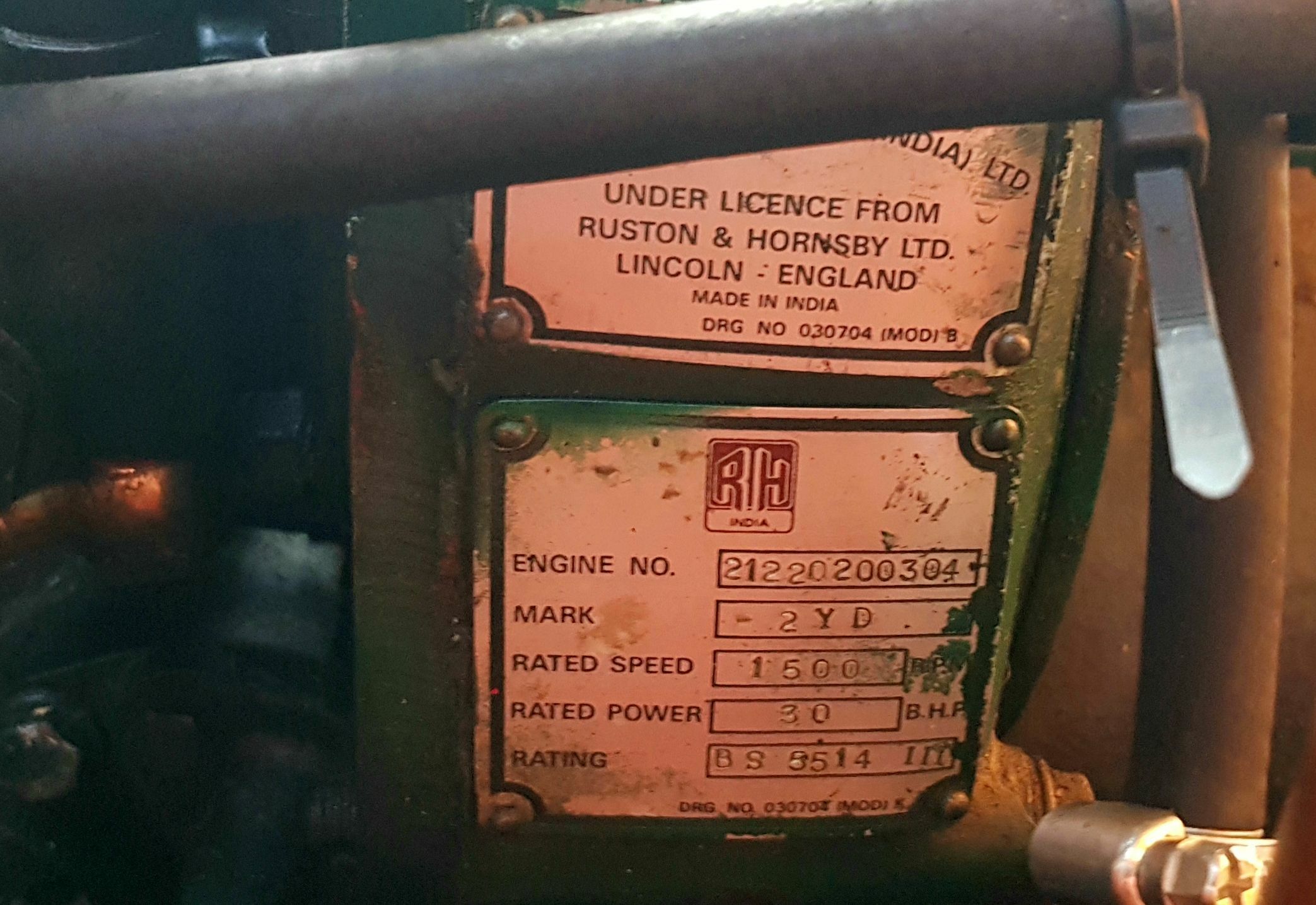

Hi all,
I'm new to this forum. I own a 57ft Doug Moore narrow boat (The Rose) and she's fitted with a Ruston Hornsby engine (see pics)- Can anyone tell me what model and age this is please and where I can find someone to work on it (near Tattenhall, Cheshire). Also any other information greatly appreciated such as best place to buy parts etc.
 A the weekend she overheated, blew out some blue smoke, then white smoke, then died.
Thanks in advance for any info. James

#5
Forgot...this plate is displayed outside the engine bay if that helps...

#8
Looks like a marine version of a two cylinder VRH engine.

#11
Gearbox is Indian made too...by Greaves Cotton.
#12
There you go-all the info you need tucked behind..

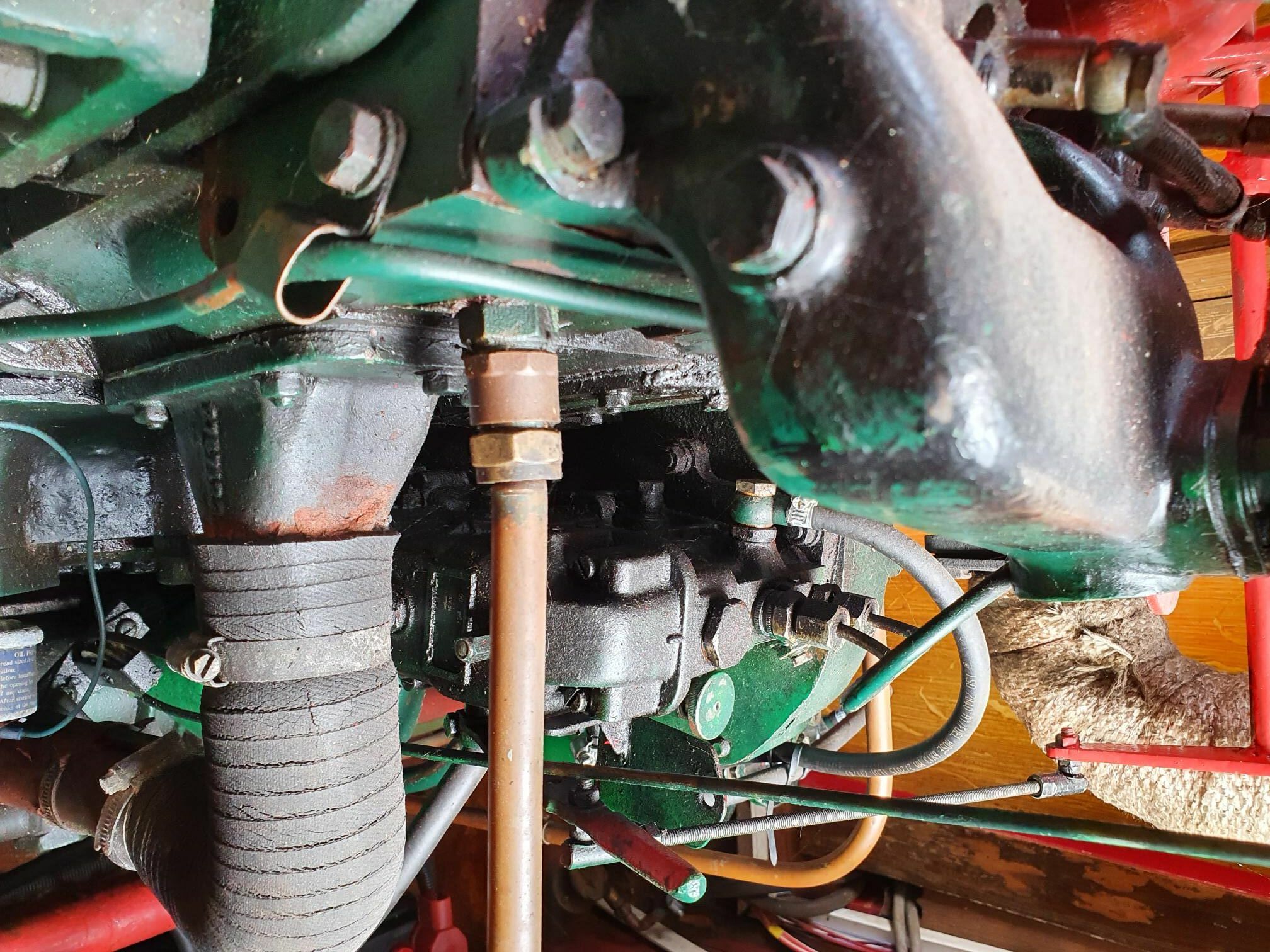

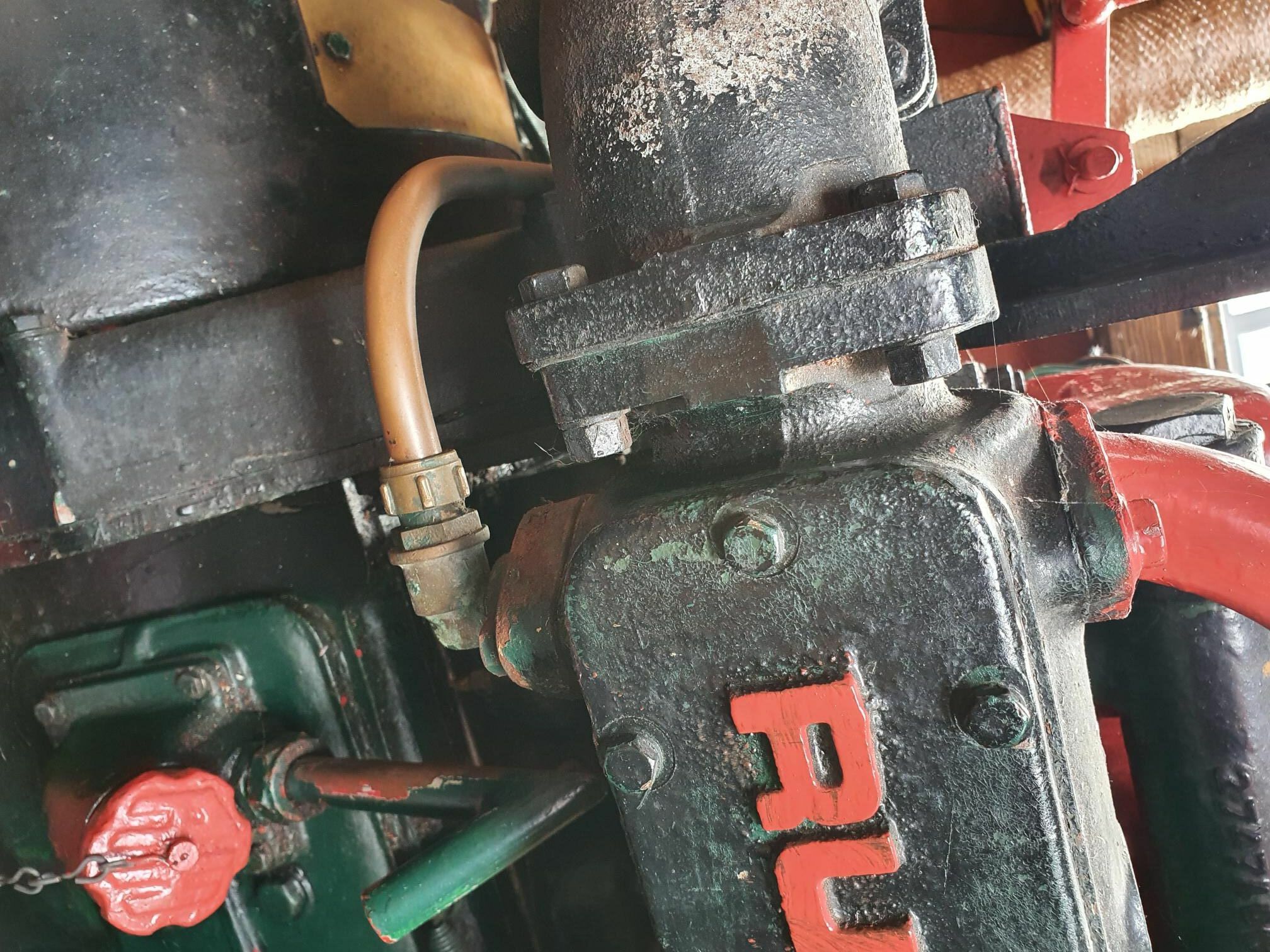

#19
As promised- an update: The engineer from Barbridge (Joe) came out noted that the starter motor was jammed- he sorted that then the engine started first time and ran sweetly. He said that quite often when these old engines overheat they will seize than run fine again when they have cooled down. I'm planning to take it down to him for a full service/change coolant pipes etc, but before I do I need to address the root cause of the overheating problem- which according to Phil (Longboat Engineering) is down to the fact that its had a calorifier retro fitted. I don't use the calorifier so I'm happy to get it disconnected and I can plumb so no problem with this- but my question is this- the pics show the inlet and outlet to/from the calorifier- should I just disconnect these and blank them off? (The engine is cooled via a skin tank).

#20
Why not just fit a gate valve in the calorifier circuit so that you can reduce the flow to a level where the skin tank is not bypassed too much?

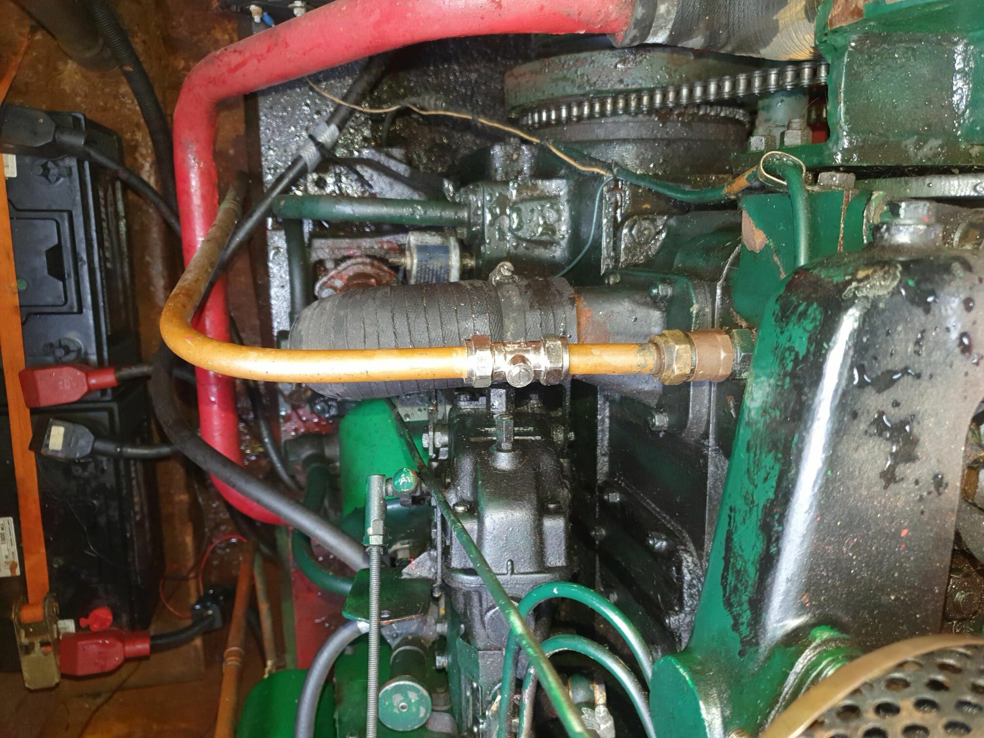

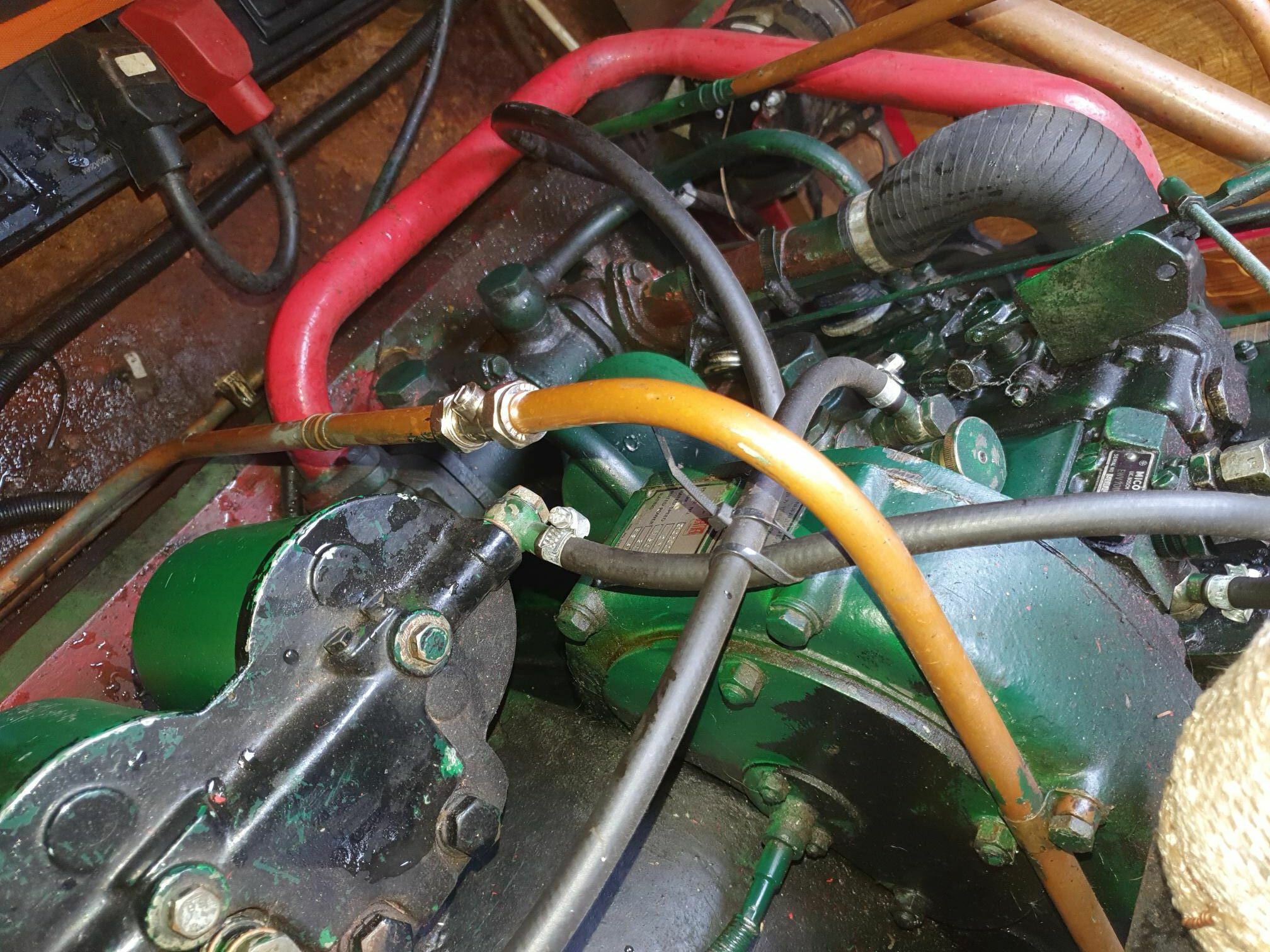

#23
OK: I've fitted an isolation valve on the feed and return to/from the calorifier (probably just needed one on the feed but hey ho!). I did check with the engineer who came out to see it and he said that would sort the problem, but would be grateful if anyone could let me know if this will cause a problem before I  fire up the engine. As far as I'm concerned it wont as the calorifier is fed directly from the engine (not via the skin tank)- so all I've done is taken the calorifier out of the equation and forced the coolant to flow through the skin tank only (surely as per the original design). The first pic is the feed pipe, the second is the return. 20220829_180521.jpg.d1071730f9b28c7d102ae48cda79ff0a.jpg20220829_180444.jpg.8e2db732ee7e5ddee4c34647029a7583.jpg
#24
It shouldnt upset it although I would double check with Longboat in case its actually a bypass for thermostat thats been tapped into.
Did you inherit the secondary electric circulation pump that was fitted to the calorifier circuit or had that been removed? Im guessing thats its such a convoluted circuit you wont get much flow through there without that pump being switched on so in effect it was blanked off anyhow.
