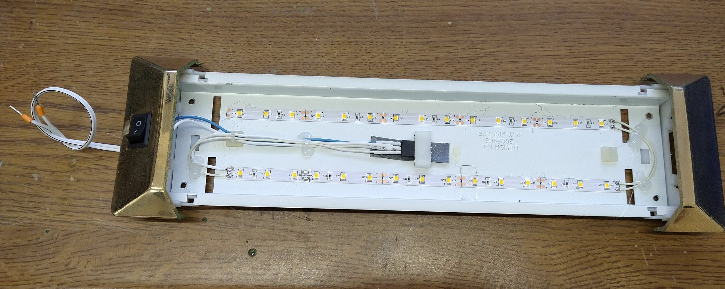

I have just replaced all the strip tubes in my lights using Flexi led strip.
This is the strip I used it comes in 5m runs.
https://www.amazon.co.uk/dp/B00WQFP1LU/ref=cm_sw_r_apan_i_21YEGPG5F3FQX6WE6JVN?_encoding=UTF8&psc=1
I fitted a low drop out 7812 regulator in each strip light to cope with excess voltage
https://www.ebay.co.uk/itm/362255962936?
These work reasonably down to 12v but don't regulate much below 14v so with 12v in you get 10v out which is enough to run the 50cm of strip in each fitting.
If running the full 5metres you will need to search out another regulator

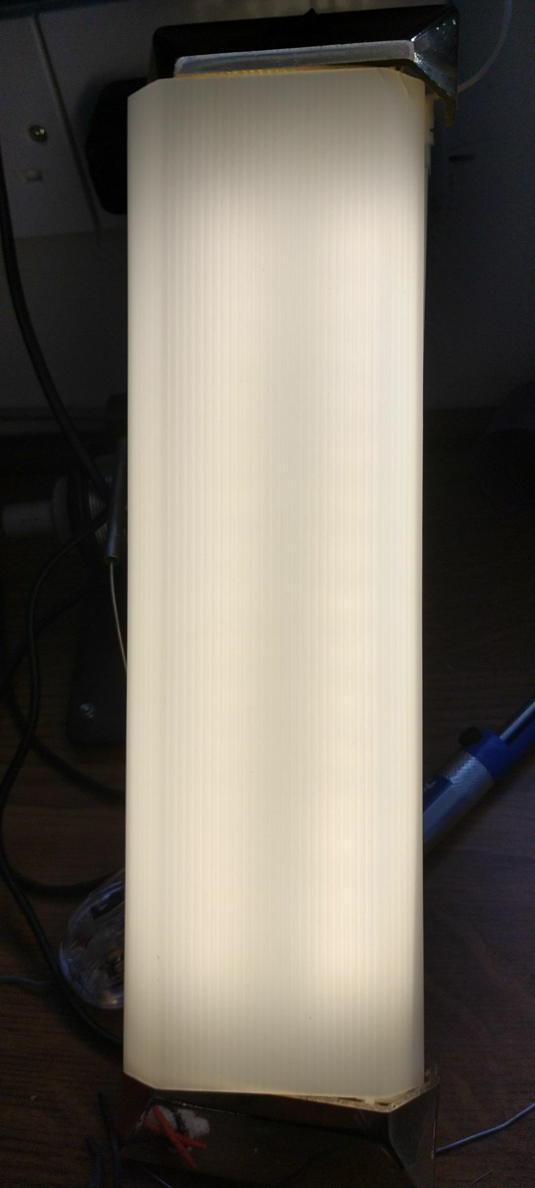

Second point is the concentration of light in points along the length of the strip makes a very different light smoothness than a fluorescent tube.
Except very hard to see the points of light through the diffuser on my strips, yes it's there in the photo but in real life it's not noticeable and the perceived  brightness is the same as a pair of strips.
Yes a diffuser makes all the difference. Here is an example of the aluminium channel plus added diffuser for single strips I mentioned:
