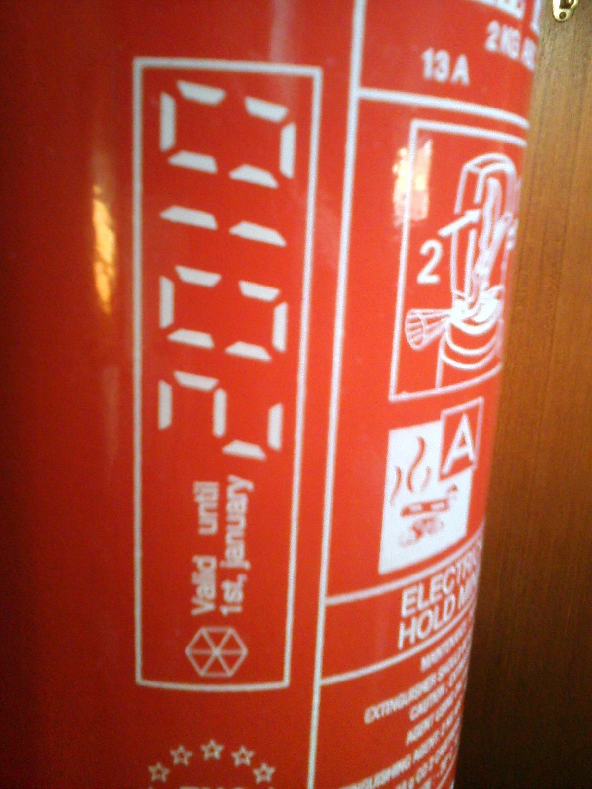

Alan de Enfield Posted January 18, 2022 Report Posted January 18, 2022 (edited) 5 minutes ago, MartynG said: If that's the case why are the 1kg extinguishers for sale at all? Because the ignorant buy on price, not performance. 4 minutes ago, TheBiscuits said: That's the minimum total spread over at least three extinguishers on a 36ft+ boat. Add the A's and the B's up to exceed those figures. My extinguishers are 13A so 3 of those are 39A which meets and exceed the MINIMUM of 21A I dont remember the B rating but again it way exceeds the requirement (Its an old picture with the 'do not use after 2010' extingusihers that the BSS examiner passed in 2015) Edited January 18, 2022 by Alan de Enfield
