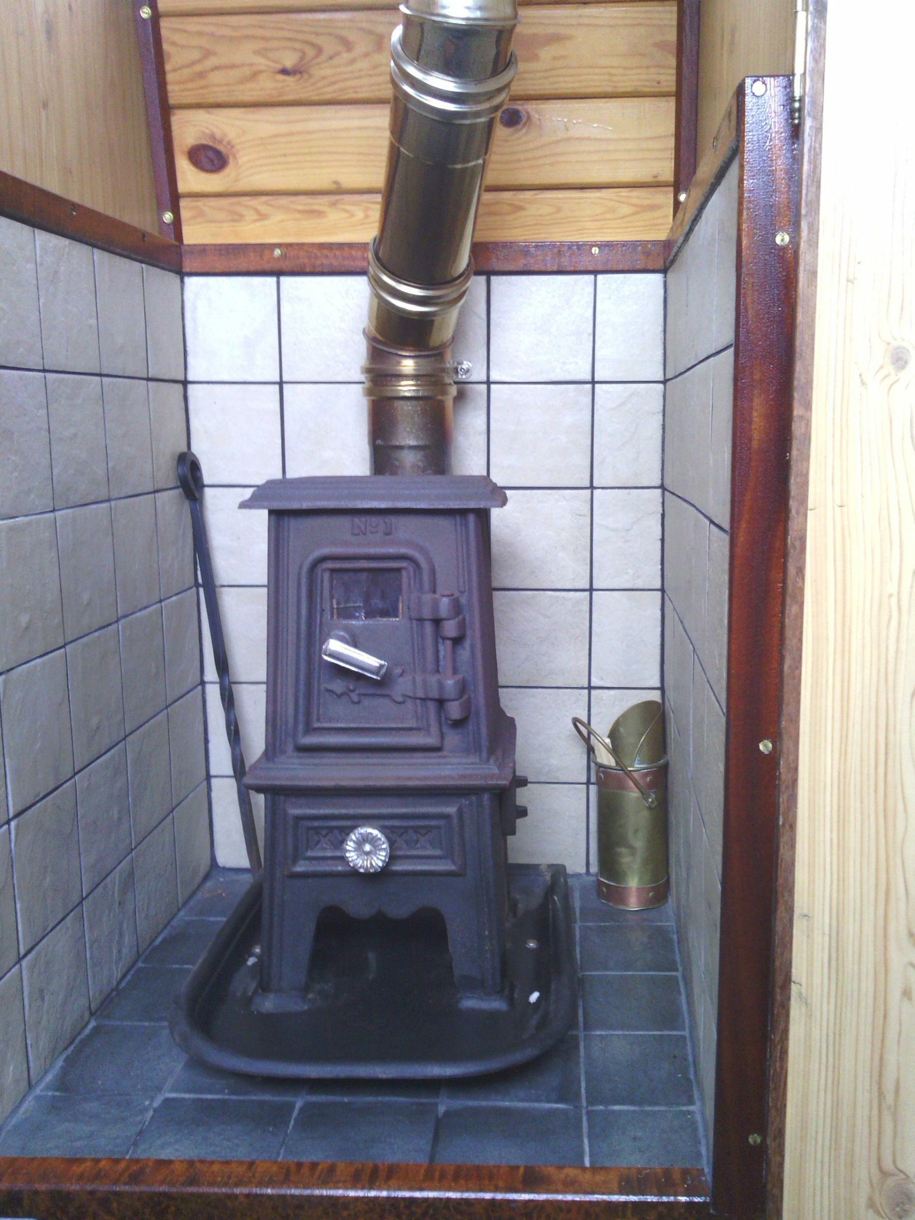

Your simplest way would be to use a small solid fuel stove such as the 'pipsqueak' it is designed for small spaces (boats) and is 3.5Kw. We had one on a 30 foot NB and didn't need any radiators so it only took up a space about 2' x 2'. The tiles are 4" squares.
This was it (the 'door' is 4" wide and the firebox is about 8" square. did a trial and got the boat up to over 50 degrees C, couldn't breathe, gave in and opened all the doors and windows)
Pipsqueak Small Cast Iron Stove – Pipsqueak Stoves (pipsqueak-stove.com)
Technical Info:
Height 440mm
Width 310mm base
200mm stove
Depth 380mm base
180mm stove
Flue size required 80mm
