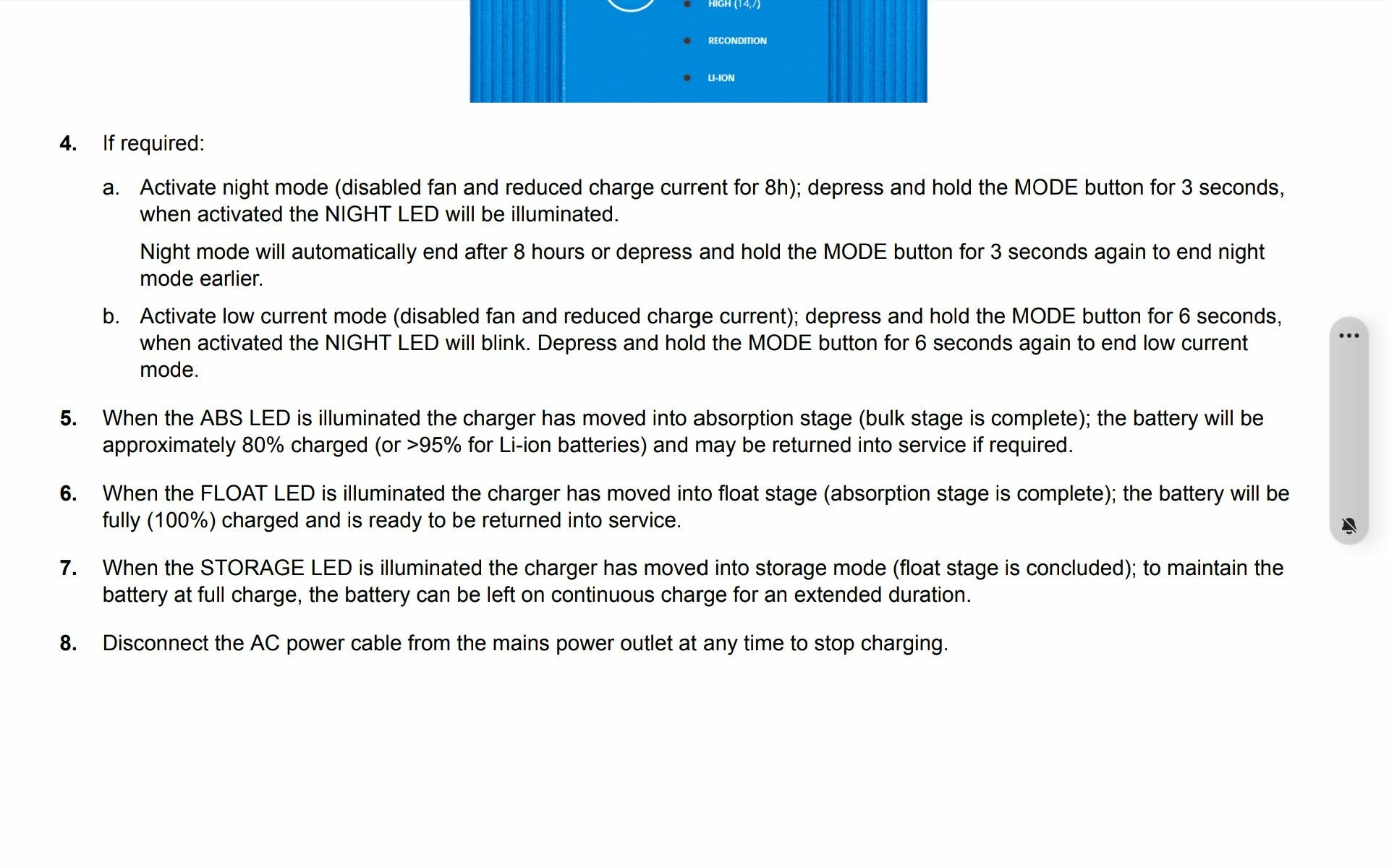

noether Posted September 19, 2021 Author Report Posted September 19, 2021 1 minute ago, The Happy Nomad said: If you can check them ensure they are not gassing, ie literally hissing and producing a visible gas. If your CO alarm goes off unexpectedly with no appliances on this can also indicate they are gassing. You should ideally check to see if any batteries are bulging excessively and/or becoming very warm under charge. If they are turn your charger off. Thanks, yeah, this is what the chap said (I brought it up, he didn't, in case you're worried) - he said if you can smell them or they're making noise then turn everything off and jump in the canal. Again, I'm afraid I can't speak to the chap's competence because obviously I don't know, but he's an older gentleman (older than me anyway) and he works fulll-time at the marina - he might be the owner for all I know - so I'm assuming/hoping he must be vaguely qualified, and he was much more concerned that the fridge wasn't working than he was about any danger from the batteries (he says, massively tempting fate), and he seemed somewhat surprised that I was concerned. He did look at the batteries, although not particularly thoroughly - they are in a very awkward position. When the engineer is back from holiday I'll ask again if he can have a look. I was looking at some of the settings on the charger, should I be using them? Like 'night', for example?
Guest Posted September 19, 2021 Report Posted September 19, 2021 (edited) 37 minutes ago, noether said: I was looking at some of the settings on the charger, should I be using them? Like 'night', for example? I'm personally not familiar with your charger as ours was a different make and model so cant really say what those settings are for or what they do. Somebody else may answer though. Edit - however looking at the manual on line 'night mode' reduces the charge rate and turns the fan off for a preset period of 8 hours. It then reverts back to normal. If the fan doesnt bother you now overnight I personally wouldnt bother. Edited September 19, 2021 by The Happy Nomad
