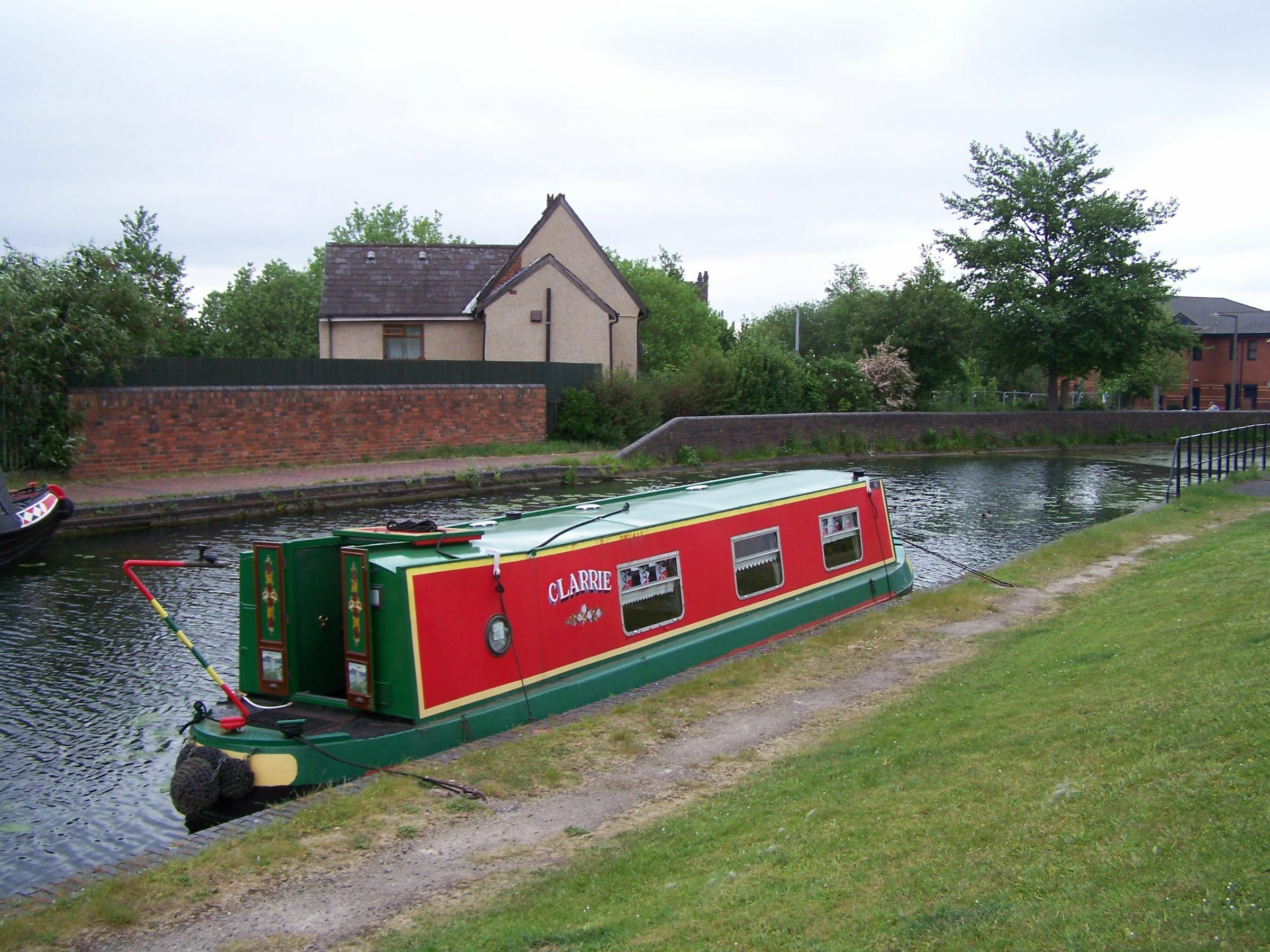

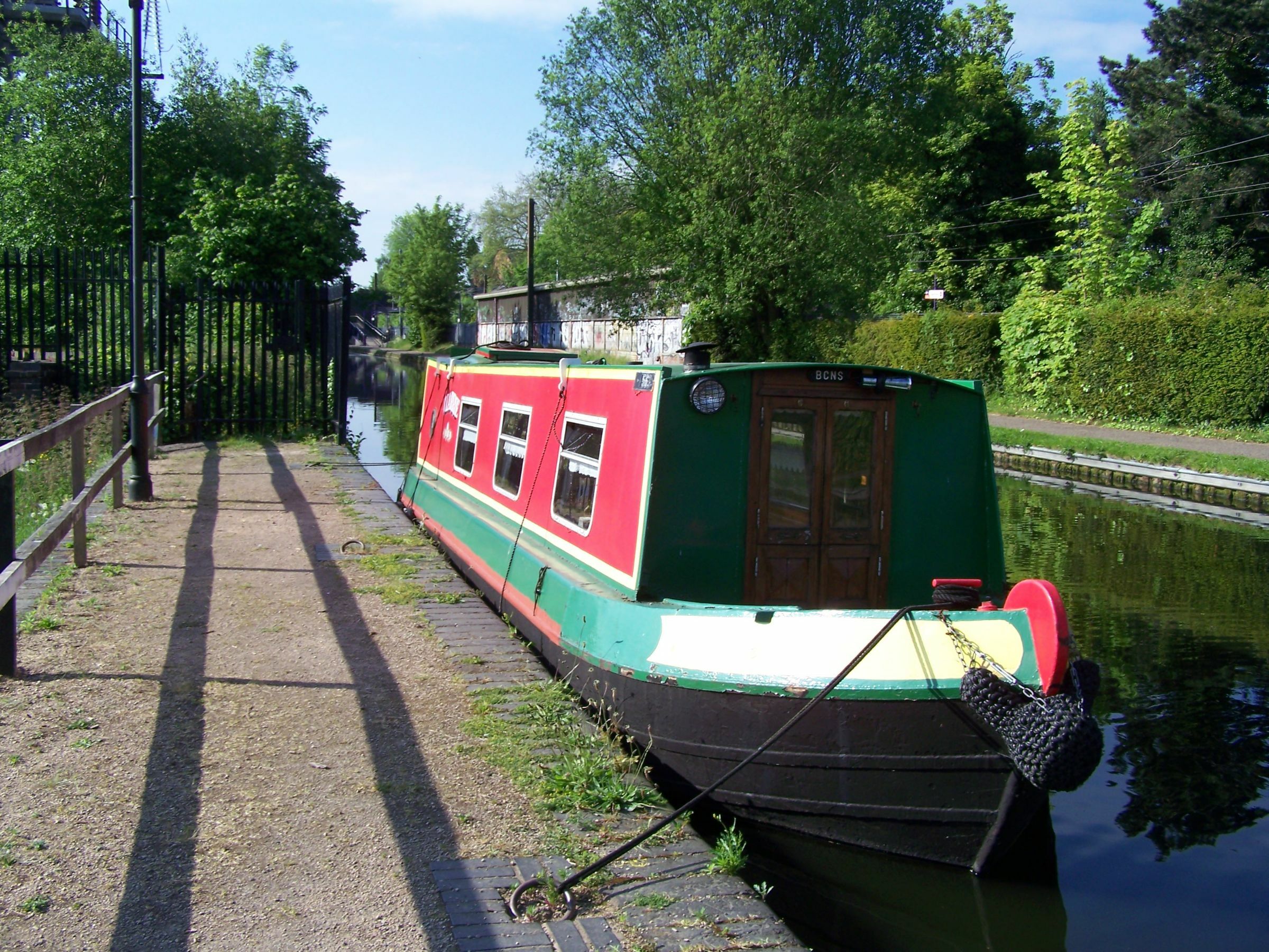

My 1989 Springer
Marketed as the "tug style" at the time.
