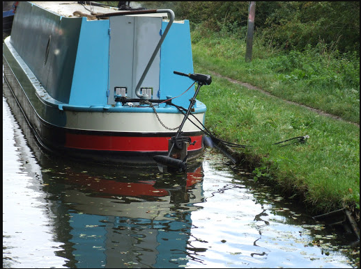

Electric Motor 25% discount if the Boat has an electric motor as its sole means of propulsion.
Odana, lapsed member of this forum, fitted an electric outboard to a boat that was never going to move, because if the boat had no engine at all the full rate was payable, but with an electric outboard the discount was available.
The boat was used as an office and spare bedroom - a very comfortable spare bedroom having stayed with them once or twice

Sounds sensible.They are light enough to simply clamp a second motor on the transom when on a river, providing there is enough space.
I've heard of owners of full length butties doing the same, even though a 40lb thrust trolling motor is never going to propel a full length boat at even minimal speed.
I have no idea how well it performed
I imagine that it puts a whole new twist on 'move a mile every 14 days' when it takes that long to cover the distance. And probably as much use as a feather anchor at stopping it. But if that, a pole, a rope and a broken inboard diesel are all you've got then at least on a sheltered narrow canal it should be possible to get the boat moved the bare minimum.

't's a while since I updated this thread (we were only emerging from lockdown at the last post) so I thought I'd give a brief update.
The electric outboard still hasn't made it anywhere near the boat on the canal but I have tried it out on the boat that it came with.
Actual specs, converted into what we understand, showed how poorly they compare to a petrol outboard. At 350W it is just about 0.5hp so it's certainly sub-featherweight, even for dinghy outboards. For comparison, it's a similarly light weight as the last of the 3.3hp mariner/mercury 2 strokes, which still seem to be very popular, and have oodles more power.
The 17' sailing boat has two bilge keels that the cruiser on the canal doesn't. Both boats come in around the same weight of 600kg. I suspect the Shetland with a much reduced draft on the canal would get caught by the wind worse than the sailing boat did with its sails down.
I only went up and down the creek to move boats around, no way would I have gone out onto the river without a petrol outboard, but even so, and even with only very light breezes, the motor just didn't have the power to make it feel as though you were fully in control of a situation. It took a combination of motor, wind and pole to pick up mooring lines to get into the mooring one day.
They are very thirsty electron juice wise. I was running off either an 85Ah leisure battery or a 120Ah Landy battery, both in reasonably good condition, but an hour of use was about as much as I wanted to risk on each, and for most movements half power was enough to move the boat forward at a leisurely pace. Even this lowish thrust motor was still drawing about 30 amps I guess on high setting.
One problem that I have encountered, specific to my motor, is that it has always been used on a sailing boat with independent rudder and tiller. It's always been fixed in one position so the shaft is completely seized in the transom mount. WD40, silicone, mallet etc haven't worked to free it. One of the reasons I haven't tried it on the canal.
However, all this doomsaying doesn't mean that it's not viable under certain circumstances. I don't move frequently and I don't move far, boat on narrow canal sits on mooring or cruise maybe twelve miles in one direction and then back. I can cycle between locations for car, transport batteries from land home charging, happy to leave boat away from home mooring etc. The mighty half horsepower will be enough to propel the boat in calm conditions. Stopping on a sixpence when fifteen tons of steel comes round a narrow bend or hitting hard astern may prove a bit more challenging. The pros are obviously a cleaner, safer and cheaper fuel, near silent propulsion and the relatively cheap cost of each component, batteries under £100 each, motors from £150. The motors, being simple, are connect and go and the better makes have a reasonable reputation for longevity.
An aforementioned idea of twin motors seems a good one, especially given the lack of a powerhead, two on the back would be possible.. With twin engines, one fwd and one astern, comes great manoueverability. Heck, that would be reaching the dizzying heights of more than 1hp.

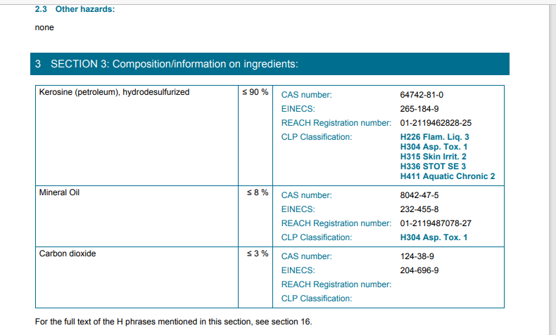

Which is simply aerosol Kerosene - check the cosh data sheets.
~90% Kerosene
8% Mineral Oil
2-3% Carbon Dioxide (propellant)
Just use diesel or petrol - why pay for someone to put it in a can.
~90% Kerosene
8% Mineral Oil
~90% Kerosene
8% Mineral Oil
I think there must be something else in Plusgas  as well.
It really does stink,but not like kero or oil.
All ingredients must be given in the COSH data and it only states the 3 I quoted.
