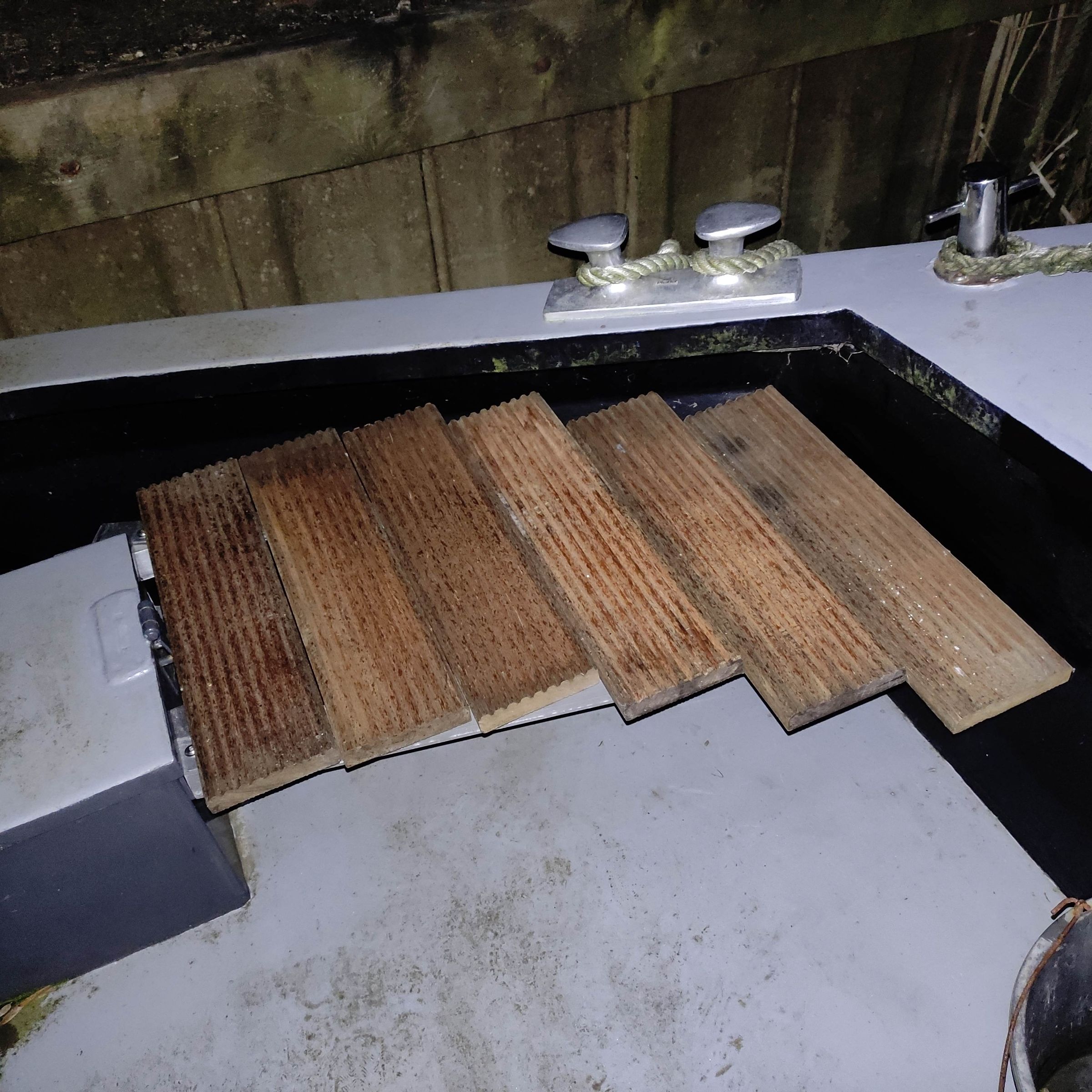

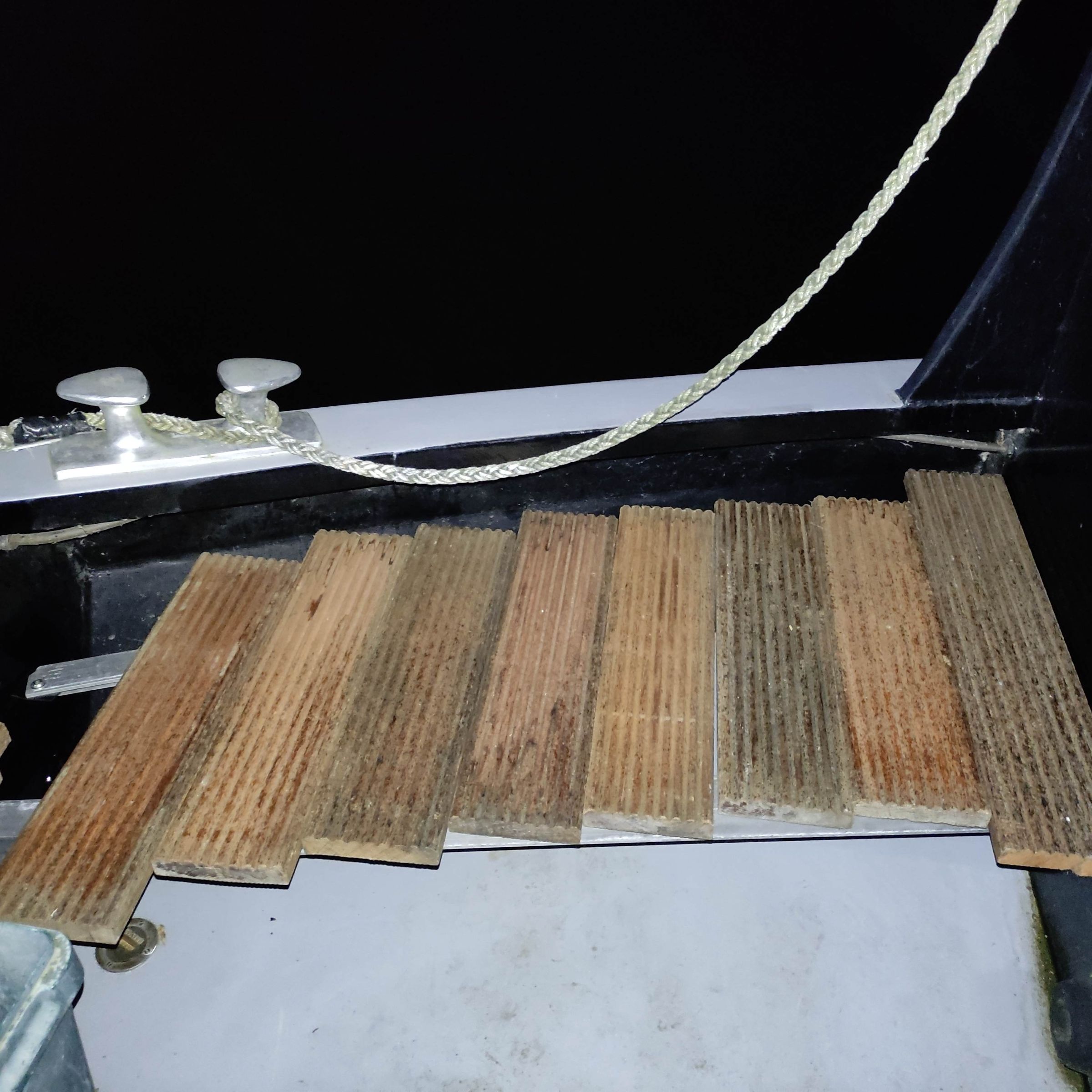

I decided to use the hardwood planks I've got on my new bow well benches rather than buying phenolic ply. I laid the planks on the frame and jumped up and down on it with a neighbour and it was fine.
I'd like to butt the planks together like this but don't want trapped water between the planks to rot them or expansion to buckle the whole thing. I don't mind a 2mm gap but no wider as you see the frame and it's not aesthetically pleasing. I think I'll have a 2mm gap to be on the safe side.
