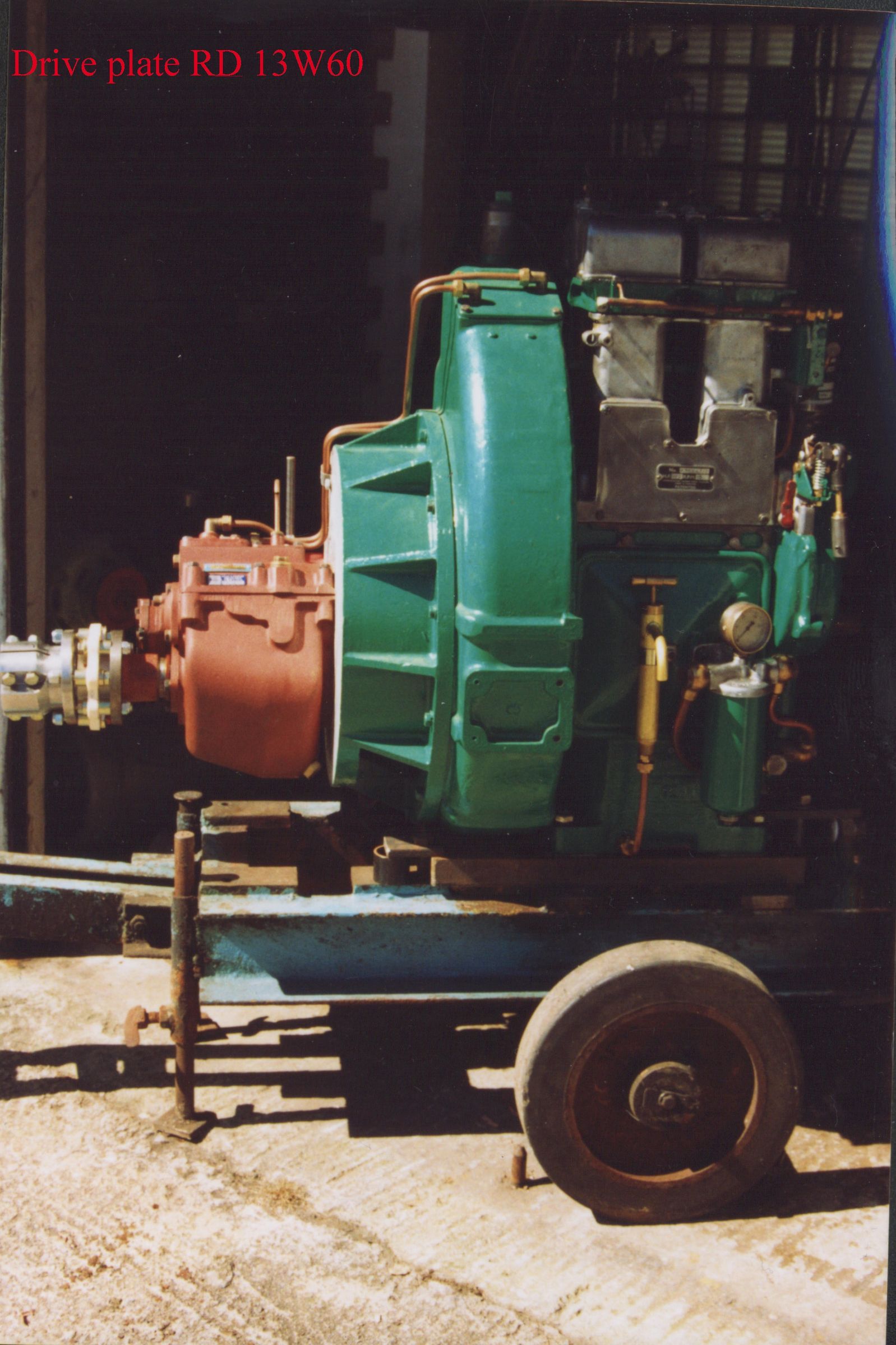

How did you get on with air flow threw the flywheel? Looks a big but nice setup.
My other option is to put a shaft threw to the box with a cover over it
We had an hb 3 with the same set up, prm box on the ‘wrong end’ of the engine. It had a cage fabricated between the flywheel and the gearbox. It cooled fine.
Meant we could run a big pulley off the other end with space around it..

Thanks, looks like best option will be to run it off the flywheel end, good news for me as means I can use my stock national box

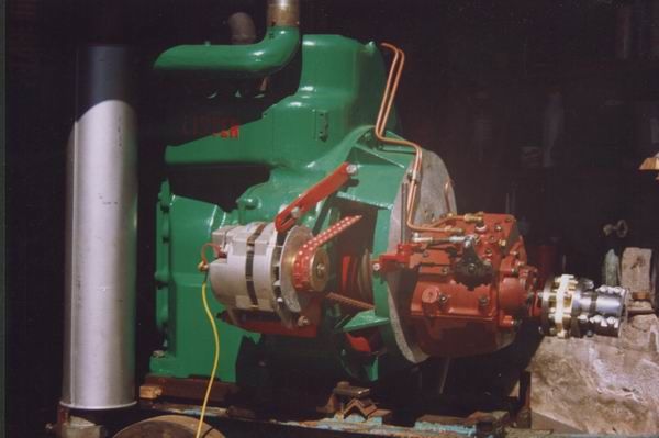

At least 1/3 of the bell housing forms the air inlet as per the image. There is a cast iron spool piece bolted to the flywheel register face with an enlarged portion which the gearbox drive plate bolts to and also provides the correct alternator drive ratio, (high charge at low reves).

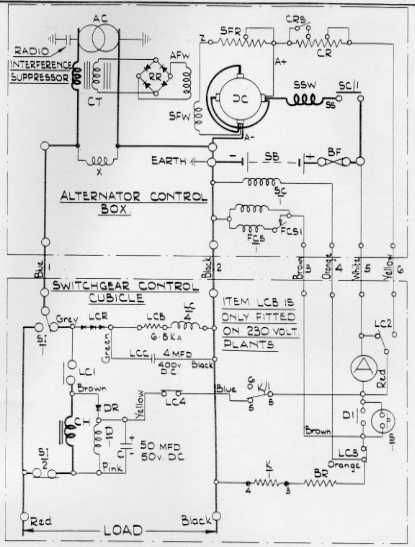

It sounds like you have a 'Startomatic' house set and associated control gear?
Pos it has a heat cooling outlet shield on and all electrical are cooled too with vents on, once its stopped raining next week I'll get it out and get more details off it ive not had it long.

There were no electronic governors on 'Startomatic' sets, more like early relay logic to sequence start up/shut down events.
All HA generators are designed to operate indoors or in a protective enclosure and require the air ductwork to prevent recirculation of the cooling air.

Thanks for wire diagram though!

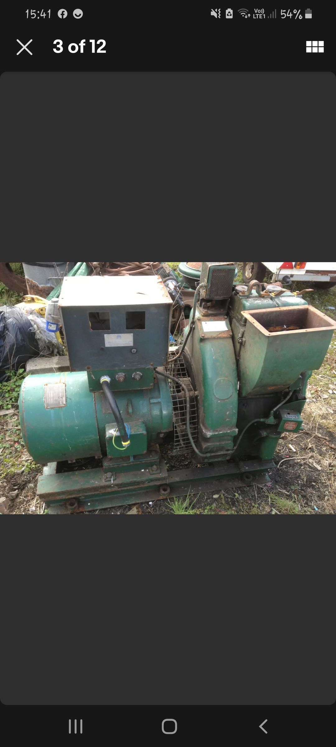

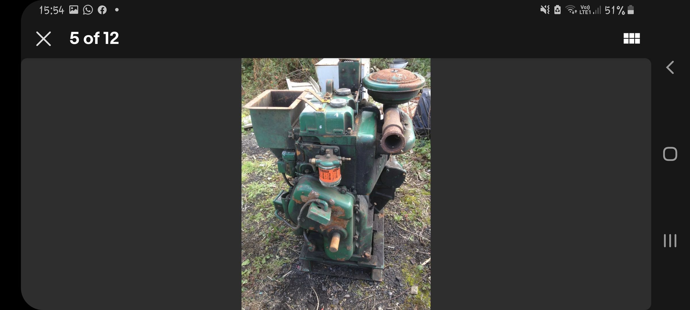

So an update to my engine, I have now found out what it was used for and why was replaced,
The engine is fine its the dynamo / alternator thing that failed.
It was installed into a railway carriage to give 240v to buffet cars and lighting on coaches when pulled by a loco that couldn't provide power, it was then bought (coach) by a small railway society and used until a few years ago when one day the alternator side of it (240v supply) failed, it was then removed and a replacement unit put in. This was then kept as a spare engine, but they decided to sell on and the funds go towards a diesel loco restoration.
This will explain why it has all the ducting on in and extra air feeds to all electricals as it was in the back of a guards carriage.
