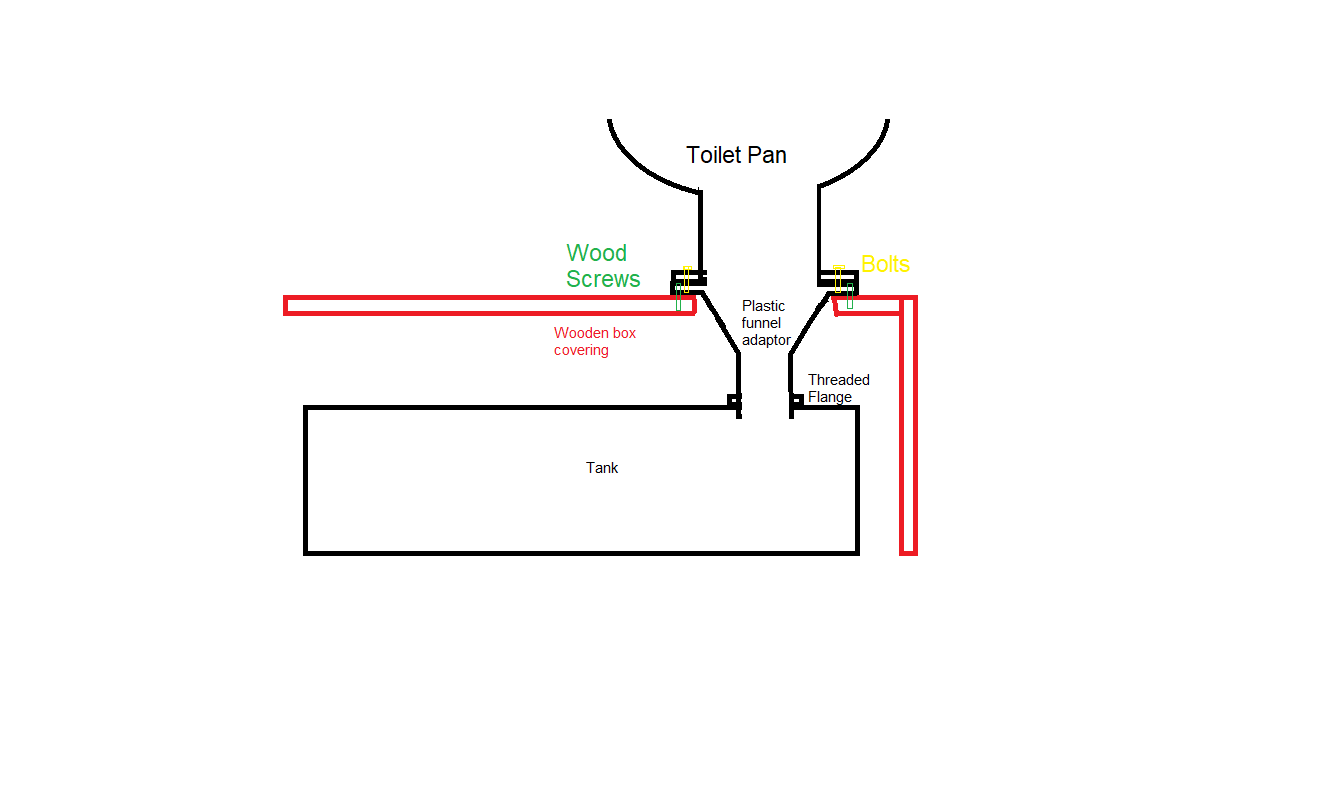

ditchcrawler Posted July 19, 2020 Report Posted July 19, 2020 (edited) After the last boat we had, a shared boat, I made sure our toilet was properly sealed to the tank with a screwed flange welded on the tank and the bowl supported on the wooden covering. The hole I blocked was the pan overflow hole in the back of the pan vot the ball seal. My tank vent is the same size as my pumpout connection, 38 of 40 mm I think and is very short coming out just below the gunwale Edited July 19, 2020 by ditchcrawler
