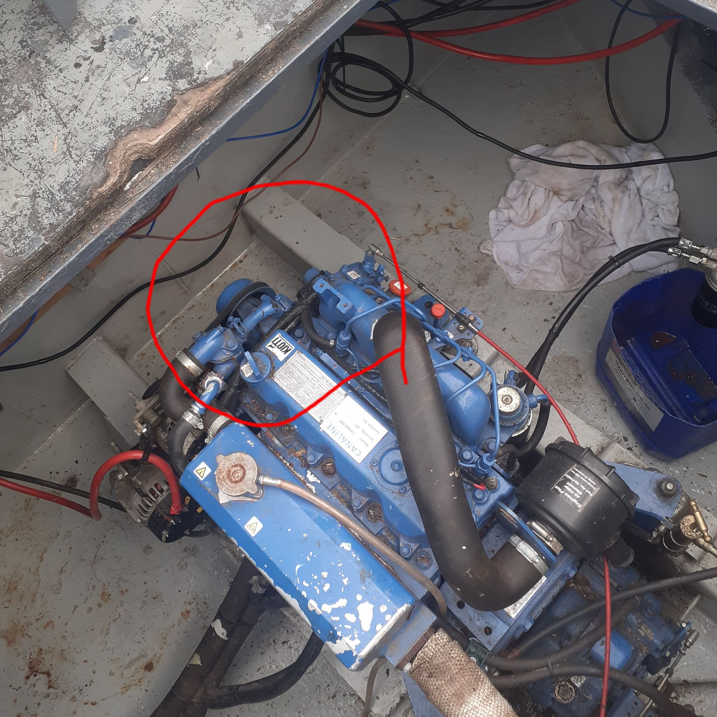

pedroinlondon Posted July 10, 2020 Report Posted July 10, 2020 Hi I wonder if anyone can help despite the vague description that will follow... I cruised for about an hour a few days ago without any trouble at all. This evening I switched the engine on, it started fine but after few seconds it stopped, and then white smoke come up from the area encircled on the photo. Not nice. I don't want to try starting it again as I don't really like white smoke coming out from where no smoke of any colour should be coming out of. There's nothing charred, no marks and no leaks that I could see. Any ideas? Video not of while it was smoking, just to better show the area in question: Thanks

pedroinlondon Posted July 11, 2020 Author Report Posted July 11, 2020 9 minutes ago, Tony Brooks said: 1. As I can't see anything in that area that would smoke I have to think a bit outside the box. Somewhere there is likely to be an engine block to hull bond and that just might be in that general area. If it is and if there is a poor connection then when starting or if you have a high output alternator the poor connection might smoke. 2. No, that sounds much more like an electrical problem unless its exhaust fumes escaping from the engine but that would be on the other side. Is there any chance that an alternator belt may be slipping and smoking. This can happen with well discharged batteries at first start up but it is usually accompanied by a squeal. To be honest I suspected an electrical failure of some sort from the beginning as the cut off was so "clean" but that was just a hunch, as I'm such a newbie... No squeal at all but the alternator belt could be too tights or worn. Would a problematic alt belt send a signal for the electrics to shut down? So if it's the belt and not the alternator, could the smoke be white? The alternators are on the other side but the belt naturally runs all the way along.
Tony Brooks Posted July 11, 2020 Report Posted July 11, 2020 1 minute ago, pedroinlondon said: To be honest I suspected an electrical failure of some sort from the beginning as the cut off was so "clean" but that was just a hunch, as I'm such a newbie... No squeal at all but the alternator belt could be too tights or worn. Would a problematic alt belt send a signal for the electrics to shut down? So if it's the belt and not the alternator, could the smoke be white? The alternators are on the other side but the belt naturally runs all the way along. A belt problem would not send any signal but may make smoke that I would expect to be rather blackish. It the water pump had sized (smallish pulley in the middle of the red circle) then the belt may smoke in that area and as the rubber softened by heat it could stop an engine that is just idling but this is a very long shot, the engine is probably too new for that to be likely. Operating the stop while spinning the starter while you look a that pulley would show if the pump has seized. You can get steam (white smoke) soon after the first start if the engine is damp but that would be exhaust related and that is in the wrong place. Experience shows ordinary boaters often mistake steam for smoke. I would see if it start while keeping an eye on the area that smoked. I don't see how we can get any further without being on the boat or a lot more information. The area you indicate is far too wide to be sure what may have smoked. I can't see the engine stop control in the video and I am not familiar with Koti engines so how do you stop it? Just turn the key off like a car or push a button or turn the key to a special stop position. If its the former it has an energise to run stop system so if the electrical supply to the stop solenoid was interrupted it would stop very cleanly but that would not explain the smoke. Building on this if the smoke was from a short circuit (tends to be light greyish) then it may well have blown a fuse and on an energise to run diesel that would stop it. This is conjecture based on the little info given, there is no visual evidence for it. I have no idea where Canaline put the engine fuse but its probably an inline holder tucked close to the main wiring harness. I am going to my garden now but will check back in a couple of hours.

pedroinlondon Posted July 11, 2020 Author Report Posted July 11, 2020 2 hours ago, Tony Brooks said: I am going to my garden now but will check back in a couple of hours. Thanks Tony. I can see you're intrigued by this I will be back to the boat in a few hours and will see if it's possible to place a camera or even two in the area. Hopefully that will make things a bit more clear. As for the smoke being steam, I really don't think so. It was heavier, whiter and rising quite differently from steam. 1 hour ago, Sir Nibble said: When you have two symptoms appear concurrently I find that if you chase down the easiest then the reason for the other will usually become apparent during the fault finding process. There's a caveat goes with that, in that the smoke may have been appearing soon after start up for months and you only saw it this time because you looked when the engine stopped! That could very well be the case. I only happened to notice the smoke at the boards were up. I am in the process of replacing the phenolic boards and was going to measure them while the engine was running. More often than note the boards would be down.
Steve56 Posted July 11, 2020 Report Posted July 11, 2020 Could it possibly be a fault with the stop solenoid. Maybe failed, burnt out causing smoke and engine to stop. Not sure which way the solenoid works on this engine, energised to run or energised to stop.
cuthound Posted July 11, 2020 Report Posted July 11, 2020 2 hours ago, pedroinlondon said: To be honest I suspected an electrical failure of some sort from the beginning as the cut off was so "clean" but that was just a hunch, as I'm such a newbie... No squeal at all but the alternator belt could be too tights or worn. Would a problematic alt belt send a signal for the electrics to shut down? So if it's the belt and not the alternator, could the smoke be white? The alternators are on the other side but the belt naturally runs all the way along. I had an alternator seize on a car once. The car filled up with acrid black smoke, which disappeared a few seconds later when the belt wore through and dropped off. White smoke is either unburnt fuel or steam. I would have said steam, possibly from a dripping water pump or hose given the location shown in your photo and video, but if the engine had just started it wouldnt have been hot enough to turn water into steam and in any case a water leak wont stop an engine until thevenginevgets hot enough to sieze. I agree with Tony, it is probably an electrical failure of some sort. How does your engine stop? Does it have a solenoid which is energised to run, which you press a button to stop the engine which in turn stops the fuel supply to the engine , or does it have a knob thst you pull which is connected to a decompression lever by a cable (bit like a bikes brake cable)?
Tony Brooks Posted July 11, 2020 Report Posted July 11, 2020 How the stop system is going to be important. If it is energise to run then that is the most likely cause but I would have expected the engine fuse to blow before there was much smoke. If its energise to stop I can't see how it would fit the symptoms. Could even be a short in the multi-plug but we can't see the multi-plug in the images so it could be a fair way away from the area smoke was supposed to have come from.
Steve56 Posted July 11, 2020 Report Posted July 11, 2020 The problem is you never know what the engine mariniser fits. For safety reasons it should be energise to stop, but some of them stick with the industrial standard which is energise to run.
Tony Brooks Posted July 11, 2020 Report Posted July 11, 2020 43 minutes ago, cuthound said: How does your engine stop? Does it have a solenoid which is energised to run, which you press a button to stop the engine which in turn stops the fuel supply to the engine , or does it have a knob thst you pull which is connected to a decompression lever by a cable (bit like a bikes brake cable)? I know of no relatively modern engine that is stopped by opening the de-compressors. To do so from speed could end up with a bent valve etc. The cable you refer to to sets the injection pump(s) to the no fuel position so the engine just stops. I think the OPs engine is new enough to use an electric stop but they just do the same as the cable. Only posted to ensure misinformation is not passed on.
Onewheeler Posted July 11, 2020 Report Posted July 11, 2020 (edited) What did the white "smoke" smell like? If it was unburnt diesel or engine fumes, it would smell much different to steam. Steam could come from condensation or general wetness somewhere, but I can't see anything getting hot enough to make steam in a few seconds. I guess if the crankcase were overpressurising you might get vapours being blown out of the oil filler if it's not firmly tightened down. Edited July 11, 2020 by Onewheeler Second thoughts
Tony Brooks Posted July 11, 2020 Report Posted July 11, 2020 12 minutes ago, Onewheeler said: What did the white "smoke" smell like? If it was unburnt diesel or engine fumes, it would smell much different to steam. Steam could come from condensation or general wetness somewhere, but I can't see anything getting hot enough to make steam in a few seconds. I guess if the crankcase were overpressurising you might get vapours being blown out of the oil filler if it's not firmly tightened down. or did it smell like burned plastic? Burning insulations starts by ejecting a load of whitish grey smoke before the insulation catches fire and the smoke turns to black. (for completeness).
