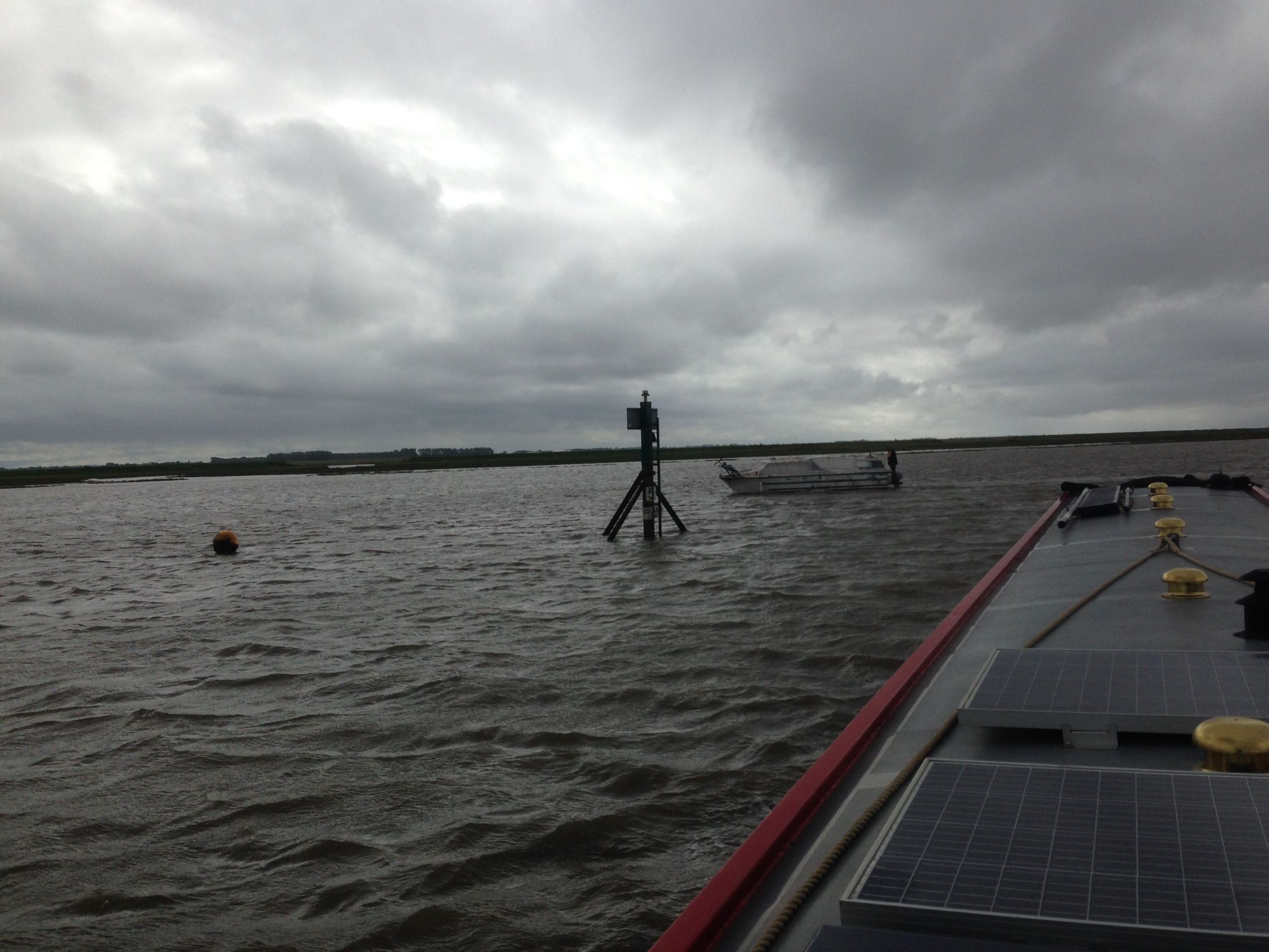

Don’t believe it does. There were single handers both ways we did it, including one coming down on a cruiser with a scaffold plank across the stern that the guy stood on and worked the outboard from it’s attached “tiller”.  As I said worrying about the type of Beta engine pales into insignificance compare to the stuff people do the Ribble link with, it was a eye opener for me.
edited to add, her is  a picture going round Ashland Lamp with the cruiser in front of us, guy stood on the stern, rather him than me
Edited by john6767
