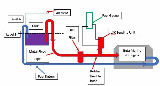

As a final comment on this thread. I've received a reply from the manufacturer and they have said that it will not work with a syphon. I also thought about the comments made in relation to the BSS. I originally only considered these in relation to the plastic T-piece sold with the kit, I have since looked a bit more closely at the actual sensor/sending unit and am not convinced that this is fire resistant and would therefore be a BSS fail. So back to the good old dip-stick.
Thanks to both Tony & JonestheNuke, when I said there wasn't a 'clear opinion' I meant that at that time arguments had been made to support the level being read at both A & B. Both of your explanations however have helped clarify the issue to my 'lay' mind, to the extent that I will probably buy one. Also as stated above I hadn't considered whether the engine running may make a difference, but thinking about it the gauge I use for my fresh water tank (Which is an MSC one and is placed between the tank and the pump, but no syphon is involved) also uses hydrostatic pressure and drops to zero when a tap is turned on and the pump is running. Unfortunately, no. Thanks again to everyone for the comments and the advice, all very helpful.
Hi, Everyone Thank you for the responses, but unfortunately there is not a clear opinion whether the gauge measures at level A or B so I'm not much further forward. For Ex-Brummie the manufacturers website https://www.lskelectronics.com/fuelgaugepro1 refers to it as a hydrostatic measuring device. For those who mentioned the BSS requirements although it is sold with a plastic T-piece, if I purchase it I would of course use a metal T-piece. For those who mentioned the inaccuracy whilst the engine was running, thank you that hadn't occurred to me, but as I measure now (with the stick) when the engine is not running there would be no difference (apart from dragging the stick out from the engine bay, unlocking the fuel cap, inserting the stick, wiping the stick clean and then putting the stick away). The kit can be purchased in the UK https://www.sip-scootershop.com/en/product/fuel-gauge-lsk-fuelgaugepro1_15892000 (and as as Ex-Brummie says it is marketed for a motor bike or scooter where the take off is at the base of the tank), but at £140+ I'm reluctant to buy it unless I'm sure it will measure accurately the contents of the tank and not be affected by the height of the syphon pipe. I have written to the manufacturer about the issue, but so far I've not received a reply. Thanks again for the replies.
Other than a wooden dip stick I don't have fuel gauge for my boat. I'm reluctant to fit one retrospectively because I don't want to drill a hole in the fuel tank. I recently came across a fuel gauge that measures the height of the fuel hydrostatically and is fitted into the fuel pipe (See diagram below). I don't know much about hydrostatics, but I understand that the pressure at the bottom of the fuel tank relates to the height of the fuel above it and if you know the measurements of the tank then the amount of fuel in the tank can be calculated. My fuel pipe, like most others, exits the fuel tank at a higher level than the actual fuel level and because the engine is lower than the tank a syphon effect causes the fuel to flow to the engine. My knowledge of syphons is also limited, but I understand that for a syphon to work the pressure at the top of the tube is zero. What I'm not sure about is whether the gauge/sender unit will measure the pressure of the fuel at level A or at the height of Level B in the diagram below. I'm hoping there is someone here who knows about both hydrostatic measurement and the effect a syphon might have on the measurement.
