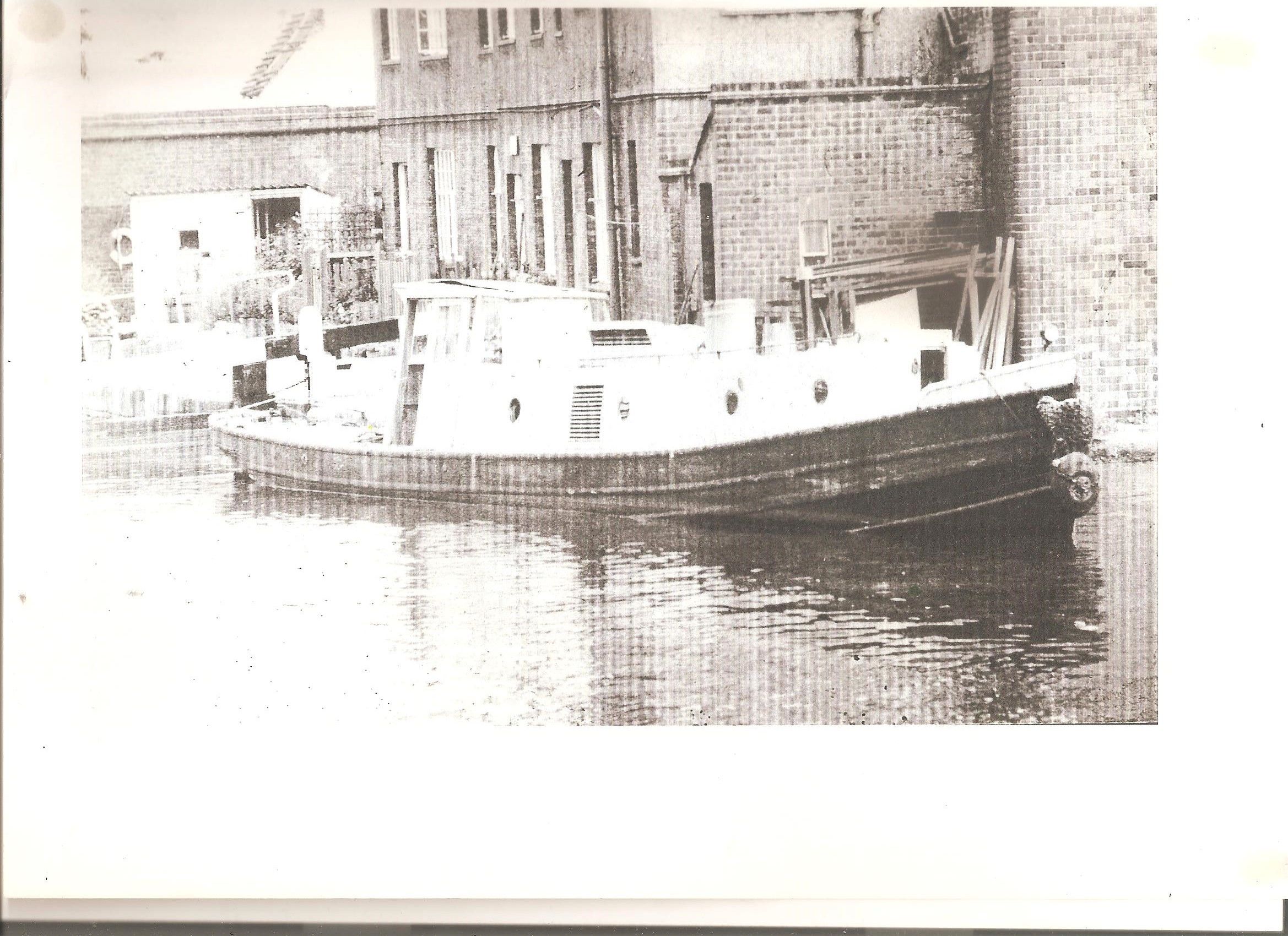

Not the photograph you are looking for but this is from the Alan Elyard Brown collection, and most likely at Cowley Peachey 28 July 1967 :captain:
618105252_AEB19682(possiblyCowleyPeachey28July1967)(WHITEHEATHER).JPG.f7f4c3052690a75ae40d885470ab576c.JPG

Thanks Pete. I have never seen this picture before and at 1967 it probably predates the one below which shows the boat, above Camden lock I think, and you can just make out the BW wave logo on the side. It also shows the very large cut out ventilator on the port side. I thought the FR3M was a water cooled engine so I am not sure if there was another engine fitted between the Robey and the FR3. The first photo I posted shows the boat with what looks like the original engine and funnel removed and judging by the waterline quite empty but still with the Marylebone council shed wheelhouse that was fitted to both White Heather and Tyburn (ex W and B Birmigham).  Maybe it was during a BTW refit. When I first can about the boat in the 1970's it was derilict at the top of Norwood locks when it had been disposed of by BW and without engine.
