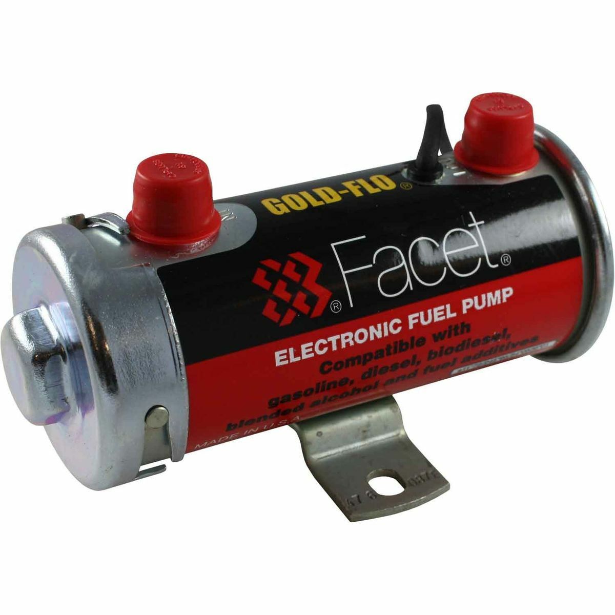

I agree with 1 the spring pressure is constant, but what pressure is the electric pump going to be?
The diaphragm will be under constant pressure, they are not designed for this.
Leaking diaphragms are very common on old AC pumps, that's why they sell repair kits, the valves are more reliable.

I fitted an extra Delphi fuel filter / water seperator between the tank and mechanical AC lift pump on my Coventry Victor. The mechanical pump struggled to draw the fuel through and the engine got slower over a long period. So i fitted a facet electric fuel pump at the tank outlet to assist the mechanical pump and have had no problems in maybe five years. Is handy in another way because the noise of the pump reminds me to switch the ignition off when i have stopped the engine.

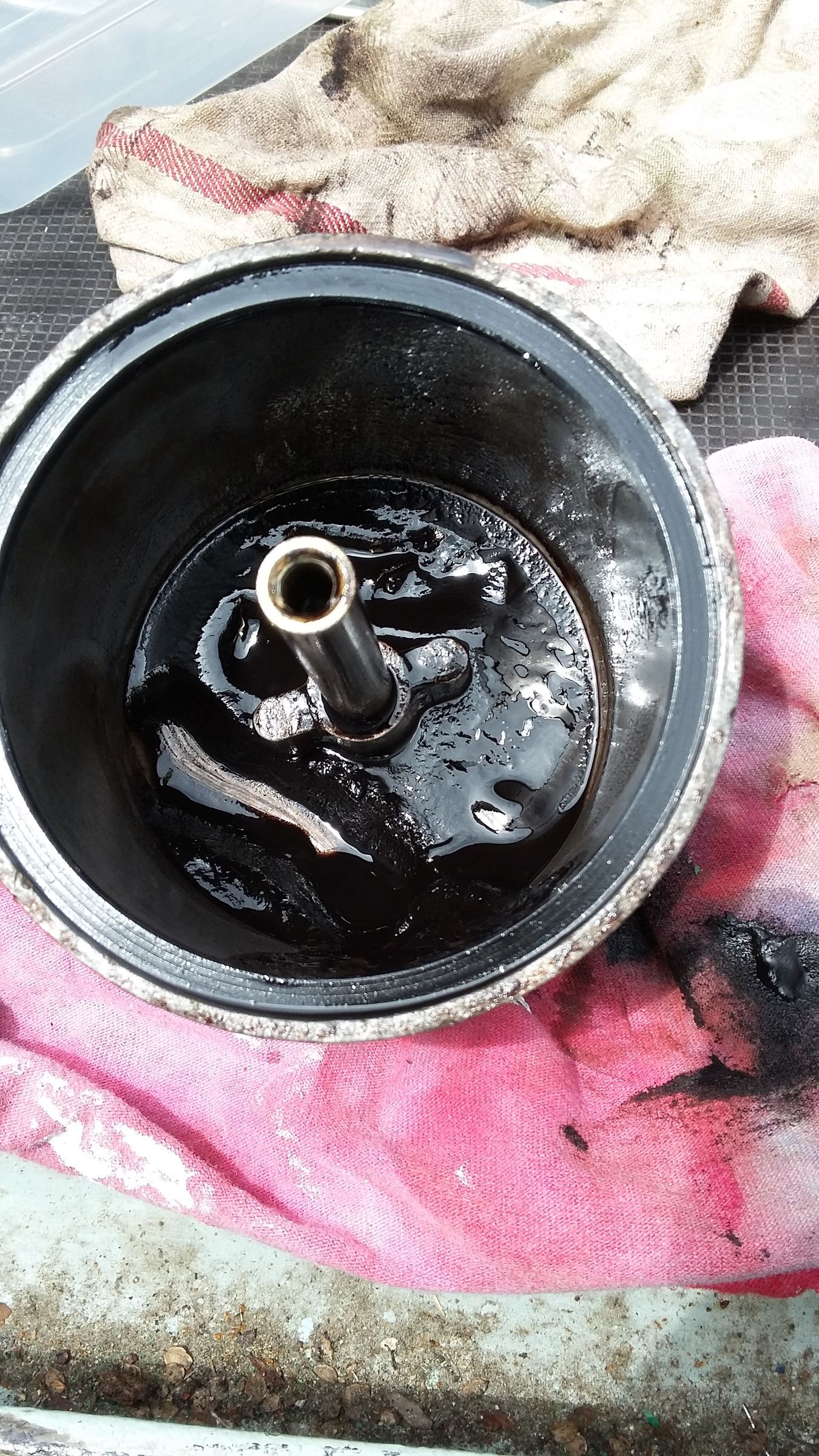

Well it looks like this is my problem i suspect this is diesel bug? anyway i have cleared the tank out cleaned the water trap and lines put fresh fuel in and added diesel bug preventing additive just waiting for my new filters and extra filter/trap to arrive i will also be fitting an elec fuel pump hopefully this will sort it ?
Just remember to in some way drain any water that has collected in the bottom of the tank at least yearly. The bug likes living at the interface between said water and the fuel.

All well that ends well i finally got my BMC running today and must say it sounds better than it ever did must have been all the crud build up over time restricting things or something anyway now with fresh fuel/filters and a good clean out all is running beautifully twas a biatch to bleed though ;)

1. Why will that be? The mechanical pump uses a spring to deliver fuel so unless the electric pump has a higher pressure the mechanical pump can not deliver any more. The electric fuel pump pressure will just hold the diaphragm down so the mechanical pump free wheels. Much like they do when connected to a carburettor with a  closed float needle valve.
I agree with 2 but think you are overstating the danger. Nothing wrong with the OP fitting them in series to see if it cures the problem.

I've fitted inline fuel feed pumps before to avoid the need to use the LP wobble lever, BUT I don't like the type that needs to be left switched on to allow the fuel to pass through.
Has anyone actually fitted one, or know of a good explanation about how the ASAP Thornycroft pump can be used etc ?? I must admit to liking that pump because it looks good!

I have an old Beta 35, the mechanical fuel pump was ditched years ago and an electric one fitted.
Dead simple to connect the pipework and have a feed run from the ignition switch.
When changing fuel filters the pump makes life a lot easier bleeding the system.

Yep, I think it is a real good idea to fit a good quality 12v fuel feed pump, like the ASAP series that are not supposed to cause a significant restriction to normal fuel flow. BUT, and yes that was a capital BUT, the old belt and braces approach to BS, (Boating Safety), says that a marine diesel should have both a mechanical lift pump, AND an electric one. If you fit a 12 or 24V fuel pump of the correct self priming, (1.5m only), type, and only leave it switched on during the initial start or fuel filter related servicing, there is no risk of it dumping the entire contents of the fuel tank in the bilges when one of the fuel hoses falls off, or splits apart, then your whole quality of life whilst fiddling around with your beloved donkeys fuel system, will improve in a big way. Sorry, bit of a long sentence that one.

I have never sucked water and crud out of the tank all the filters were replaced last year and the sediment trap was also cleaned out i was that sure it was out of fuel i put 50 ltrs in the other day now i wish i hadn't listening to your advice as i now also suspect crud/water may be the culprit :blush:
I always thought my tank was pristine until Tooleys sucked out about 3 litres of gunge from my tanks.
Me too until despite using Fuelset and draining own each winter I pulled about 12 litres of emulsified gunge out of mine. It settled to about 8 litres of fairly clean water, the rest went for bonfire starting.
