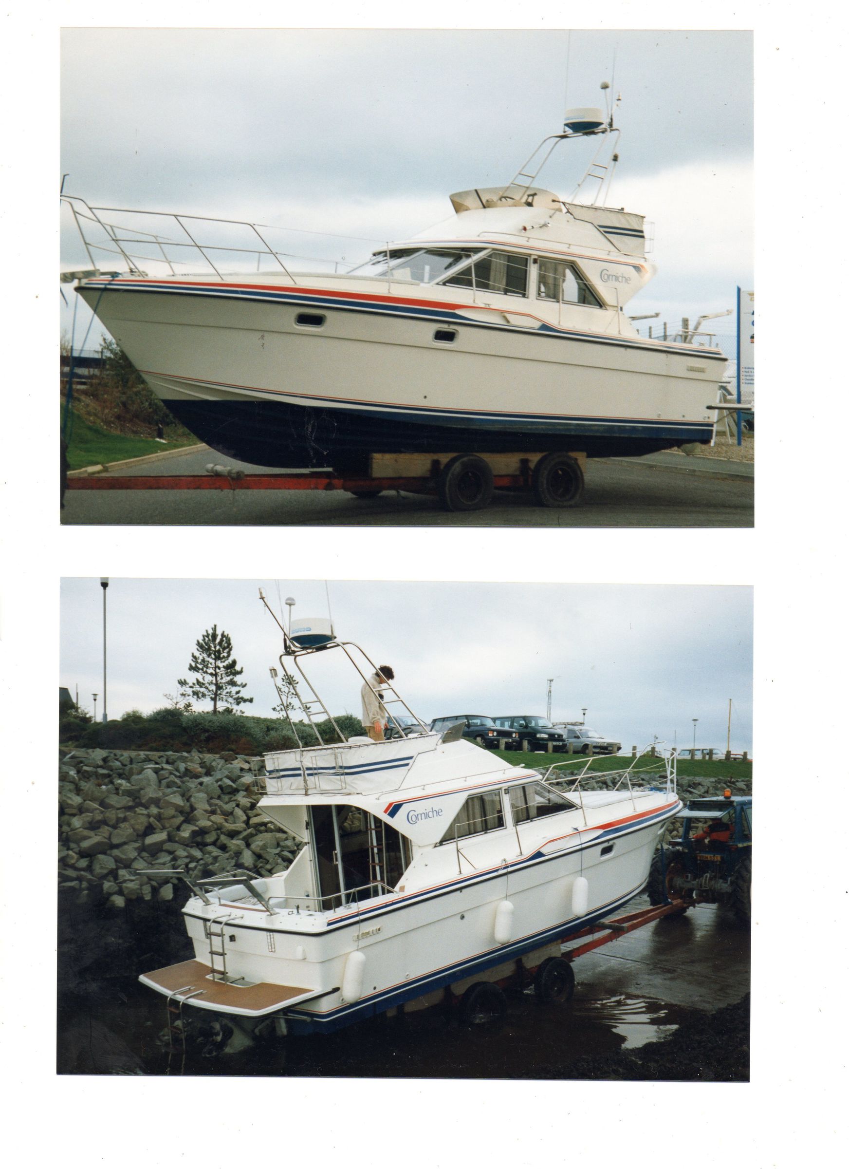

If a boat is an indivisible load, and the trailer is a 'boat trailer' and the towing vehicle and trailer combined is less than 26m in length, and the towing vehicle weighs less than 3.5 tonnes, it could easily be 'launched' off its trailer by using a slipway.
Here is my 33 footer weighing in at 8 tonnes being launched off its trailer.
A 'road-legal' 30 footer would be no problem.
blimey - those tyres look mighty flat !!
