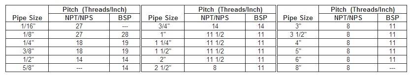

  4. Are you sure that the engine is taped at 1/8" BSP-Parallel?
  5. Any use? Thread form and angles vary as already said. The other common instance of “incompatibility” are parallel plastic threads on domestic water pumps labeled 1/2” NPT; which happily accept 1/2” brass BSP fittings.
