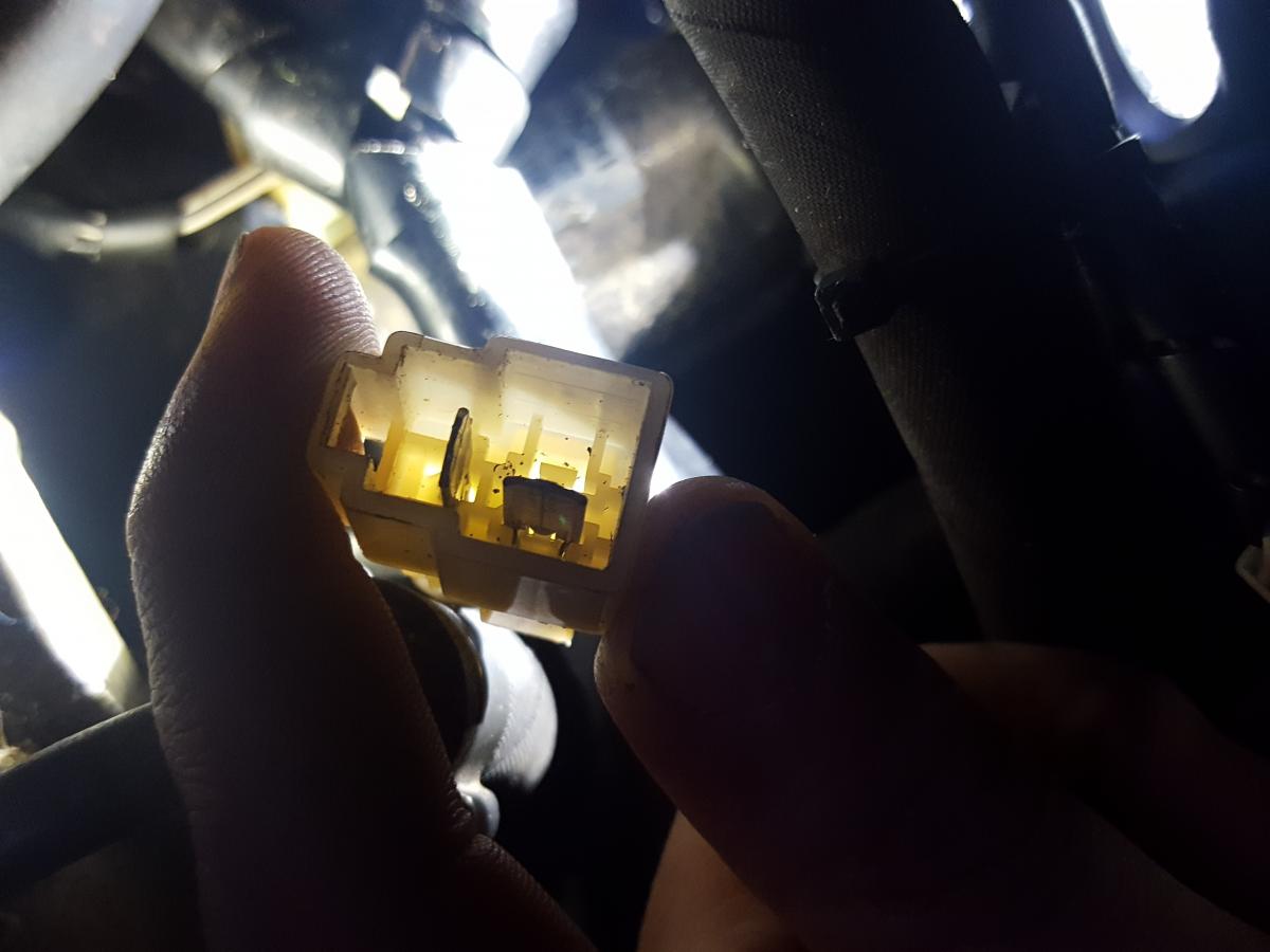

No, that's got 3 wires, the picture has black & red at the back of the unit & red & white at the multiplug, its the at the pictures taken.

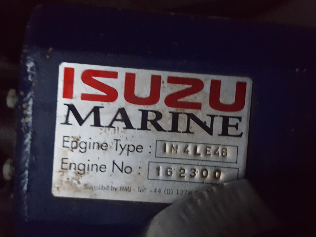

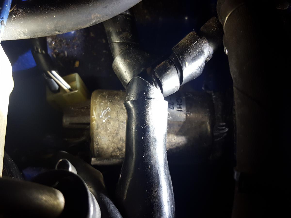

Hi Steve, That would be great ! does that mean I could simple plug into my existing connection ? I have taken some photos of mine, I tried to remove it today but it seems very stuck it even seems to have been siliconed in place.
Look forward to hearing your comments on how I could go about replacing this one, the simpler solution the better tongue.png
Sorry for the delay, printer/scanner failed.
Just collected a new one.
Thanks for the pictures; I'll wonder down to the local hire base for a better look at some Isuzu engines, just to be sure of what I'm talking about?. It's just down the road.

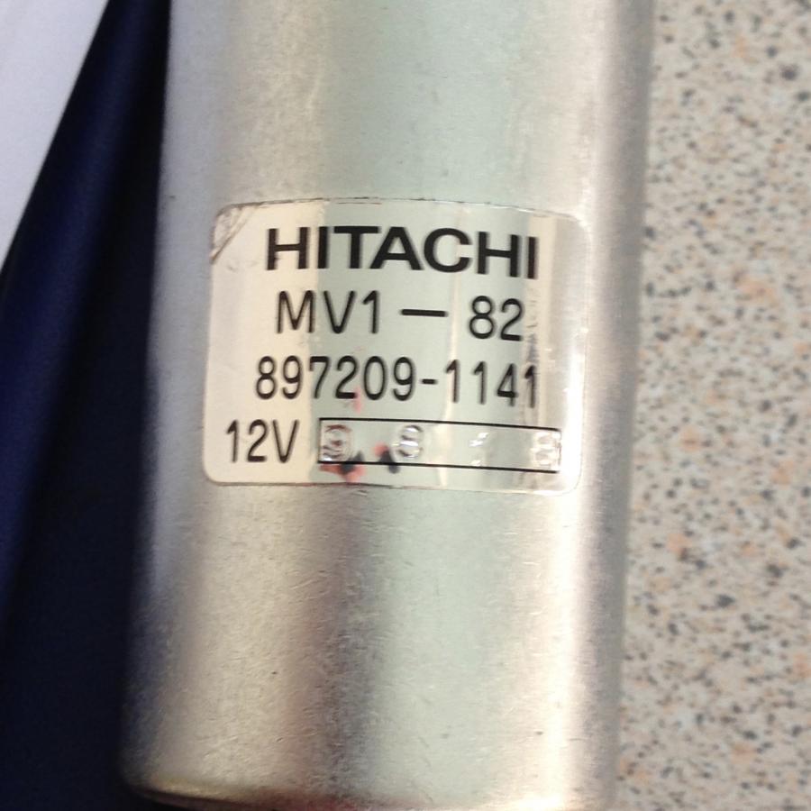

Don't order anything just yet; I'll be having a conversation with someone on Monday re the original part.
The current part number for the two wire version is: Hitachi MV1-77 897209-1141
They are available from Engines Plus through their dealer network, which supports the Isuzu marine product.
I was given a price of about £208 by the local dealership.
So they are available, with a price that seems about right for something "almost unique".
It seems that these solenoids just screw in without need for setting (unlike the similar looking Mitsubishi item). Sealing compound/mastic seems to be the order of the day to stop the oil leaking past the threads.
