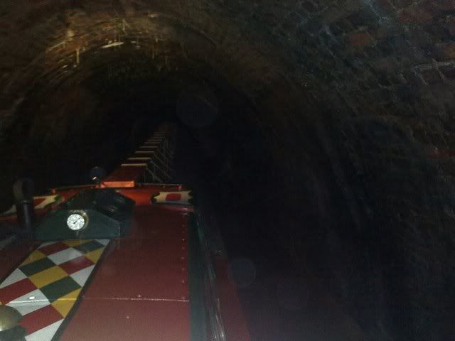

The nice thing about Victoria (now I have a headlight) is that I can have both the hold light (a bright spot light on top of the pigeon box), and headlight on giving full illumination of both boat and tunnel!
Not a very good picture from my phone camera, but this inside view of Harecastle gives some idea:
Only downside is that the switch for the hold light is still in the engine room so was fun before I got the other light. You would often see me leave the 'ellum while I ran inside to switch the light just before or after a tunnel!
