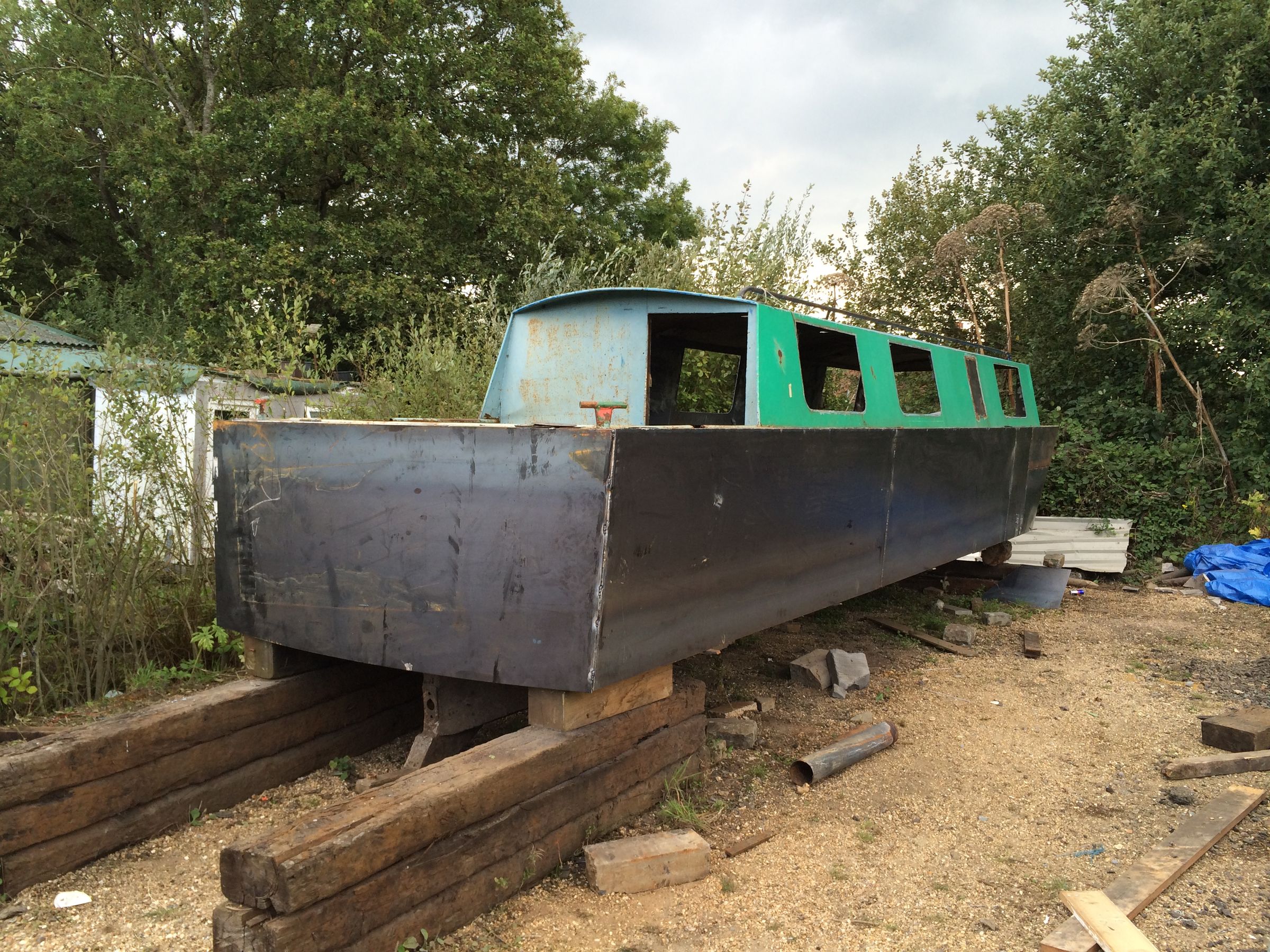

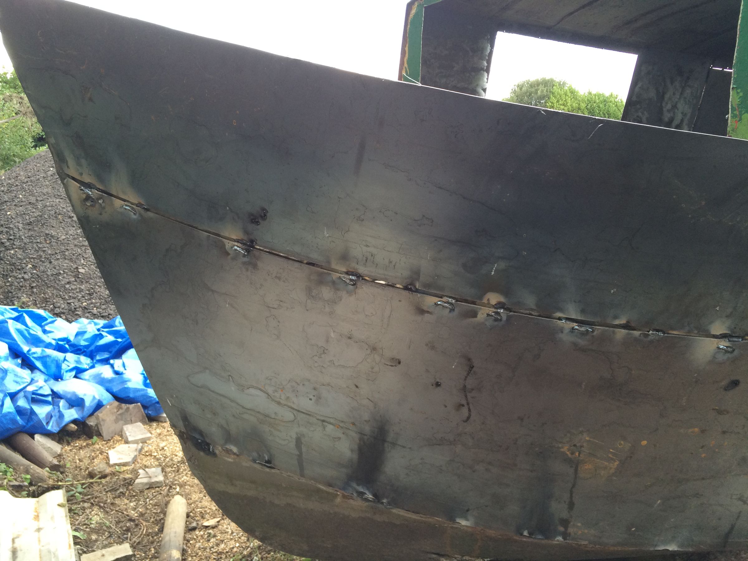

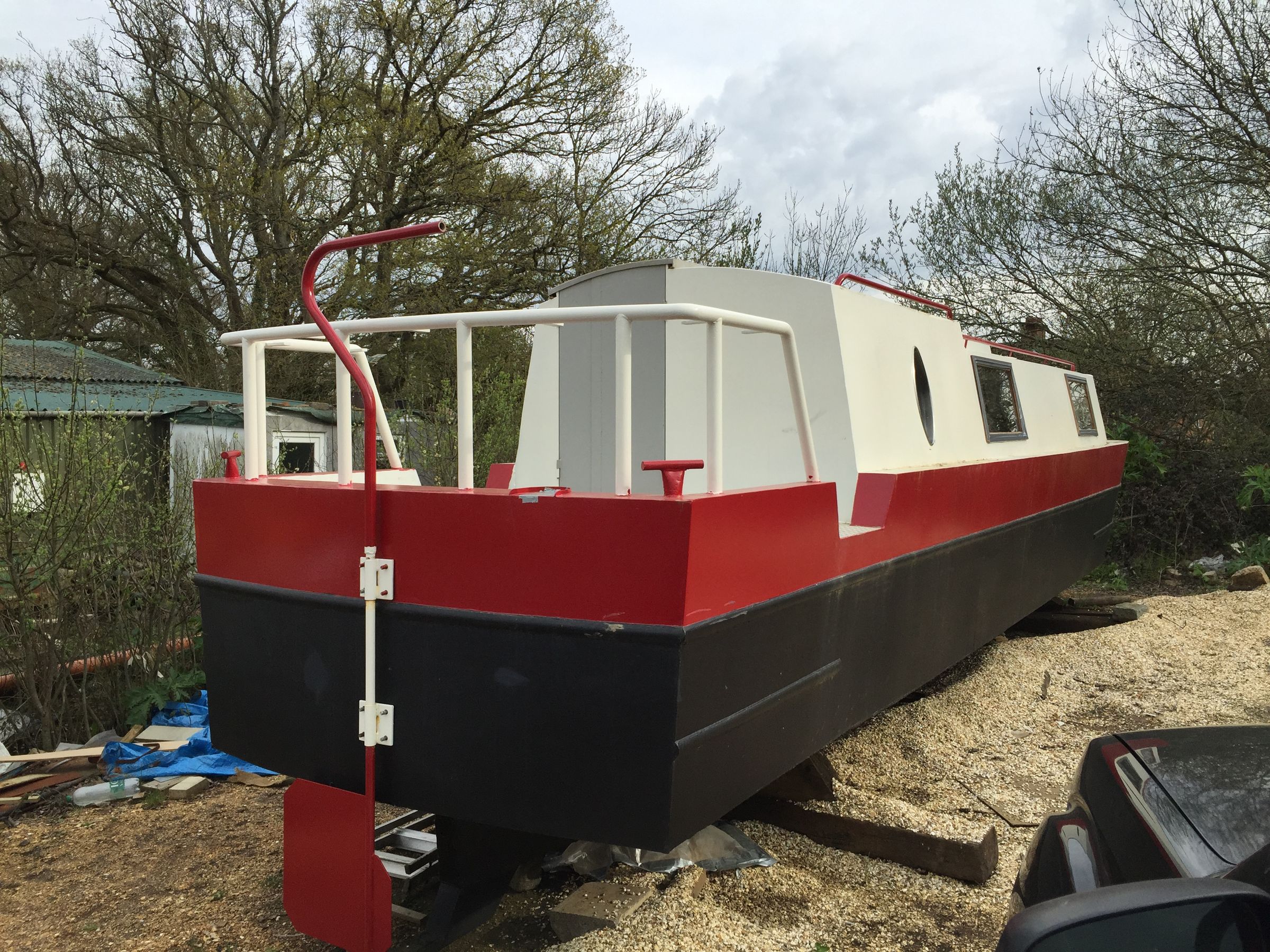

Springer Posted January 3, 2019 Report Posted January 3, 2019 Hi I replated my old springer with 6mm on the hull (shallow v) and 4mm up to the rubbing strake, blooming hard work. well done Martin keep up the good work, i shan't be doing another!!!! we need good fabricators/welders like yourself. Couple of photos in progression and a near complete new springer. Springer NB Alakefic 1
Martin Kedian Posted January 3, 2019 Author Report Posted January 3, 2019 Well done looking good thank you for your kind comments at last someone who understands what is involved in over plating
Springer Posted January 3, 2019 Report Posted January 3, 2019 Hi Martin I cant take all the credit as i was led by the hand by a very good experienced welder, he'd never attempted a boat before but helped me through brilliantly. Also some welding takes on its own artistic appearance, can anybody see anything more than a weld in the Picture? My wife could and turned the photo into a picture canvas. Springer
