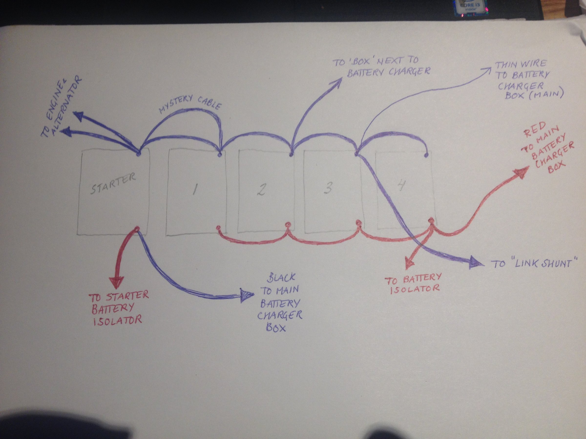

I am currently on the 12v group on FB about this problem but I thought I'd also ask here.
To make a long story short my batteries are hardly charging from the engine and depleting overnight, placing me in a vicious cycle of having to run the engine 6hrs+ every day just to keep them from dying (they're new). I haven't been able to afford a monitor yet, but my multi-meter shows me bringing the starter up to 12.50 and leisures at 12.20, but then they go below 11.7 overnight despite me having the fridge switched off and only using lights/water-pump.
Now, yesterday I remembered that I have a 12v socket reader, so using that I noticed that the charge was 14.1 while running the engine indicating the alternator input was fine (yes?). However, once I switched the engine off the readings were all over the place and would not settle (i.e. jumping between 11.5-14.1). Someone has suggested that my wiring is wrong, and I wonder if a jumpy reading like this would be a confirmation of that?
Adding a pic of my current wiring.

It seems as if there may be more than one issue here.
The two most likely causes of a fluctuating reading are either volt drop due to loads varying (as per chewbacka) or a poor connection.
The 6 hour charge time may be sensible depending upon the state of your batteries.  Without being able to monitor the charge current you are not able to tell how far you have got with charging. If you dont get a eeasonable charge daily then the whole situation will rapidly deteriorate.  You need that monitor!!!
Also it may be that we need more info. Is the "charger box" some sort of split charge from a single alternator, or something else?

I wasn't varying the load though (same lights on, no water pump going) and the reading is jumping pretty manically nonstop the moment I switch off the engine. I've cleaned and checked all the connections on the batteries but I'd be a little lost if there's a connection issue elsewhere.
The charger box is next to my Sterling battery charger and looks very much as part of the Sterling set up although I have no clue what it does.
I think I may need an electrician to come at this point as the situation is indeed deteriorating - does anyone have a recommendation for west London electrician?

On your diagram you say ‘link shunt’ is this just a big negative connection bar or is it a proper current measuring shunt?  If it’s a ‘real’ shunt then you probably have a current meter.  That would help understand what is going on.  If you are not sure what a current measuring shunt looks like it looks like this
https://www.ebay.co.uk/itm/DC-Current-Shunt-FOR-20A-50A-100A-200A-500A-Digital-LED-Voltmeter-Ammeter-Panel/171906336574?hash=item28066a873e:m:mcV1cAcz-mC1SjelrssYCWg
It might - I'm heading back to the boat soon to look (charging laptop currently in cafe). Not sure what you mean by current meter though? (you mean I can place the multi meter on it for a reading?)
