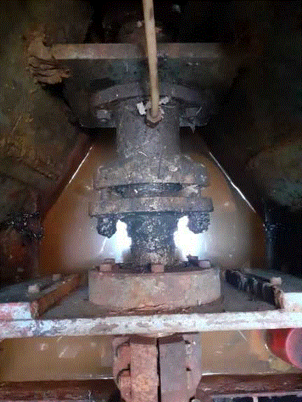

  5. Hi everyone. I thought I should just add some real life experience on the topic. I just had mine done in the water and after chit chatting/observing with the engineer the sum of his expertise is that in most cases you can repack while in the water - although he mentioned one rare type of set-up that leaks masses while you're doing the job (I unfortunately did not jot down the name) so I guess a good bilge pump and nerves may always be handy. Mine did not leak at all (see pic of mine to identify type) and was easily repacked while on the canal. He literally just wiped off all grease, unscrewed the nuts and slid it back to discover that I had the impressive amount of 0 packing left.... ? and then cut two pieces to size, hammered them flat and squeezed them in before tightening it all up again. Piece of cake, so I will do it myself next time. He used graphite, btw and he is an engineer with very very solid reputation on the Grand Union, although he didn't seem to feel there was a massive difference which you use. I hope this assists someone in the future. ? Also, found a good link for the dizzying amounts of stern gland set-ups out there.... if anyone fancies the extracurricular activity or to identify their own. http://coxeng.co.uk/stern-gear/stern-glands/
