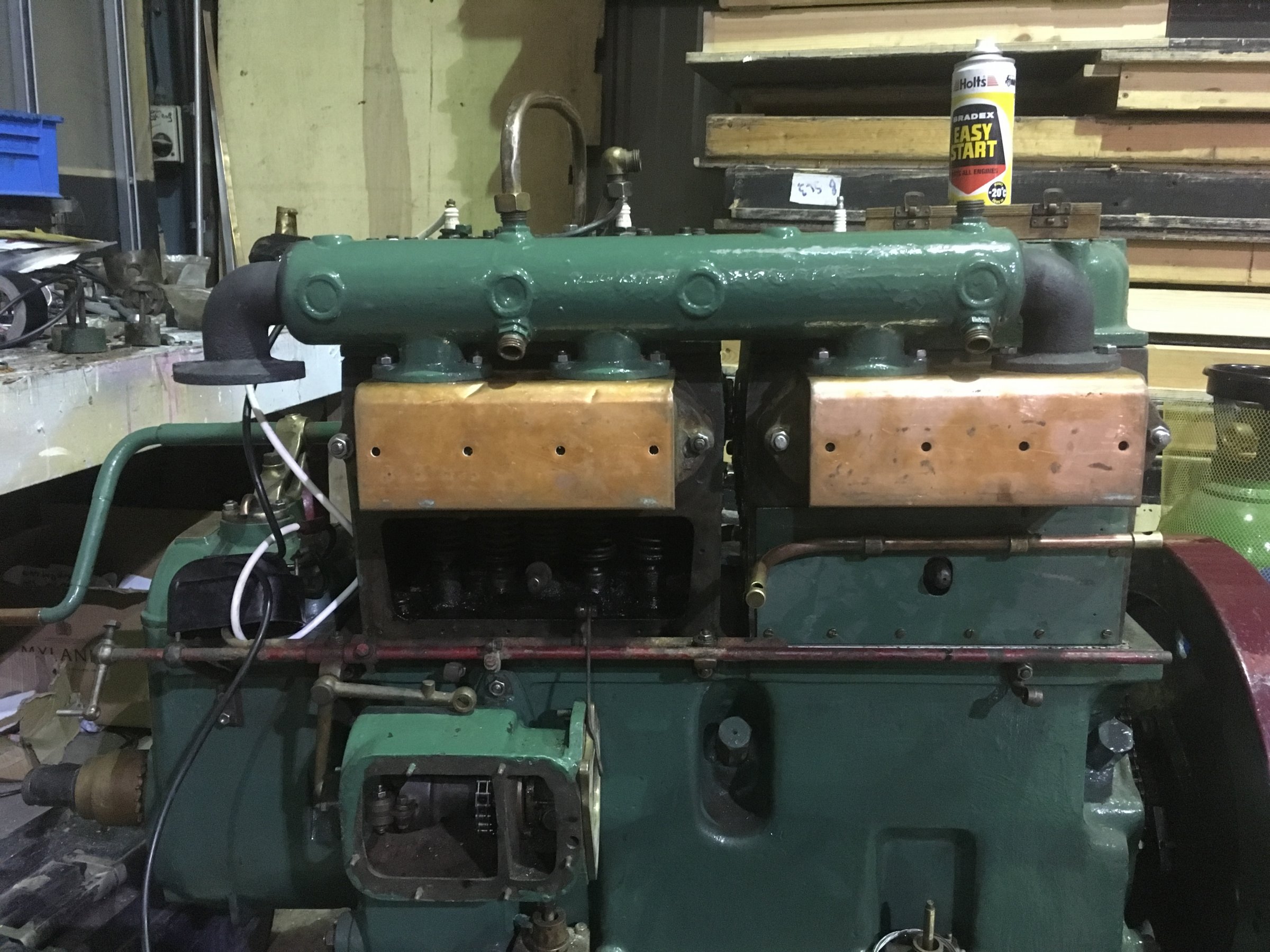

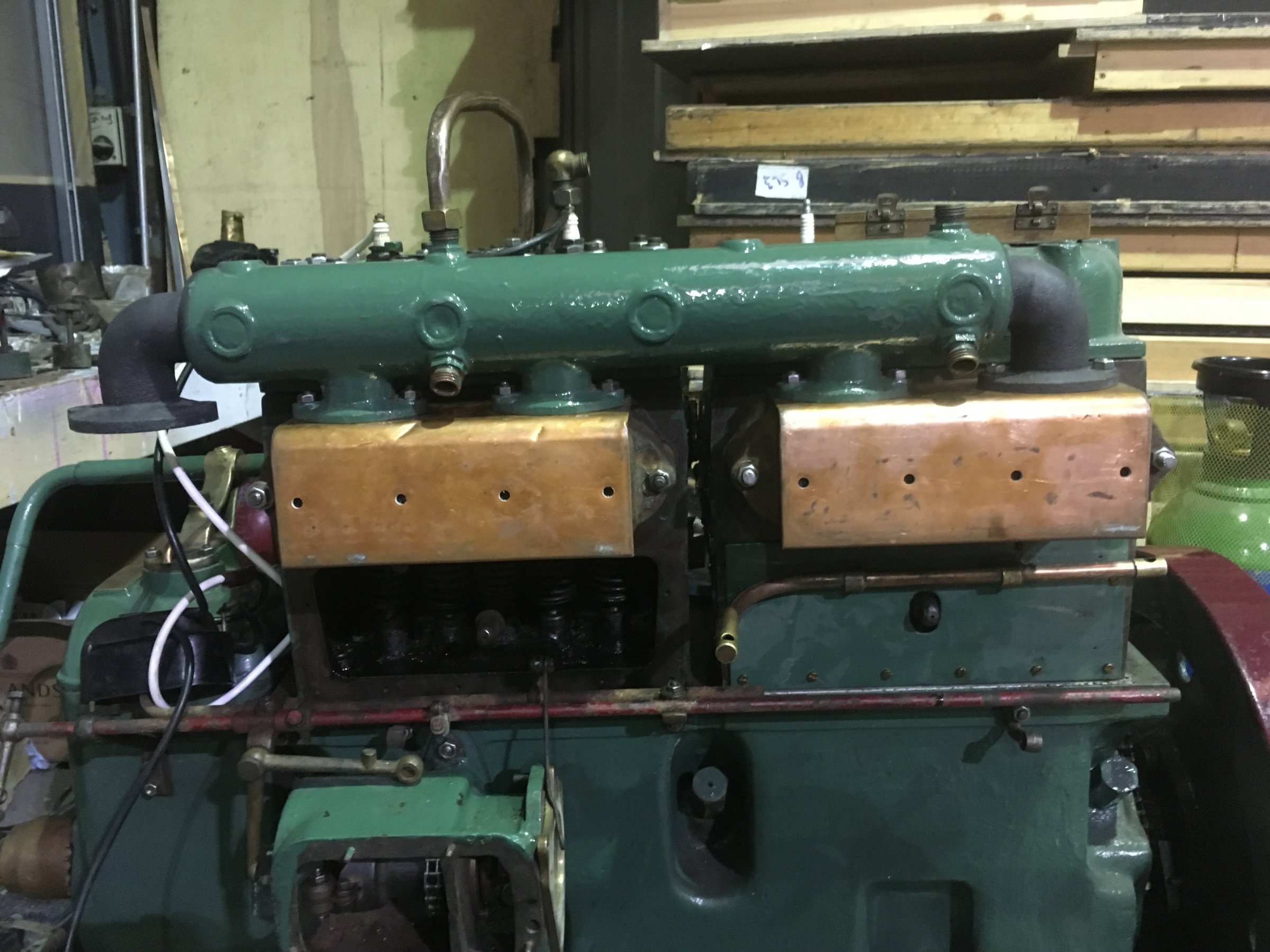

tom_c Posted February 2, 2018 Author Report Share Posted February 2, 2018 I had a bit of time this week, new front engine feet are on and it's starting to look more like an engine again next step, vaporisers and carburettors, hopefully next week. Tom Link to comment Share on other sites More sharing options...

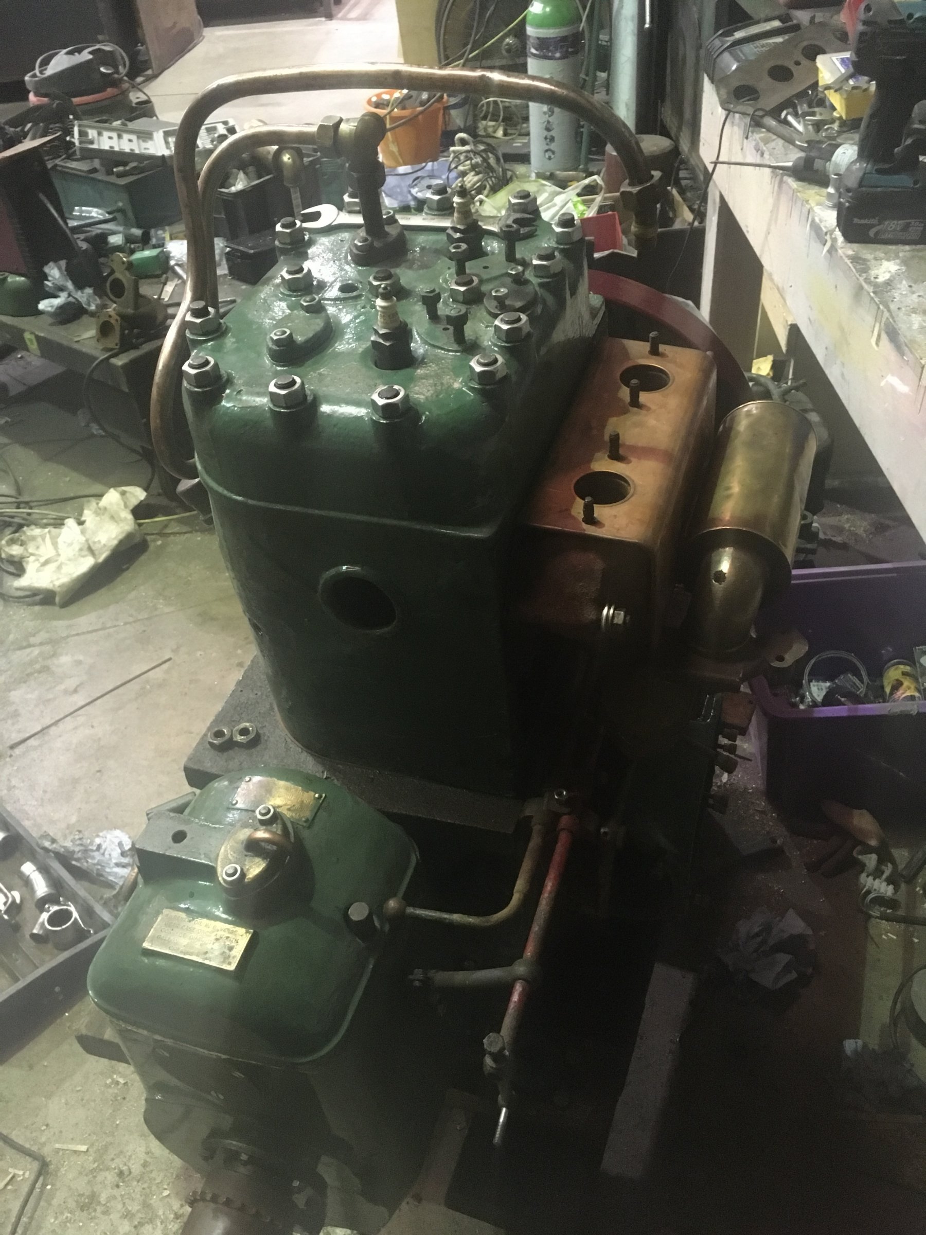

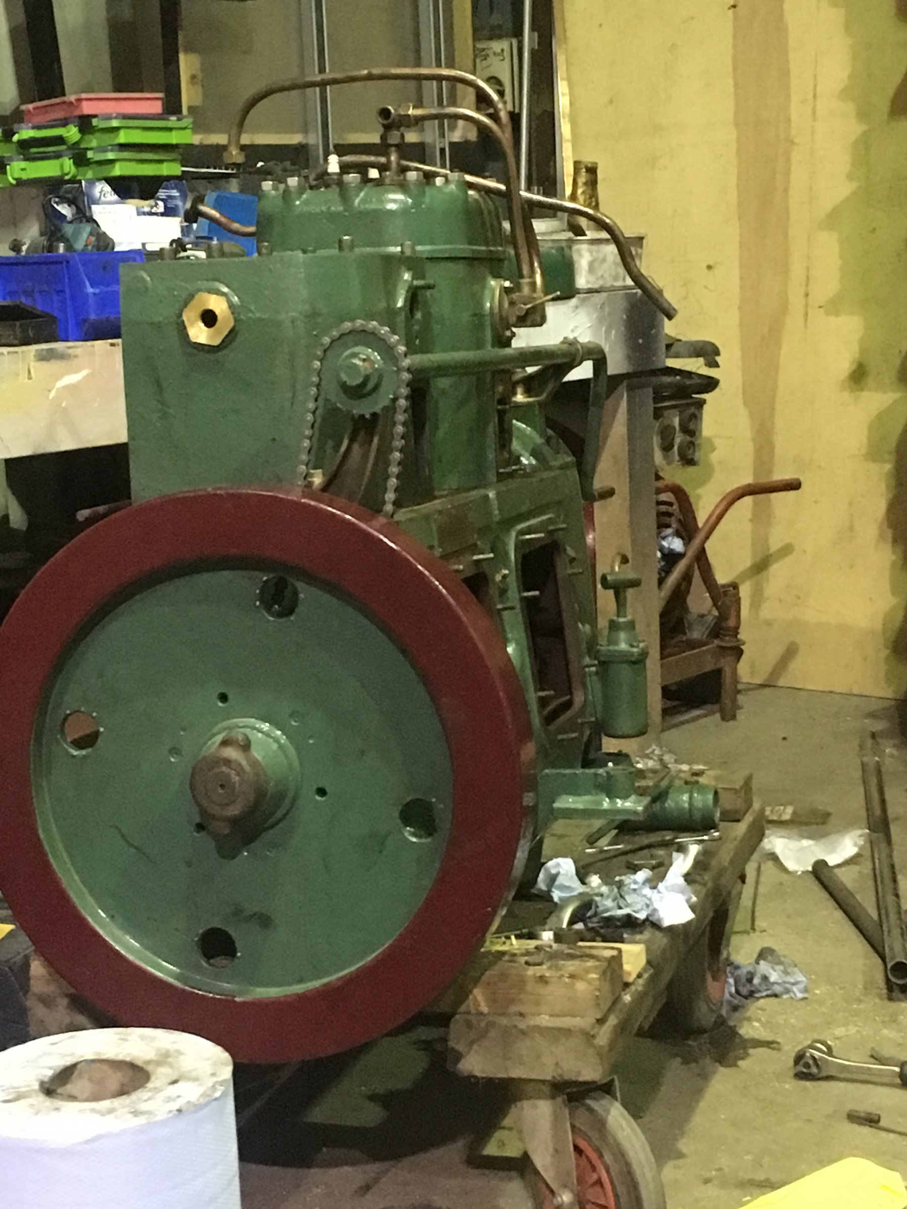

tom_c Posted March 28, 2018 Author Report Share Posted March 28, 2018 More progress today, hopefully lifting it into the boat over the weekend! 1 Link to comment Share on other sites More sharing options...
NB Esk Posted March 28, 2018 Report Share Posted March 28, 2018 1 hour ago, tom_c said: More progress today, hopefully lifting it into the boat over the weekend! Some really nice work there... Link to comment Share on other sites More sharing options...
stagedamager Posted March 28, 2018 Report Share Posted March 28, 2018 cracking work...... if anyone needed a major engine rebuild..... I know where I would be going based on this.... Link to comment Share on other sites More sharing options...

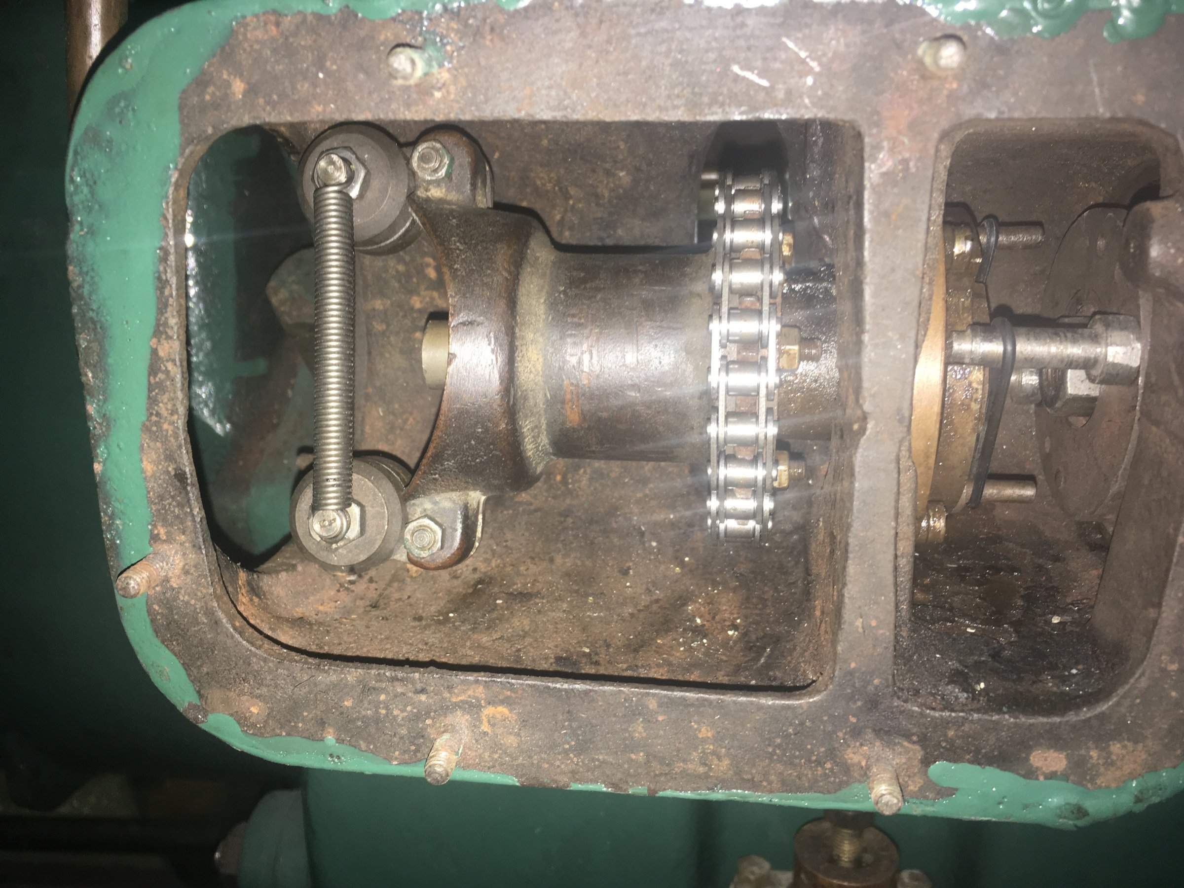

BEngo Posted March 29, 2018 Report Share Posted March 29, 2018 Are those fixed links on the impulse drive, or are they just there for assembly? N Link to comment Share on other sites More sharing options...
tom_c Posted March 29, 2018 Author Report Share Posted March 29, 2018 They are rubber O rings as I have left the correct springs on the boat. They are working for testing though Tom Link to comment Share on other sites More sharing options...
