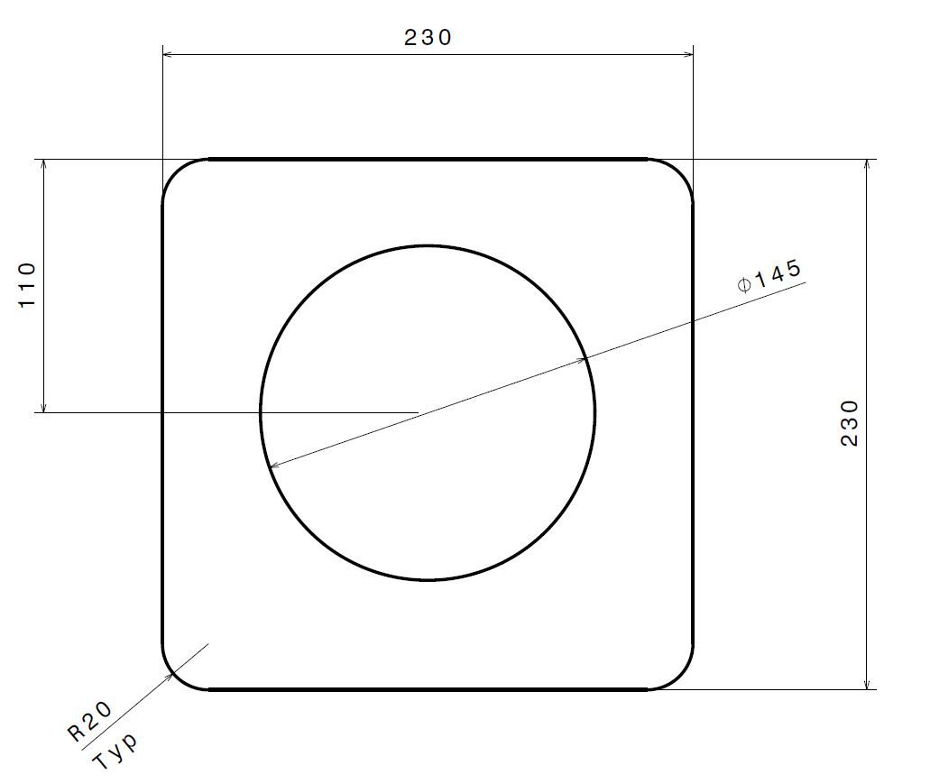

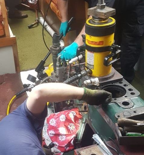

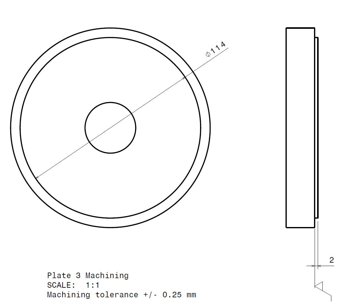

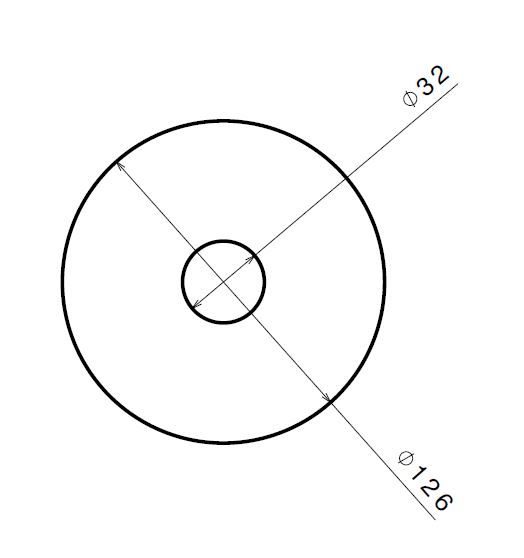

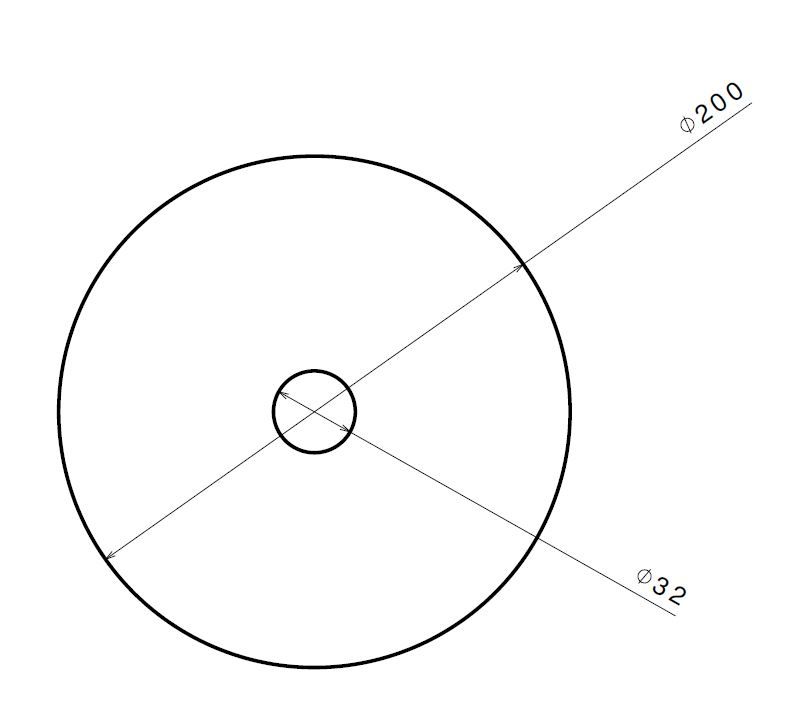

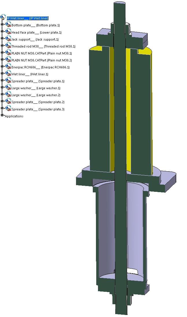

tommylad Posted September 19, 2019 Report Posted September 19, 2019 (edited) Just thought I'd share my experiences on pulling my JP liners which I successfully did yesterday! Many thanks to all on this forum who's advice was a great help! I had the following plates laser profiled from 20 mm steel plate, and machined a register on the one which would locate on the underneath of the liners (I didn't want it slipping) I was then extremely fortunate to be able to borrow a 60 tonne hollow jack which sat on top, using some M30 studding to tie it all together. I was quite nervous about putting this much force across an old casting, however it ended up being quite anti-climatic - both liners came out with only 6 tons of force, with no bangs or alarming noises - just drifted out smoothly. I'm going to create a new post offering the three plates for anyone to borrow if they wish to use them themselves. Edited September 19, 2019 by tommylad 2
