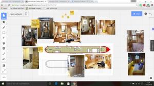

KirstieH Posted October 31, 2015 Author Report Posted October 31, 2015 (edited) Here is a quick plan of the boat and ideas for interior layout.....Obviously now with a Semi Trad stern (Not Trad) Edited October 31, 2015 by KirstieH
Alan de Enfield Posted October 31, 2015 Report Posted October 31, 2015 (edited) That looks very nice and practical, and, as you say fits into 58 feet. As part of my job in Marketing I was responsible for designing our Exhibition Stands - whilst on paper a table and chairs would 'fit' into a certain place the reality was that when someone sat on the chairs it immediately took up twice the space. Do try to simulate the space, try passing each other in a 2 feet wide corridor - I do not think that the space between your bedhead and front door is practical, there is only 1 foot between the bed and the corner cupboard. Edited October 31, 2015 by Alan de Enfield
Paul C Posted October 31, 2015 Report Posted October 31, 2015 Having looked in detail at the plans, all okay except for a detail at the front: you probably don't want the bedhead to be "floating" with nothing next to it, you could put a unit of some kind there, then have the front door offset to the side. The plans always put 2x little corner cabinets at the front because they're expecting a lounge and its a sensible place for a little corner cabinet.

KirstieH Posted October 31, 2015 Author Report Posted October 31, 2015 That looks very nice and practical, and, as you say fits into 58 feet. As part of my job in Marketing I was responsible for designing our Exhibition Stands - whilst on paper a table and chairs would 'fit' into a certain place the reality was that when someone sat on the chairs it immediately took up twice the space. Do try to simulate the space, try passing each other in a 2 feet wide corridor - I do not think that the space between your bedhead and front door is practical, there is only 1 foot between the bed and the corner cupboard. Will do. I know what you mean, just because it fits, doesn't mean its livable. I will conduct a boat "Mock up" Having both fitted out sail away and changed an existing fit out I quickly came to the realisation that the only perfect layout meant the boat would have to be larger than the canal locks would allow ! Fitting out from scratch mounting the bulkheads between cabin spaces in a way that would allow the layout to be changed later worked well, because with any boat the experience of using for a while exposes the fact that your initial design may not have been perfect. Ian. Yes I have heard this said. Also one person's "Perfect" is another's nightmare! We were thinking about flexible bulkheads actually. Good tip. Thanks Having looked in detail at the plans, all okay except for a detail at the front: you probably don't want the bedhead to be "floating" with nothing next to it, you could put a unit of some kind there, then have the front door offset to the side. The plans always put 2x little corner cabinets at the front because they're expecting a lounge and its a sensible place for a little corner cabinet. Good point. I will think about this for the 3D model version.Thanks 4). I assume you intend to keep working, whilst living on the boat. Do you have a suitable mooring in mind, or do you intend to keep on the move? Both will have an influence on the practicalities' of any design. Bod Yes we have to work. At 40 I have a long way off to any kind of retirement!! My husband will work from the boat and I will need to look for a teaching position. We were hoping for a Marina as a base but they can be tricky to find with internet provided (or at all!) Having looked in detail at the plans, all okay except for a detail at the front: you probably don't want the bedhead to be "floating" with nothing next to it, you could put a unit of some kind there, then have the front door offset to the side. The plans always put 2x little corner cabinets at the front because they're expecting a lounge and its a sensible place for a little corner cabinet. I think I would have the back of the wardrobe as the bed head (So switch bed round and also the wardrobe in the image and butt them together, as I would use the study area for dressing etc and would create an open plan feel with partition... You guys are brilliant. Thanks so much for all your help and advice. It is hard to do this alone
