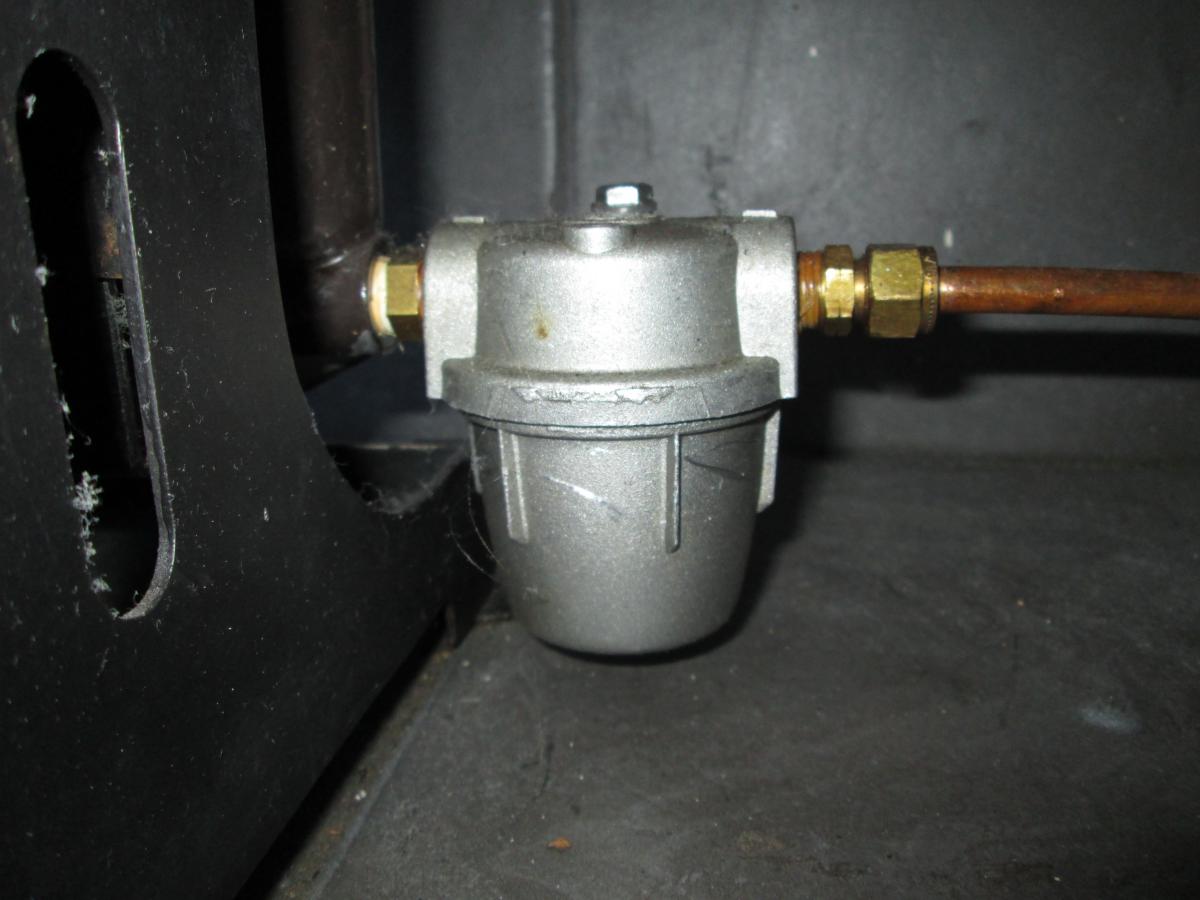

Having trouble at the moment. Checked the filter - nice and clean. Couldn't actually remove the pipe from the regulator to the stove, but cunningly cleaned it out by removing the nut closest to the stove and stuffing twisted lengths of kitchen towel down it. I have a feeling that water is coming through, as the stove doesn't get up to any kind of decent heat and every few moments, there's a crackling noise. I'm hoping that this (photo) is a water trap and that by undoing and cleaning it, this may solve the problem. But I'm not sure that it is, in fact, a water trap. Can anyone help please?
It looks like a fuel filter. I would certainly clean it out. The "crackling" you describe points to water in the diesel. Can you see wisps steam in the burner pot?
Do you have a separate diesel tank for the fire? If so I would drain it and fill with clean diesel.

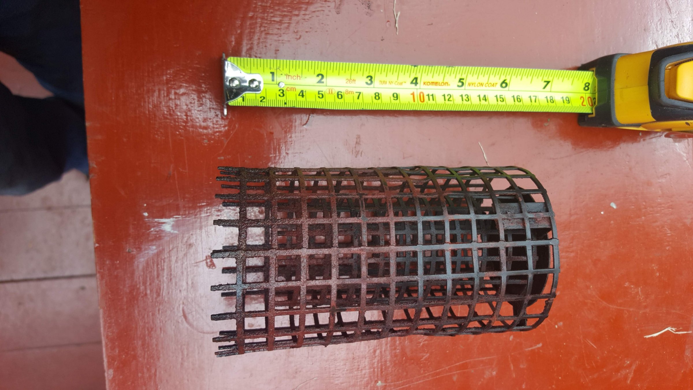

A question for the OP, I have started to strip down and service an oldish 62M that I have acquired.  I find that on the bottom of the burner pot on the inside it appears as if the metal has been coated with some material that I can only think of as been some kind of fire cement.  The surface looking  like that of a dried paste having been spread.  Similarly on the bottom on the outside of the burner pot base is another form of dried paste which is only around the middle of the domed base.  Was material like this ever used or has it been 'bodged' possibly?.  I would doubt that the unit has ever been stripped as the outside rivets looked original though inside on the inner case / burner pot the fixings were self tappers!
The burner rings are both one piece units with the top one being quite light weight and not heavy as implied in your post as being cast iron.  The lower ring seems to be stainless!
I also seem to have a fixed baffle that sheilds the flue exit from the flame of the burner pot.  This seems to not be the same as your heater, do you have such a baffle?
I don't have a catalyser though may make one!  Does yours extend above the top burner ring ?  Roughly how long is it please?

1.  I suspect that the caked on concrete like layer is just the normal gunge that's got baked on over the years.  It can be really difficult to shift.
2. I don't recognise the baffle you mention.  By the way, I've taken out the thin stainless steel ring because it got in the way of lighting the stove.
3.  Good luck with the DIY catalyser.  I had the same thought as you, but mine never worked very well so in the end I bought the proper (very expensive item).  The correct catalyser makes a huge difference.  The catalyser glows red and there is a quiet, blue flame.
